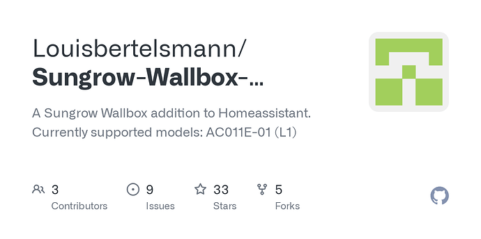

Ich habe glaube was Gutes gefunden:
In secrets.yaml habe ich nun folgendes drin stehen.
sungrow_modbus_host_ip: 192.168.178.55 # TODO update with the IP of your inverter. No default. Check your router.
sungrow_modbus_port: 502 # TODO update with the Modbus port of your inverter. Default is '502'
sungrow_modbus_slave: 1 #TODO update with the slave address of your inverter. Default is '1'
wallbox_modbus_host_ip: 192.168.178.56  # TODO update with the IP of your inverters WiNet-S dongle (not ModBus LAN port). No default. Check your router.
wallbox_modbus_port: 502 # TODO update with the Modbus port of your inverter WiNet-S dongle. Default is '502'
wallbox_modbus_slave: 3 #TODO update with the slave address of your wallbox. Default is '3'
