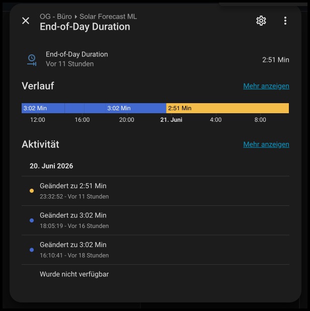

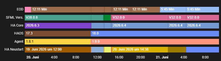

EOD hat keine 6 Minuten gedauert:
2026-06-20 23:35:28 - custom_components.solar_forecast_ml.ai.ai_drift_monitor - INFO - Drift bias correction updated: 1.0881 → 1.0974 (scope=global, rel_bias=-0.147)
2026-06-20 23:35:28 - custom_components.solar_forecast_ml.ai.ai_drift_monitor - INFO - Drift bias correction updated: 1.1160 → 1.1211 (scope=Gruppe 1, rel_bias=-0.176)
2026-06-20 23:35:28 - custom_components.solar_forecast_ml.ai.ai_drift_monitor - INFO - Drift bias correction updated: 1.0765 → 1.0864 (scope=Gruppe 2, rel_bias=-0.125)
2026-06-20 23:35:28 - custom_components.solar_forecast_ml.ai.ai_drift_monitor - INFO - Drift detection complete: 24 metrics saved, 2 events created
2026-06-20 23:35:28 - custom_components.solar_forecast_ml.production.production_scheduled_tasks - INFO - Drift detection completed for 2026-06-20: 24 metrics, 2 events, 3 scopes
2026-06-20 23:35:28 - custom_components.solar_forecast_ml.production.production_scheduled_tasks - INFO - Drift bias correction updated on coordinator: 1.0881 → 1.0974
2026-06-20 23:35:28 - custom_components.solar_forecast_ml.production.production_scheduled_tasks - INFO - EOD duration saved: 328.3s for 2026-06-20
2026-06-20 23:35:28 - custom_components.solar_forecast_ml.production.production_scheduled_tasks - INFO - End-of-day workflow completed (16/16 steps, 328.3s)
2026-06-20 23:35:28 - custom_components.solar_forecast_ml.sensors.sensor_system_status - DEBUG - Status updated: event=end_of_day_workflow, status=success, state=ok
EOD war bei mir auch unter 6 Minuten:
Welche HA-Version? schaut eher nach einem PI-HA /LAST Problem aus.. aber hat sich selbst geheilt
  • 23:30:31: LSTM Training startet mit 807 samples, 200 epochs.
  • 23:59:54: erst Epoch 90.
  • 00:00:29: Subprocess läuft in den 1800s-Timeout.
  • Danach startet SFML automatisch Fallback local training.
  • 00:24:08: lokales Training endet erfolgreich nach Early Stopping bei Epoch 70.
  • 00:24:15: EOD ist komplett erfolgreich.

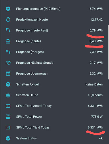

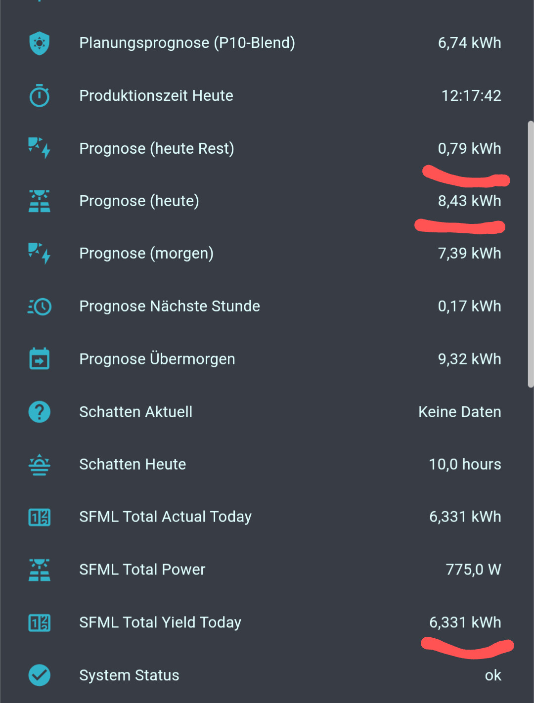

Wie wird der Rest heute berechnet?
Prognose heute - Yield Today = Rest heute?
Habe eine Differenz zur vollen Stunde +5 min festgestellt die ich mir nicht erklären kann.
Edit: Nochmal nachgedacht​:thinking:
Der Prognose Rest bezieht sich auf die prognostizierten Erträge vom Rest des Tages?

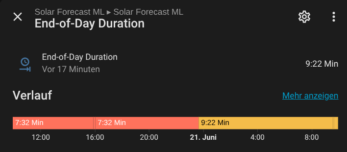

Morgen,
also dieses mal ist der EOD auf dem Pi durchgelaufen, 75 Epochen bei 1511s.

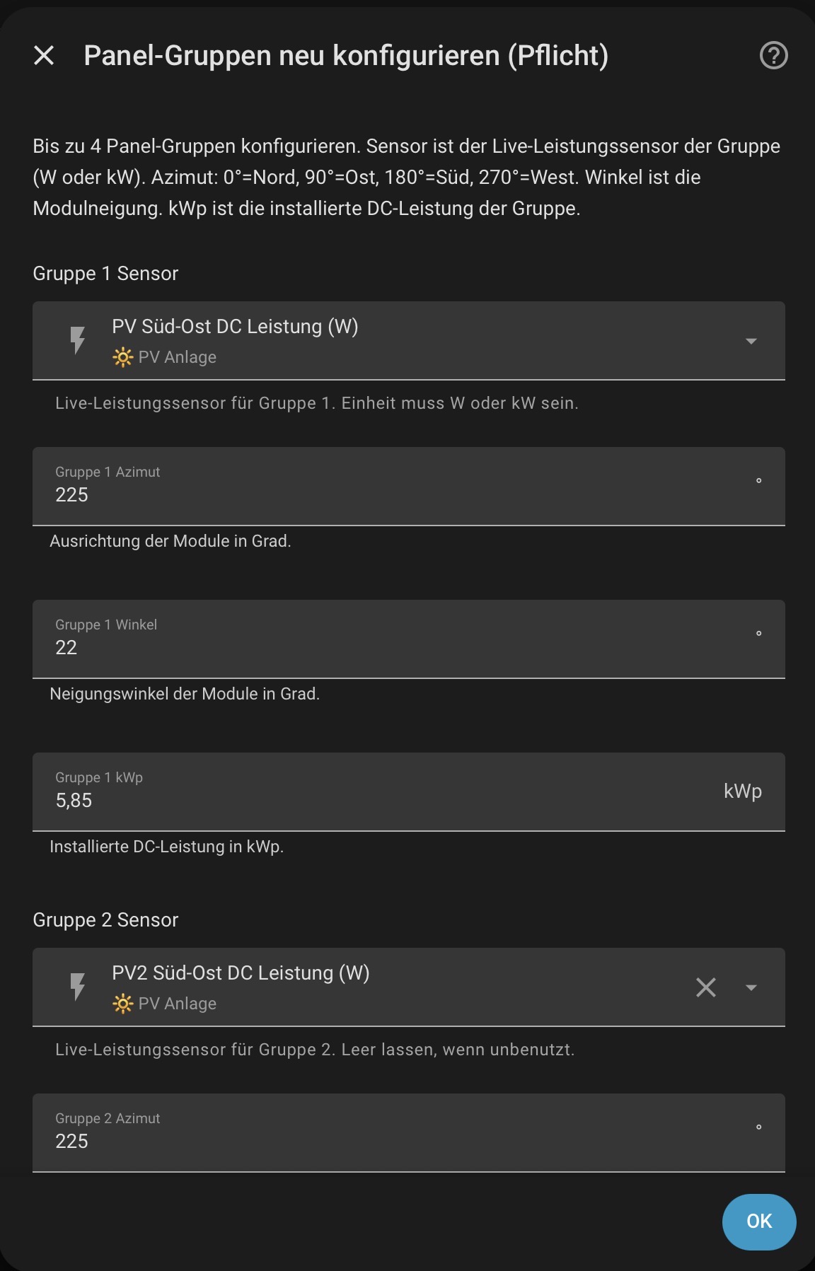

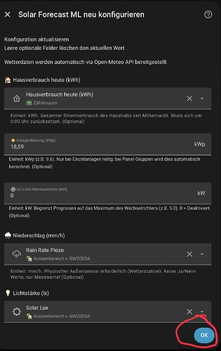

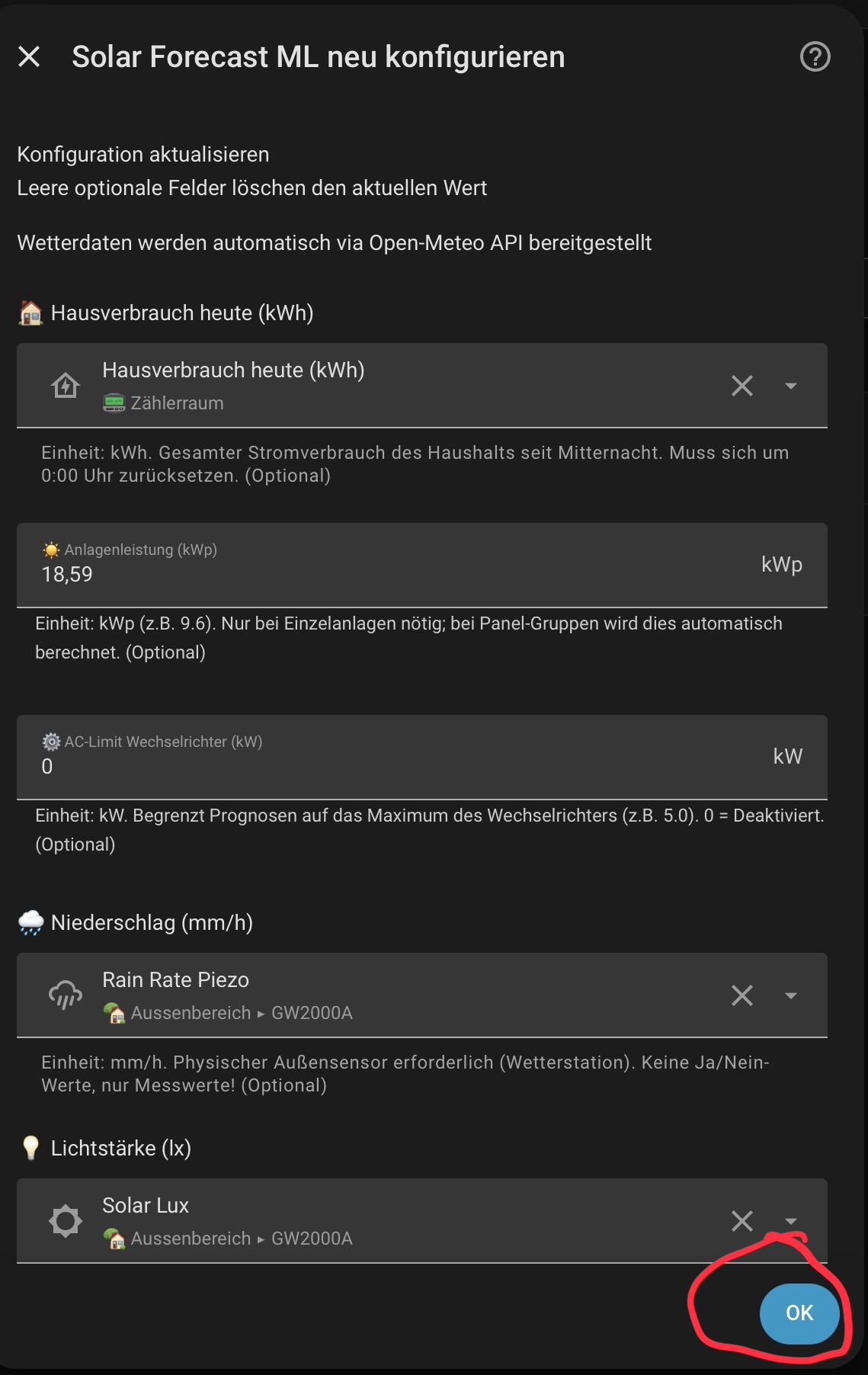

SFML v32 introduced new requirements for sensors.
I can’t figure out where to update them.
There is screen recording where I try to find relevant options inside Home Assistant:
Hier neu konfigurieren … SFML - das zweite Fenster nach den ersten Entitäten. Nicht in STATS, das dient nur zur Anzeige.

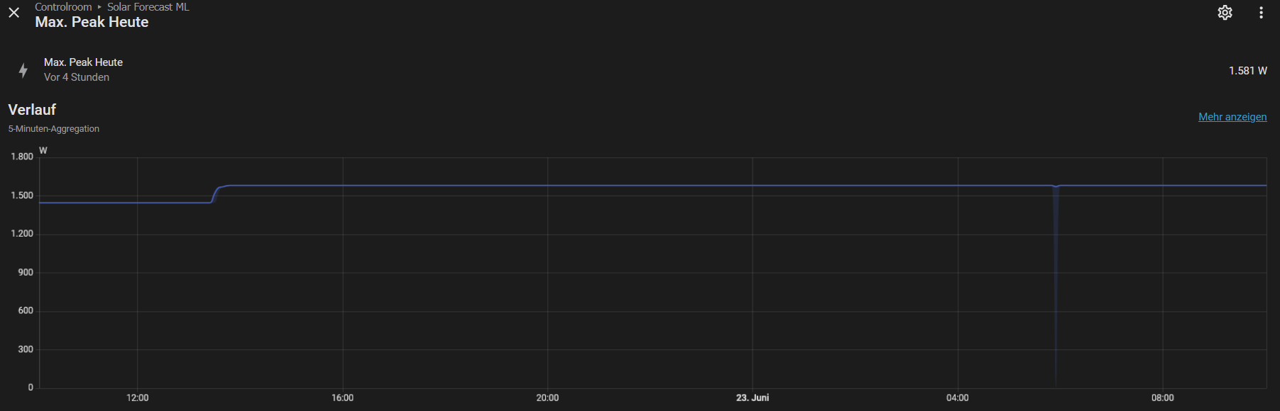

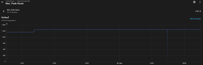

@Tom-HA Der Wert Max. Peak Heute setzt sich nicht um 0 Uhr zurück
