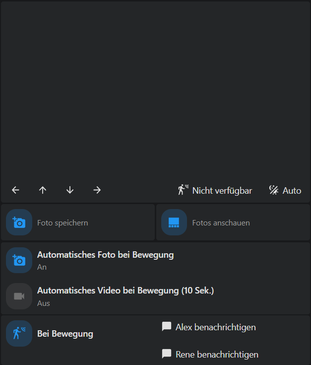

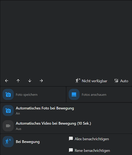

Ich verwende eine C210 auch mit Tapo-Control aus dem HACS.
In diesem Sinne teile ich mal meine Karten: (die Kamera ist gerade offline, daher kein Bild und kein Motion Sensor)
type: vertical-stack
cards:
  - type: custom:vertical-stack-in-card
    cards:
      - type: picture-glance
        title: Küche
        camera_image: camera.tapocam_hd_stream
        camera_view: live
        entity: camera.tapocam_hd_stream
        entities:
          - entity: camera.tapocam_hd_stream
        style: |
          :host .box {
            display: none
      - type: custom:layout-card
        layout_type: custom:grid-layout
        layout:
          grid-template-columns: auto auto
        cards:
          - type: custom:mushroom-chips-card
            chips:
              - type: entity
                entity: button.tapocam_move_left
                tap_action:
                  action: toggle
              - type: entity
                entity: button.tapocam_move_up
                tap_action:
                  action: toggle
              - type: entity
                entity: button.tapocam_move_down
                tap_action:
                  action: toggle
              - type: entity
                entity: button.tapocam_move_right
                tap_action:
                  action: toggle
            chips:
              - type: entity
                entity: select.tapocam_motion_detection
              - type: entity
                entity: input_select.tapocam_modus
            alignment: end
  - type: horizontal-stack
    cards:
      - type: custom:mushroom-template-card
        primary: Foto speichern
        icon: mdi:camera-plus
        tap_action:
          action: call-service
          service: camera.snapshot
            filename: >-
              /config/www/tapocam/snap_{{ now().strftime("%d.%m.%Y_%H.%M")
            entity_id: camera.tapocam_hd
        icon_color: blue
        primary: Fotos anschauen
        icon: mdi:view-gallery
        tap_action:
          action: navigate
          navigation_path: >-
            /media-browser/browser/app%2Cmedia-source%3A%2F%2Fmedia_source/%2Cmedia-source%3A%2F%2Fmedia_source%2Flocal%2Ftapocam
        icon_color: blue
    cards:
      - type: custom:mushroom-entity-card
        entity: automation.kamera_foto_bei_bewegung
        name: Automatisches Foto bei Bewegung
        tap_action:
          action: toggle
        name: Automatisches Video bei Bewegung (10 Sek.)
        entity: automation.15_sek_video_bei_bewegung
        icon: mdi:video
        tap_action:
          action: toggle
    horizontal: true
    cards:
        entity: binary_sensor.tapocam_motion
        icon_color: blue
        secondary_info: none
        chips:
          - type: entity
            entity: automation.notification_tapocam_bewegung
            name: Alex benachrichtigen
            content_info: name
            icon: mdi:message
            tap_action:
              action: toggle
            icon_color: blue
          - type: entity
            entity: automation.tapocam_4_renzo
            name: Rene benachrichtigen
            content_info: name
            icon: mdi:message
            tap_action:
              action: toggle
            icon_color: blue

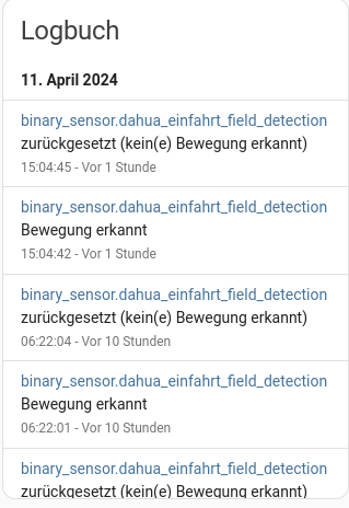

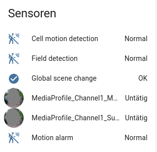

Auch wenn ich keine TP-Link Tapo sondern Dahua Kameras nutze, aber im Normafall sollte es bei der Tapo Kamera dann auch entsprechende Sensoren geben. Bsp.
Kamera_Sensoren
und dann sollten im Logbuch auch entsprechende Einträge auftauchen wenn diese Sensoren genutzt bzw. ausgelöst wurden. Bsp.:
