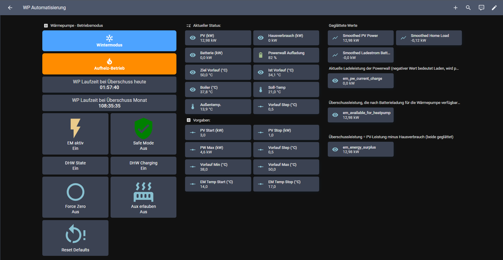

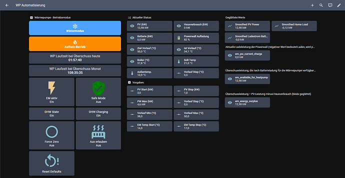

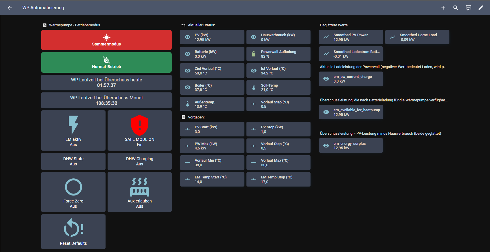

:control_knobs: Neues UI – Mode Button
Der neue Button zeigt jetzt klar den aktuellen Status und erlaubt direkten Wechsel:
  • :snowflake: Winter = blau
  • :sun: Sommer = rot
  • visuelle Rückmeldung + klare Zustandsanzeige
:camera_with_flash: Screenshots:
  • Screenshot Wintermodus
  • Screenshot Sommermodus

          entity_id: input_number.em_min_runtime
          value: 15
      - service: input_number.set_value
          entity_id: input_number.em_pv_threshold_start
          value: 3
          entity_id: input_number.em_pv_threshold_stop
          value: 1
          entity_id: input_number.em_dhw_max_temp
          value: 55
          entity_id: input_number.em_dhw_min_temp
          value: 45
          entity_id: input_number.em_dhw_charge_min_duration
          value: 20
          entity_id: input_number.em_avail_start
          value: 0.6
          entity_id: input_number.em_avail_stop
          value: 0.4
      # 🌡 Boiler Startwert setzen
      - service: number.set_value
          entity_id: number.boiler_selected_flow_temperature
          value: "{{ states('input_number.em_flow_temp_min') | float(38) }}"
      # 🔌 Aktoren sicher aus
      - service: switch.turn_off
          entity_id:
            - switch.boiler_dhw_one_time_charging
            - switch.boiler_aux_heater_only
      # 📣 Feedback
      - service: notify.persistent_notification
          title: "EM Reset"
          message: "System wurde vollständig zurückgesetzt und in Wintermodus initialisiert"

  - alias: "EM: Aux-Heater Steuerung"
    description: "Blockiert Aux-Heater wenn nicht erlaubt oder Boiler Temp ausreichend, mit Hysterese"
    trigger:
      - platform: state
        entity_id:
          - input_boolean.em_allow_aux
          - sensor.boiler_heat_carrier_forward_tc1
          - input_boolean.em_dhw_charging
          - sensor.em_available_for_heatpump
    condition:
      - condition: state
        entity_id: input_boolean.em_safe_mode
        state: 'off'
    action:
      - variables:
          allow_aux: "{{ is_state('input_boolean.em_allow_aux', 'on') }}"
          boiler_temp: "{{ states('sensor.boiler_heat_carrier_forward_tc1') | float(0) }}"
          min_temp: "{{ states('input_number.em_dhw_min_temp') | float(0) }}"
          dhw_charging: "{{ is_state('input_boolean.em_dhw_charging', 'on') }}"
          pv_avail: "{{ states('sensor.em_available_for_heatpump') | float(0) }}"
          start_thresh: "{{ states('input_number.em_avail_start') | float(0) }}"
          stop_thresh: "{{ states('input_number.em_avail_stop') | float(0) }}"
      - choose:
          - conditions:
              - condition: template
                value_template: >-
                  {{ not allow_aux and boiler_temp > min_temp and dhw_charging and pv_avail > stop_thresh }}
            sequence:
                  entity_id: switch.boiler_aux_heater_only
              - service: system_log.write
                  message: "EM: Aux-Heater deaktiviert wegen Energiemanager"
                  level: info
          - conditions:
                value_template: "{{ allow_aux }}"
            sequence:
              - service: switch.turn_on
                  message: "EM: Aux-Heater erlaubt durch Energiemanager"
                  level: info
  - alias: "EM: Force smoothed zero on startup"
    description: "Setzt beim HA-Start kurzzeitig das Force-Zero-Flag, bis Rohsensoren initialisiert sind"
    trigger:
      - platform: homeassistant
        event: start
    action:
      - service: input_boolean.turn_on
          entity_id: input_boolean.energy_manager_force_zero
      - wait_for_trigger:
          - platform: template
            value_template: >-
              {% set s1 = states('sensor.my_home_solar_energie') %}
              {% set s2 = states('sensor.my_home_last_leistung') %}
              {% set s3 = states('sensor.my_home_batterie_leistung') %}
              {{ [s1, s2, s3] | select('match', '^(?!unknown$|^unavailable$|^$).+') | list | count > 0 }}
        timeout: "00:00:20"
      - delay: "00:00:02"
      - service: homeassistant.update_entity
          entity_id:
            - sensor.em_pv_power_smoothed
            - sensor.em_home_load_smoothed
            - sensor.em_powerwall_battery_power_smoothed
            - sensor.em_pv_power_corrected
            - sensor.em_home_load_corrected
            - sensor.em_powerwall_charge_corrected
            - sensor.em_energy_surplus
            - sensor.em_pw_current_charge
            - sensor.em_pw_max_charge
            - sensor.em_target_flow_temp
            - sensor.em_current_flow_temp
      - delay: "00:00:01"
      - service: input_boolean.turn_off
  - alias: "EM: Aux-Heater max Laufzeit"
    description: "Schaltet den Aux-Heater automatisch nach definierter Zeit wieder aus (Failsafe)"
    mode: restart
    trigger:
      - platform: state
        to: "on"
        for: "00:20:00"
    condition: []
    action:
          message: "EM: Aux-Heater wurde nach 20 Minuten automatisch abgeschaltet (Failsafe)"
          level: warning
  - alias: "EM: Aux-Heater aus bei keinem PV-Überschuss"
    description: "Schaltet den Aux-Heater aus, wenn kein ausreichender PV-Überschuss vorhanden ist"
    mode: restart
    trigger:
      - platform: numeric_state
        entity_id: sensor.em_available_for_heatpump
        below: 0.3
        for: "00:02:00"
    condition: []
    action:
      - condition: state
        state: "on"
          message: "EM: Aux-Heater deaktiviert wegen fehlendem PV-Überschuss"
          level: warning
  - alias: "EM: Moduswechsel ausführen"
    trigger:
      - platform: state
        entity_id: input_select.energy_manager_mode
    action:
      - service: script.em_set_mode
  - alias: "EM: HARD Restore Modus nach Neustart"
    trigger:
        event: start
    action:
      # ⏱ wirklich warten bis alles stabil ist
      - delay: "00:00:20"
      # 🧠 Modus hart lesen (mit Fallback!)
      - variables:
          mode: "{{ states('input_select.energy_manager_mode') | default('Winter') }}"
      # 🧯 Debug zur Kontrolle
          message: "EM START: gespeicherter Modus = {{ mode }}"
          level: warning
      # 🔥 HARTE WIEDERHERSTELLUNG
      - choose:
          - conditions:
                value_template: "{{ mode == 'Sommer' }}"
            sequence:
          - conditions:
                value_template: "{{ mode == 'Winter' }}"
            sequence:

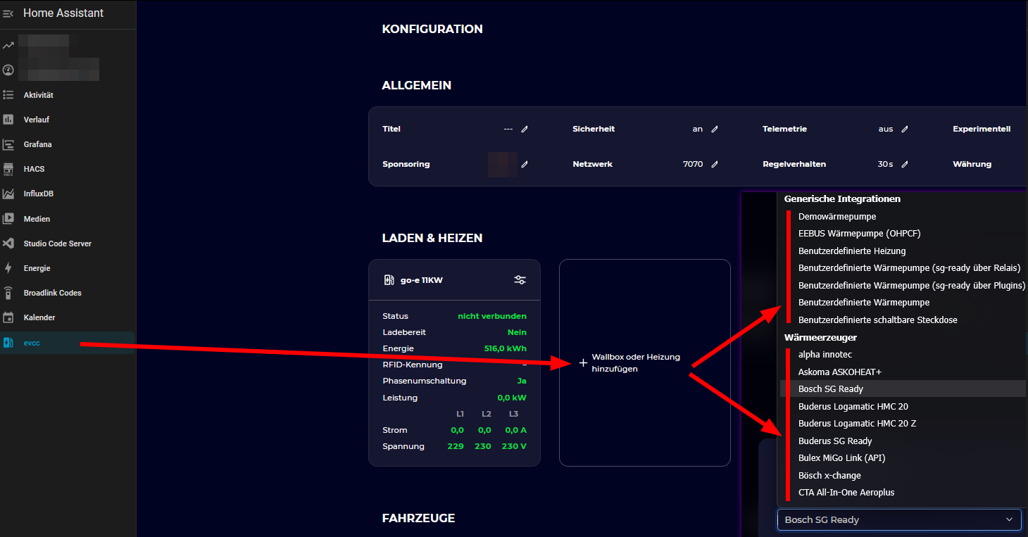

weiß nicht ob der Tipp schon gefallen ist, es einfach mit EVCC zu machen
die können E-Autos und Heizungen, Heizstäbe, Wärmepumpen, …. alles einbinden - und mit Verlaub - wahrscheinlich so intelligent mit dem Überschuss ansteuerun, wie es wahrscheinlich wenige von uns mit Automatisierungen hin bekämen.
Ist als Addon für HOAS verfügbar
du hinterlegst dein PV-System + Speicher, deine Wärmepumpe, stellst ein wie deine “Logik” sein soll und fertig.
