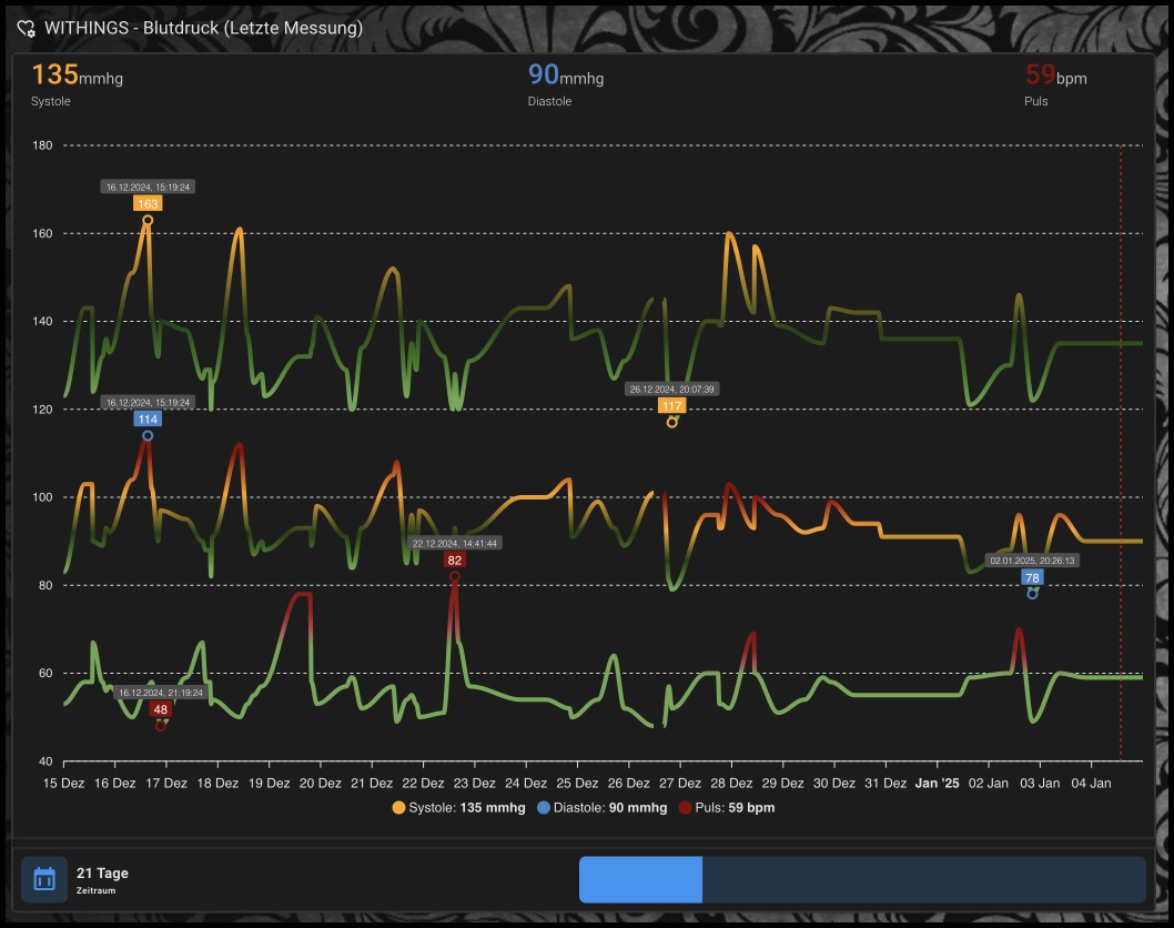

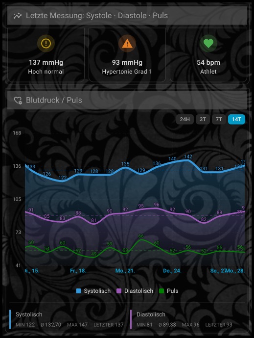

Wie hast Du die min/max Anzeige hinbekommen? Disregard, habe ich selber gefunden. Gut, dass Du das angesprochen hast. So ist es besser.
          show:
            extremas: time
Habe die Farben noch angepasst für die aktuelle Messung.
type: horizontal-stack
cards:
  - type: custom:mushroom-template-card
    entity: sensor.withings_systolischer_blutdruck
    primary: >-
      {% set systole_value = states('sensor.withings_systolischer_blutdruck') |
      int %}
      {{ systole_value }} mmhg
    secondary: Systole
    icon: mdi:chart-timeline-variant-shimmer
    multiline_secondary: true
    layout: vertical
    icon_color: >-
      int %}
      {# Niedrig #}
      {% if systole_value < 106 %}
        #93c47d
      {# Optimal #}
      {% elif systole_value < 121 %}
        #93c47d
      {# Normal #}
      {% elif systole_value < 131 %}
        #84b070
      {# Hochnormal #}
      {% elif systole_value < 140 %}
        #ad4c4c
      {# Hypertonie Grad 1 #}
      {% elif systole_value < 160 %}
        #a23232
      {# Hypertonie Grad 2 #}
      {% elif systole_value < 180 %}
        #961919
      {# Hypertonie Grad 3 #}
      {% elif systole_value > 180 %}
        #8b0000
      {% endif %}
    tap_action:
      action: none
    grid_options:
      columns: 8
      rows: auto
    badge_icon: ""
    fill_container: false
    entity: sensor.withings_diastolischer_blutdruck
    primary: >-
      {% set diastole_value = states('sensor.withings_diastolischer_blutdruck')
      | int %}
      {{ diastole_value }} mmhg
    secondary: Disatole
    layout: vertical
    icon_color: >-
      | int %}
      {# Niedrig #}
      {% if diastole_value < 66 %}
        #93c47d
      {# Optimal #}
      {% elif diastole_value < 81 %}
        #93c47d
      {# Normal #}
      {% elif diastole_value < 86 %}
        #84b070
      {# Hochnormal #}
      {% elif diastole_value < 90 %}
        #759c64
      {% elif diastole_value < 100 %}
        #a23232
      {% elif diastole_value < 110 %}
        #961919
      {% elif diastole_value >= 110 %}
        #8b0000
      {% endif %}
    tap_action:
      action: none
    grid_options:
      columns: 8
      rows: auto
    entity: sensor.withings_herzschlag
    primary: |-
      {% set herzschlag_value = states('sensor.withings_herzschlag') | int %}
      {{ herzschlag_value }} bpm
    secondary: |-
      {# Athlet #}
      {% if herzschlag_value <= 55 %}
        Athlet
      {# Exzellent #}
      {% elif herzschlag_value <= 61 %}
        Exzellent
      {# Gut #}
      {% elif herzschlag_value <= 65 %}
        Gut
      {# Überdurchschnittlich #}
      {% elif herzschlag_value <= 70 %}
      {# Durchschnitt #}
      {% elif herzschlag_value <= 74 %}
        Durchschnitt
      {# Unterdurchschnittlich #}
      {% elif herzschlag_value <= 80 %}
      {# SCHLECHT #}
      {% elif herzschlag_value > 80 %}
        SCHLECHT
      {% endif %}
    icon: mdi:heart-pulse
    layout: vertical
    icon_color: |-
      {# Athlet #}
        #93c47d
      {# Exzellent #}
        #84b070
      {# Gut #}
        #759c64
        #ad4c4c
      {# Durchschnitt #}
        #a23232
        #961919
      {# SCHLECHT #}
        #8b0000
      {% endif %}
    tap_action:
      action: none
    grid_options:
      columns: 8
      rows: auto
grid_options:
  columns: full

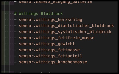

Ist das der hier?
Jepp, das isser, der Sensor.

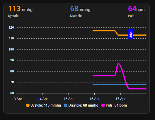

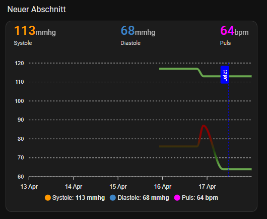

Ich verfolge das ganze auch und habe das auch eingebunden mit
type: custom:apexcharts-card
experimental:
  color_threshold: true
graph_span: 5d
span:
  end: day
chart_type: line
header:
  show: true
  title: ""
  show_states: true
  colorize_states: true
series:
  - entity: sensor.withings_systolischer_blutdruck
    color_threshold:
      - value: 120
        color: "#6AA84F"
      - value: 129
        color: "#38761D"
      - value: 139
        color: "#1F3F0F"
      - value: 159
        color: orange
      - value: 179
        color: "#990000"
      - value: 180
        color: darkred
    stroke_width: 4
  - entity: sensor.withings_diastolischer_blutdruck
    color: "#3D85C6"
    color_threshold:
      - value: 60
        color: "#6AA84F"
      - value: 84
        color: "#38761D"
      - value: 89
        color: "#1F3F0F"
      - value: 99
        color: orange
      - value: 109
        color: "#990000"
      - value: 110
        color: darkred
    stroke_width: 4
  - entity: sensor.withings_herzschlag
    color: magenta
    color_threshold:
      - value: 66
        color: "#6AA84F"
      - value: 70
        color: "#38761D"
      - value: 74
        color: "#1F3F0F"
      - value: 82
        color: darkred
    stroke_width: 4
now:
  show: true
  color: blue
  label: Jetzt
Allerdings fehlt bei mir die “sensor.withings_diastolischer_blutdruck” Linie.
Scheint am aber am color_threshold: zu legen, denn wenn ich den auf false setze sehe ich alle 3 Linien.
Weiß da einer ob Apex da ein Problem hat?
color_threshold: false
Speicherst Du die Daten auch korrekt mit dem “recorder”?
Prüf mal ob Du es auch richtig geschrieben hast (auch im “recorder”), anders kann ich es mir nicht erklären.
Ja ich speichere alle werte.
Ich warte jetzt mal noch ab für ein paar Tage um mehr Werte zu erhalten.

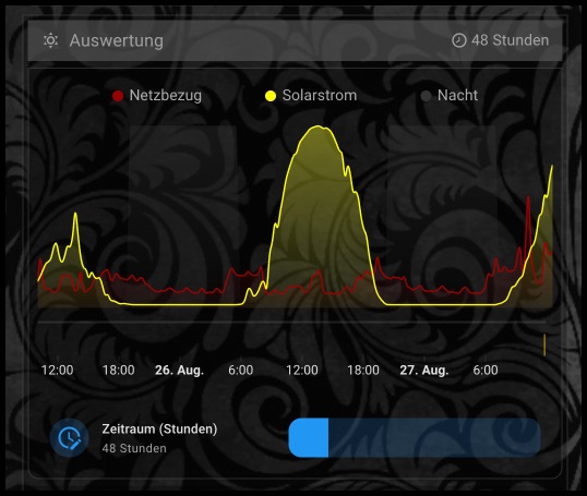

Hi @RobertoCravallo ,
wie hast du das mit dem Slider der Tage hinbekommen?
Dobsen
Da musst Du mit einem HELFER arbeiten. Der Code sieht so aus
type: custom:config-template-card
entities:
  - input_number.stunden
card:
  type: custom:stack-in-card
  cards:
    - type: custom:mini-graph-card
      entities:
        - entity: sensor.cravallo_leistung_eigenverbrauch
          color: '#990000'
        - entity: sensor.cravallo_leistung_solar
          color: yellow
        - entity: sensor.is_it_night
          color: '#333333'
          show_line: false
          y_axis: secondary
      line_width: 1.5
      points_per_hour: 4
      height: 180
      hours_to_show: ${states["input_number.stunden"].state}
      animate: true
      show:
        icon: false
        state: false
        points: false
        legend: true
        fill: fade
        labels: false
      uix:
        style: |
          ha-card {
            border: none;
            box-shadow: none;
            background: none;
    - type: history-graph
      entities:
        - entity: sun.sun
      uix:
        style: |
          ha-card {
            border: none;
            box-shadow: none;
            background: none;
            margin-top: -20px; /* Zieht den Sonnen-Graphen näher an den Hauptgraphen */
          .content {
            padding: 0px 6px 0px 0px !important;
    - type: custom:mushroom-number-card
      entity: input_number.stunden
      name: Zeitraum (Stunden)
      icon: mdi:clock-edit-outline
      icon_color: blue
      layout: horizontal
      uix:
        style: |
          ha-card {
            background: none;
            border: none;
            padding-bottom: 8px;
