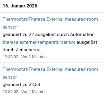

das funktioniert auch soweit, nur wird instantan der Wert überschrieben:
das führt zu folgendem Werteverlauf:
Wie kann ich herausfinden, wer den Wert setzt und warum?

tut noch nicht. das Topic ist wohl case sensitive. Ich habe nun erfolgreich ein log bekommen:
Aber unmittelbar danach kommt noch ein /set befehl:
[2026-01-16 16:19:10] info: 	z2m:mqtt: MQTT publish: topic 'zigbee2mqtt/Thermostat-Theresa', payload '{"adaptation_run_control":"none","adaptation_run_settings":true,"adaptation_run_status":"found","algorithm_scale_factor":5,"battery":95,"day_of_week":"thursday",
"external_measured_room_sensor":"22.71",
"heat_available":true,"heat_required":true,"keypad_lockout":"unlock","linkquality":255,"load_balancing_enable":true,"load_estimate":2686,"load_room_mean":-8000,"local_temperature":23.71,"mounted_mode_active":false,"mounted_mode_control":true,"occupied_heating_setpoint":23,"occupied_heating_setpoint_scheduled":23,"pi_heating_demand":99,"preheat_status":false,"programming_operation_mode":"setpoint","radiator_covered":true,"regulation_setpoint_offset":0,"running_state":"heat","setpoint_change_source":"schedule","system_mode":"heat","thermostat_vertical_orientation":null,"trigger_time":660,"update":{"installed_version":32,"latest_version":32,"state":"idle"},"viewing_direction":null,"window_open_external":false,"window_open_feature":true,"window_open_internal":"closed"}'
"external_measured_room_sensor":22,
Aber wer schickt den ab?
