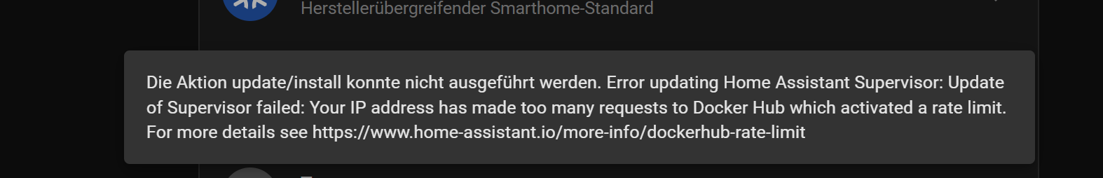

Can't update Addons or Supervisor. …Many reports on Facebook about similar situation.

[139759724312064] Error during service call to update.install: Error updating Let's Encrypt: 'AddonManager.update' blocked from execution, supervisor needs to be updated first
[139759724312064] Error during service call to update.install: Error updating Home Assistant Supervisor: Update of Supervisor failed: Your IP address has made too many requests to Docker Hub which activated a rate limit. For more details see https://www.home-assistant.io/more-info/dockerhub-rate-limit
