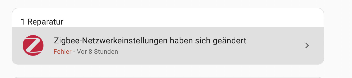

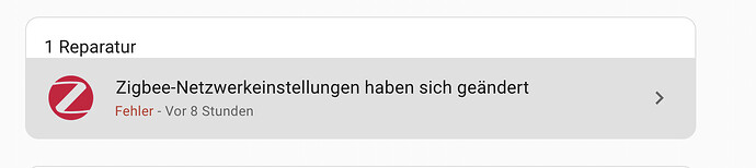

Socat sei disabled, ich finde keine Möglichkeit, das auf dem Home assistent green mit Sky Connect integrierte ZHA zu disablen - liegt es daran? Die App ZigBee2MTTQ läuft nach 2 Nächten “liegen lassen” und anfänglichen Cloudflared Problemen.

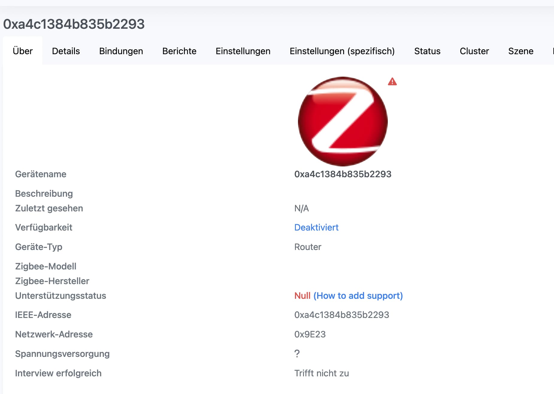

Zigbee2MQTT:info  2024-01-03 07:19:54: Device '0xa4c1384b835b2293' joined
Zigbee2MQTT:info  2024-01-03 07:19:54: MQTT publish: topic 'zigbee2mqtt/bridge/event', payload '{"data":{"friendly_name":"0xa4c1384b835b2293","ieee_address":"0xa4c1384b835b2293"},"type":"device_joined"}'
Zigbee2MQTT:info  2024-01-03 07:19:54: MQTT publish: topic 'zigbee2mqtt/bridge/log', payload '{"message":{"friendly_name":"0xa4c1384b835b2293"},"type":"device_connected"}'
Zigbee2MQTT:info  2024-01-03 07:19:54: Starting interview of '0xa4c1384b835b2293'
Zigbee2MQTT:info  2024-01-03 07:19:54: MQTT publish: topic 'zigbee2mqtt/bridge/event', payload '{"data":{"friendly_name":"0xa4c1384b835b2293","ieee_address":"0xa4c1384b835b2293","status":"started"},"type":"device_interview"}'
Zigbee2MQTT:info  2024-01-03 07:19:54: MQTT publish: topic 'zigbee2mqtt/bridge/log', payload '{"message":"interview_started","meta":{"friendly_name":"0xa4c1384b835b2293"},"type":"pairing"}'
Zigbee2MQTT:error 2024-01-03 07:20:04: Failed to interview '0xa4c1384b835b2293', device has not successfully been paired
Zigbee2MQTT:info  2024-01-03 07:20:04: MQTT publish: topic 'zigbee2mqtt/bridge/event', payload '{"data":{"friendly_name":"0xa4c1384b835b2293","ieee_address":"0xa4c1384b835b2293","status":"failed"},"type":"device_interview"}'
Zigbee2MQTT:info  2024-01-03 07:20:04: MQTT publish: topic 'zigbee2mqtt/bridge/log', payload '{"message":"interview_failed","meta":{"friendly_name":"0xa4c1384b835b2293"},"type":"pairing"}'
Das ist der Lidl Stecker:
und:
Was könnte helfen? Vielen Dank!
