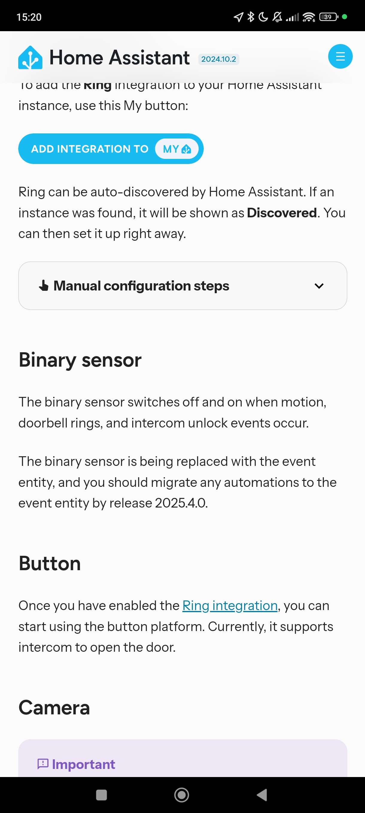

Binary sensor
The binary sensor switches off and on when motion, doorbell rings, and intercom unlock events occur.
The binary sensor is being replaced with the event entity, and you should migrate any automations to the event entity by release 2025.4.0.
Button
Once you have enabled the Ring integration, you can start using the button platform. Currently, it supports intercom to open the door.
