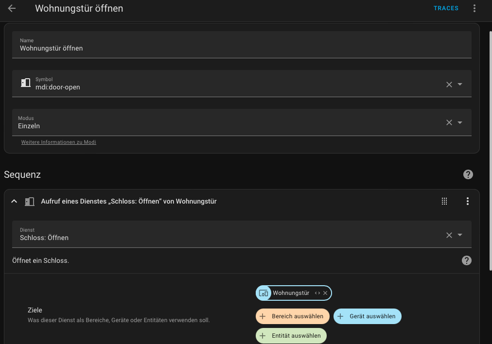

Hallo, ja eine Lösung habe ich mittlerweile gefunden.
1.script:
2.Karte:
type: custom:mushroom-lock-card
entity: lock.homematic_wohnungstur
fill_container: true
layout: horizontal
tap_action:
  action: none
hold_action:
  action: call-service
  service: lock.lock
  target: {}
3.configuration.yaml
homekit:
  - name: HASS Bridge
    port: 21.....
    filter:
      include_domains:
        - cover
        - light
        - switch
      include_entities:
        - cover.homematic_tor_4
        - lock.homematic_wohnungstur
        - script.wohnungstur_offnen
