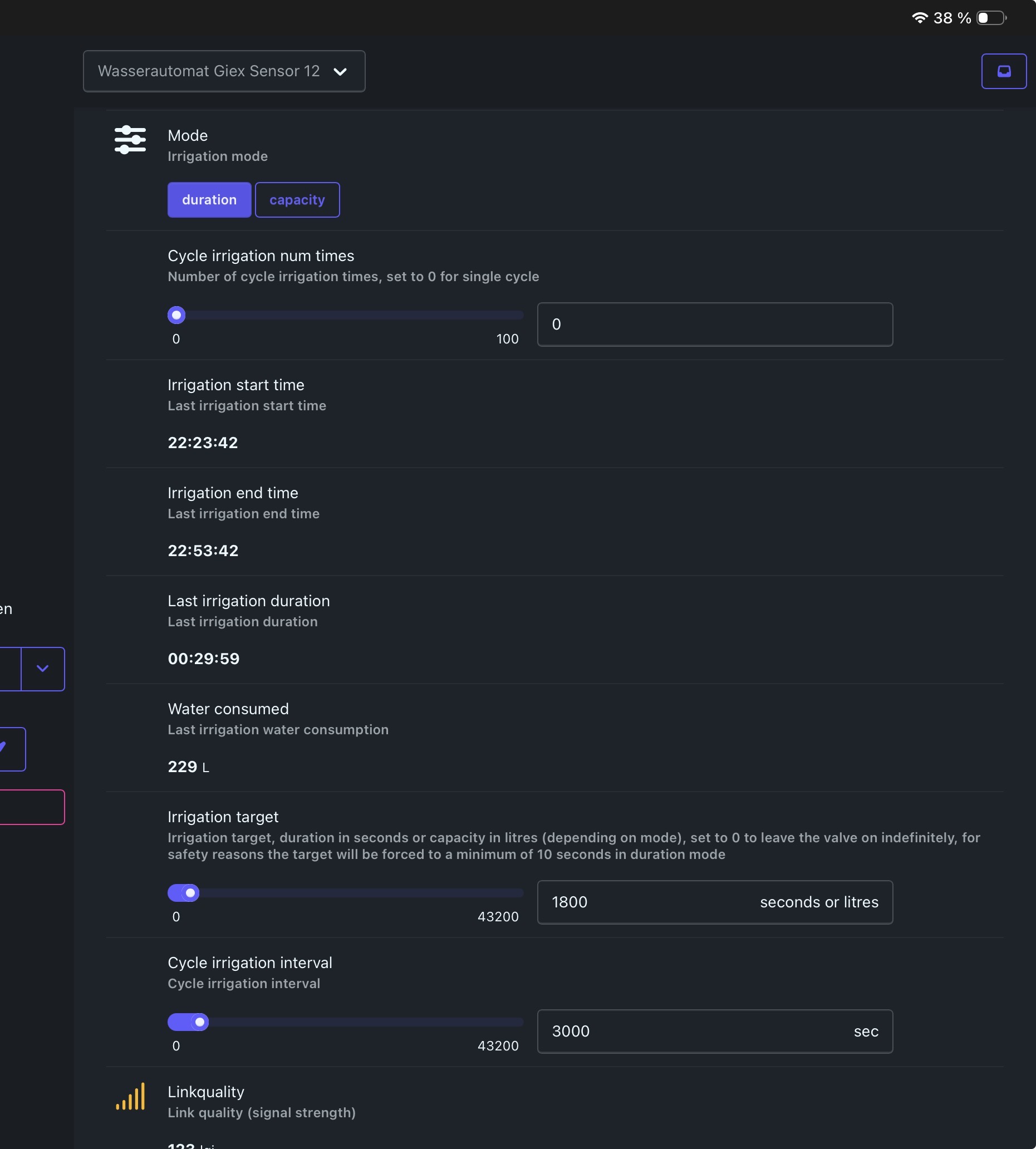

### What happened?
Changed status to ON in frontend, after 11 seconds (set in f…rontend) the water valve closes but frontend doesn't change status to OFF.
The frontend doesn't change status if hard button on water valve is pressed either.
### What did you expect to happen?
The frontend should update status to off after valve is closed.
The frontend should update status if hard button is pressed.
### How to reproduce it (minimal and precise)
Set valve to close after X seconds and wait for valve to close.
