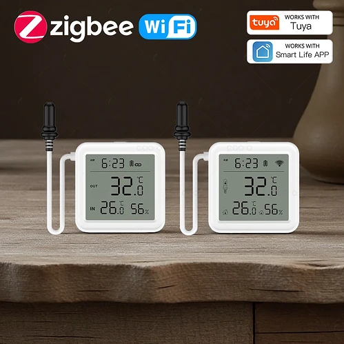

### Link
https://aliexpress.com/item/1005010228473749.html
