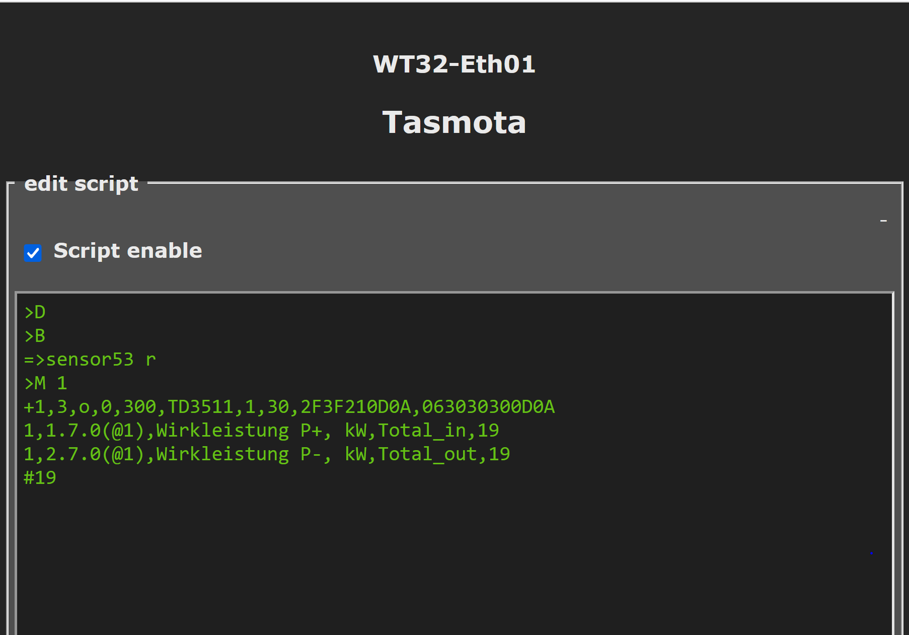

Leider funz das letzte Skript nicht:

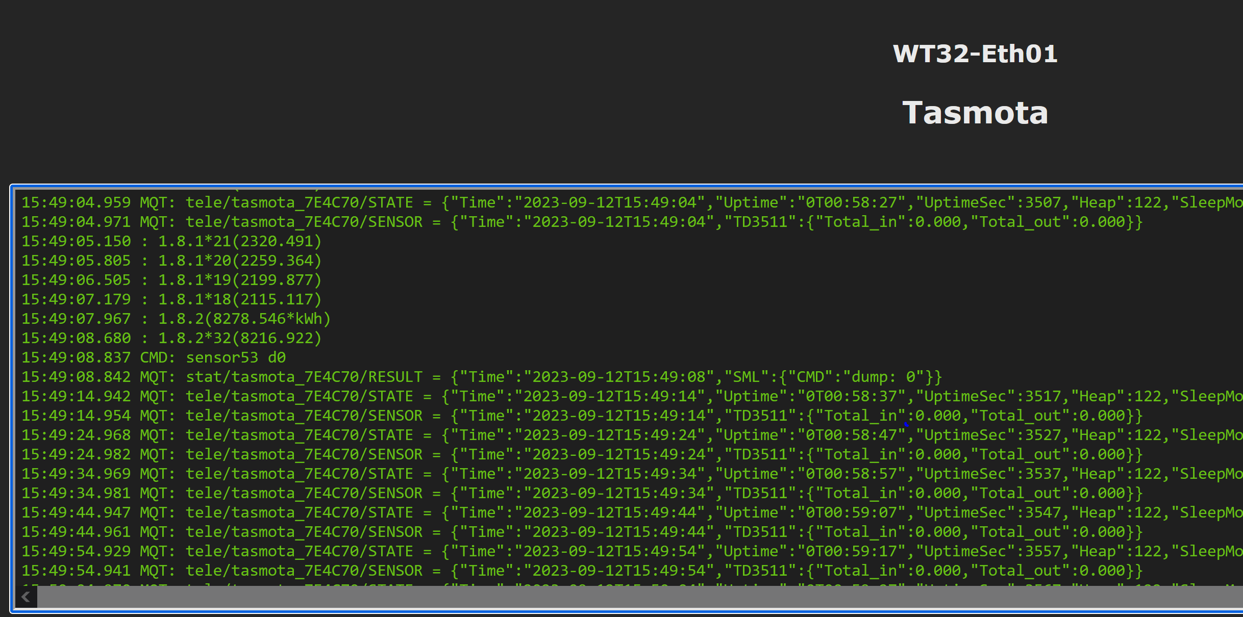

14:32:32.922 MQT: tele/tasmota_7E4C70/SENSOR = {“Time”:“2023-09-12T14:32:32”,“TD3511”:{“Total_in”:0,“Total_out”:0}}
14:32:42.935 MQT: tele/tasmota_7E4C70/STATE = {“Time”:“2023-09-12T14:32:42”,“Uptime”:“0T00:01:16”,“UptimeSec”:76,“Heap”:122,“SleepMode”:“Dynamic”,“Sleep”:50,“LoadAvg”:19,“MqttCount”:1,“Berry”:{“HeapUsed”:4,“Objects”:46}}
14:32:42.955 MQT: tele/tasmota_7E4C70/SENSOR = {“Time”:“2023-09-12T14:32:42”,“TD3511”:{“Total_in”:0,“Total_out”:0}}
14:32:52.929 MQT: tele/tasmota_7E4C70/STATE = {“Time”:“2023-09-12T14:32:52”,“Uptime”:“0T00:01:26”,“UptimeSec”:86,“Heap”:122,“SleepMode”:“Dynamic”,“Sleep”:50,“LoadAvg”:19,“MqttCount”:1,“Berry”:{“HeapUsed”:4,“Objects”:46}}
14:32:52.952 MQT: tele/tasmota_7E4C70/SENSOR = {“Time”:“2023-09-12T14:32:52”,“TD3511”:{“Total_in”:0,“Total_out”:0}}
14:33:02.909 MQT: tele/tasmota_7E4C70/STATE = {“Time”:“2023-09-12T14:33:02”,“Uptime”:“0T00:01:36”,“UptimeSec”:96,“Heap”:122,“SleepMode”:“Dynamic”,“Sleep”:50,“LoadAvg”:19,“MqttCount”:1,“Berry”:{“HeapUsed”:4,“Objects”:46}}
14:33:02.932 MQT: tele/tasmota_7E4C70/SENSOR = {“Time”:“2023-09-12T14:33:02”,“TD3511”:{“Total_in”:0,“Total_out”:0}}
14:33:12.932 MQT: tele/tasmota_7E4C70/STATE = {“Time”:“2023-09-12T14:33:12”,“Uptime”:“0T00:01:46”,“UptimeSec”:106,“Heap”:122,“SleepMode”:“Dynamic”,“Sleep”:50,“LoadAvg”:19,“MqttCount”:1,“Berry”:{“HeapUsed”:4,“Objects”:46}}
14:33:12.956 MQT: tele/tasmota_7E4C70/SENSOR = {“Time”:“2023-09-12T14:33:12”,“TD3511”:{“Total_in”:0,“Total_out”:0}}
14:33:22.931 MQT: tele/tasmota_7E4C70/STATE = {“Time”:“2023-09-12T14:33:22”,“Uptime”:“0T00:01:56”,“UptimeSec”:116,“Heap”:122,“SleepMode”:“Dynamic”,“Sleep”:50,“LoadAvg”:19,“MqttCount”:1,“Berry”:{“HeapUsed”:4,“Objects”:46}}
14:33:22.953 MQT: tele/tasmota_7E4C70/SENSOR = {“Time”:“2023-09-12T14:33:22”,“TD3511”:{“Total_in”:0,“Total_out”:0}}
14:33:32.900 MQT: tele/tasmota_7E4C70/STATE = {“Time”:“2023-09-12T14:33:32”,“Uptime”:“0T00:02:06”,“UptimeSec”:126,“Heap”:122,“SleepMode”:“Dynamic”,“Sleep”:50,“LoadAvg”:19,“MqttCount”:1,“Berry”:{“HeapUsed”:4,“Objects”:46}}
14:33:32.922 MQT: tele/tasmota_7E4C70/SENSOR = {“Time”:“2023-09-12T14:33:32”,“TD3511”:{“Total_in”:0,“Total_out”:0}}
14:33:42.903 MQT: tele/tasmota_7E4C70/STATE = {“Time”:“2023-09-12T14:33:42”,“Uptime”:“0T00:02:16”,“UptimeSec”:136,“Heap”:122,“SleepMode”:“Dynamic”,“Sleep”:50,“LoadAvg”:19,“MqttCount”:1,“Berry”:{“HeapUsed”:4,“Objects”:46}}
14:33:42.925 MQT: tele/tasmota_7E4C70/SENSOR = {“Time”:“2023-09-12T14:33:42”,“TD3511”:{“Total_in”:0,“Total_out”:0}}
14:33:52.913 MQT: tele/tasmota_7E4C70/STATE = {“Time”:“2023-09-12T14:33:52”,“Uptime”:“0T00:02:26”,“UptimeSec”:146,“Heap”:122,“SleepMode”:“Dynamic”,“Sleep”:50,“LoadAvg”:19,“MqttCount”:1,“Berry”:{“HeapUsed”:4,“Objects”:46}}
14:33:52.934 MQT: tele/tasmota_7E4C70/SENSOR = {“Time”:“2023-09-12T14:33:52”,“TD3511”:{“Total_in”:0,“Total_out”:0}}
14:34:02.941 MQT: tele/tasmota_7E4C70/STATE = {“Time”:“2023-09-12T14:34:02”,“Uptime”:“0T00:02:36”,“UptimeSec”:156,“Heap”:122,“SleepMode”:“Dynamic”,“Sleep”:50,“LoadAvg”:19,“MqttCount”:1,“Berry”:{“HeapUsed”:4,“Objects”:46}}
14:34:02.962 MQT: tele/tasmota_7E4C70/SENSOR = {“Time”:“2023-09-12T14:34:02”,“TD3511”:{“Total_in”:0,“Total_out”:0}}
14:34:12.916 MQT: tele/tasmota_7E4C70/STATE = {“Time”:“2023-09-12T14:34:12”,“Uptime”:“0T00:02:46”,“UptimeSec”:166,“Heap”:122,“SleepMode”:“Dynamic”,“Sleep”:50,“LoadAvg”:19,“MqttCount”:1,“Berry”:{“HeapUsed”:4,“Objects”:46}}
14:34:12.936 MQT: tele/tasmota_7E4C70/SENSOR = {“Time”:“2023-09-12T14:34:12”,“TD3511”:{“Total_in”:0,“Total_out”:0}}
14:34:22.941 MQT: tele/tasmota_7E4C70/STATE = {“Time”:“2023-09-12T14:34:22”,“Uptime”:“0T00:02:56”,“UptimeSec”:176,“Heap”:122,“SleepMode”:“Dynamic”,“Sleep”:50,“LoadAvg”:19,“MqttCount”:1,“Berry”:{“HeapUsed”:4,“Objects”:46}}
14:34:22.962 MQT: tele/tasmota_7E4C70/SENSOR = {“Time”:“2023-09-12T14:34:22”,“TD3511”:{“Total_in”:0,“Total_out”:0}}
14:34:32.900 MQT: tele/tasmota_7E4C70/STATE = {“Time”:“2023-09-12T14:34:32”,“Uptime”:“0T00:03:06”,“UptimeSec”:186,“Heap”:122,“SleepMode”:“Dynamic”,“Sleep”:50,“LoadAvg”:19,“MqttCount”:1,“Berry”:{“HeapUsed”:4,“Objects”:46}}
14:34:32.920 MQT: tele/tasmota_7E4C70/SENSOR = {“Time”:“2023-09-12T14:34:32”,“TD3511”:{“Total_in”:0,“Total_out”:0}}
14:34:42.923 MQT: tele/tasmota_7E4C70/STATE = {“Time”:“2023-09-12T14:34:42”,“Uptime”:“0T00:03:16”,“UptimeSec”:196,“Heap”:122,“SleepMode”:“Dynamic”,“Sleep”:50,“LoadAvg”:19,“MqttCount”:1,“Berry”:{“HeapUsed”:4,“Objects”:46}}
14:34:42.944 MQT: tele/tasmota_7E4C70/SENSOR = {“Time”:“2023-09-12T14:34:42”,“TD3511”:{“Total_in”:0,“Total_out”:0}}
14:34:52.935 MQT: tele/tasmota_7E4C70/STATE = {“Time”:“2023-09-12T14:34:52”,“Uptime”:“0T00:03:26”,“UptimeSec”:206,“Heap”:122,“SleepMode”:“Dynamic”,“Sleep”:50,“LoadAvg”:19,“MqttCount”:1,“Berry”:{“HeapUsed”:4,“Objects”:46}}
14:34:52.955 MQT: tele/tasmota_7E4C70/SENSOR = {“Time”:“2023-09-12T14:34:52”,“TD3511”:{“Total_in”:0,“Total_out”:0}}
14:35:02.915 MQT: tele/tasmota_7E4C70/STATE = {“Time”:“2023-09-12T14:35:02”,“Uptime”:“0T00:03:36”,“UptimeSec”:216,“Heap”:122,“SleepMode”:“Dynamic”,“Sleep”:50,“LoadAvg”:19,“MqttCount”:1,“Berry”:{“HeapUsed”:4,“Objects”:46}}
14:35:02.935 MQT: tele/tasmota_7E4C70/SENSOR = {“Time”:“2023-09-12T14:35:02”,“TD3511”:{“Total_in”:0,“Total_out”:0}}
14:35:12.929 MQT: tele/tasmota_7E4C70/STATE = {“Time”:“2023-09-12T14:35:12”,“Uptime”:“0T00:03:46”,“UptimeSec”:226,“Heap”:122,“SleepMode”:“Dynamic”,“Sleep”:50,“LoadAvg”:19,“MqttCount”:1,“Berry”:{“HeapUsed”:4,“Objects”:46}}
14:35:12.949 MQT: tele/tasmota_7E4C70/SENSOR = {“Time”:“2023-09-12T14:35:12”,“TD3511”:{“Total_in”:0,“Total_out”:0}}
14:35:22.917 MQT: tele/tasmota_7E4C70/STATE = {“Time”:“2023-09-12T14:35:22”,“Uptime”:“0T00:03:56”,“UptimeSec”:236,“Heap”:122,“SleepMode”:“Dynamic”,“Sleep”:50,“LoadAvg”:19,“MqttCount”:1,“Berry”:{“HeapUsed”:4,“Objects”:46}}
14:35:22.938 MQT: tele/tasmota_7E4C70/SENSOR = {“Time”:“2023-09-12T14:35:22”,“TD3511”:{“Total_in”:0,“Total_out”:0}}
14:35:32.935 MQT: tele/tasmota_7E4C70/STATE = {“Time”:“2023-09-12T14:35:32”,“Uptime”:“0T00:04:06”,“UptimeSec”:246,“Heap”:122,“SleepMode”:“Dynamic”,“Sleep”:50,“LoadAvg”:19,“MqttCount”:1,“Berry”:{“HeapUsed”:4,“Objects”:46}}
14:35:32.955 MQT: tele/tasmota_7E4C70/SENSOR = {“Time”:“2023-09-12T14:35:32”,“TD3511”:{“Total_in”:0,“Total_out”:0}}
14:35:42.914 MQT: tele/tasmota_7E4C70/STATE = {“Time”:“2023-09-12T14:35:42”,“Uptime”:“0T00:04:16”,“UptimeSec”:256,“Heap”:122,“SleepMode”:“Dynamic”,“Sleep”:50,“LoadAvg”:20,“MqttCount”:1,“Berry”:{“HeapUsed”:4,“Objects”:46}}
14:35:42.935 MQT: tele/tasmota_7E4C70/SENSOR = {“Time”:“2023-09-12T14:35:42”,“TD3511”:{“Total_in”:0,“Total_out”:0}}

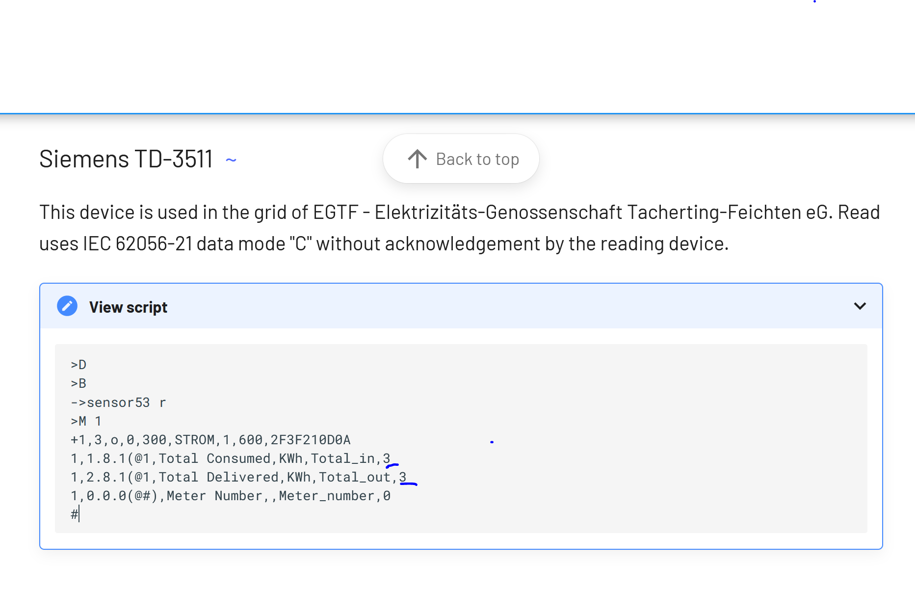

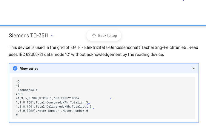

die Werte 1.7.0 und 2.7.0 wird nur mit der Zahl “3” geliefert. Wo kann ich bitte die Bedeutung dieser Zahl finden?

Ja. # ist da. Die Frage ist, warum bekomme ich nur Werte von 1.7.0 und 2.7.0 mit der Zahl 3 am Ende?
Das ist sehr interessant was die schreiben. Passt nicht so ganz zu dem was ich im Netz lese.
Hast du das gesehen und bist registriert?
https://wiki.volkszaehler.org/hardware/channels/meters/power/edl-ehz/siemens_td3511_in_oberoesterreich

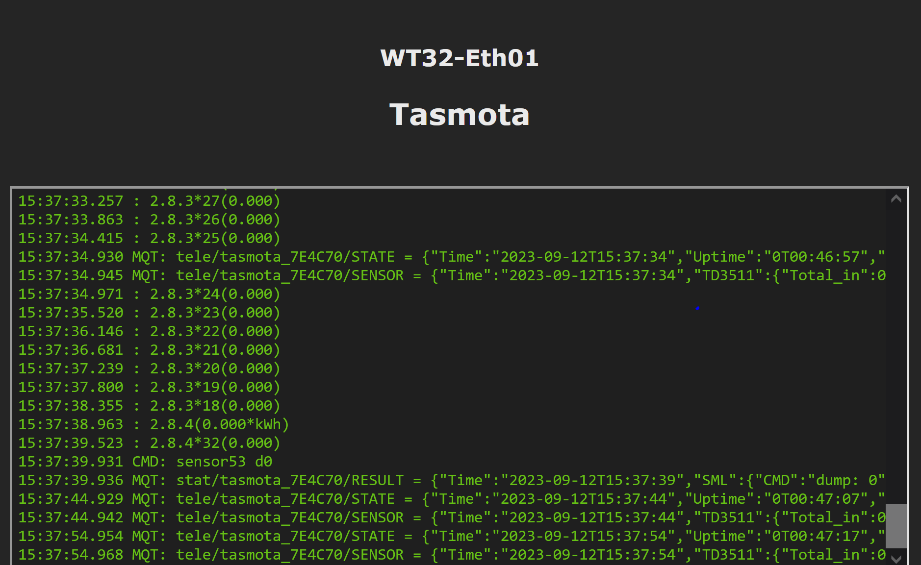

  1. Altes Skript:
Mit sensor53 d1, Parameter-Wert kommt um:
15:28:34.3CMD: sensor53 d1
15:29:57.642 : 1.7.0(0.351kW)
15:29:58.343 : 2.7.0(0.052
kW)
und danach um:
15:34:13.643 : 3.7.0(0.038kvar)
15:34:14.246 : 4.7.0(0.063
kvar)
Das ist ca. 5 Min.
Sensor53 d0 in Konsole:

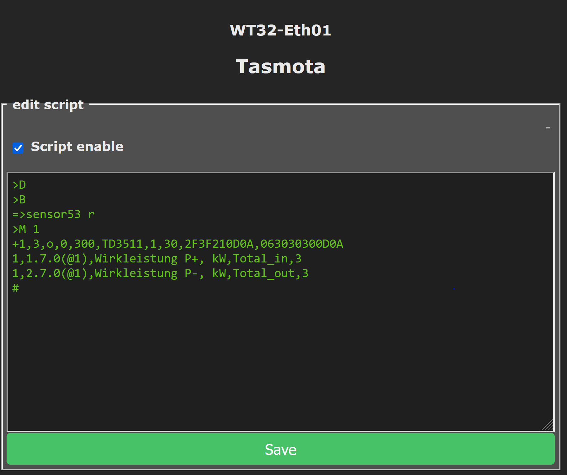

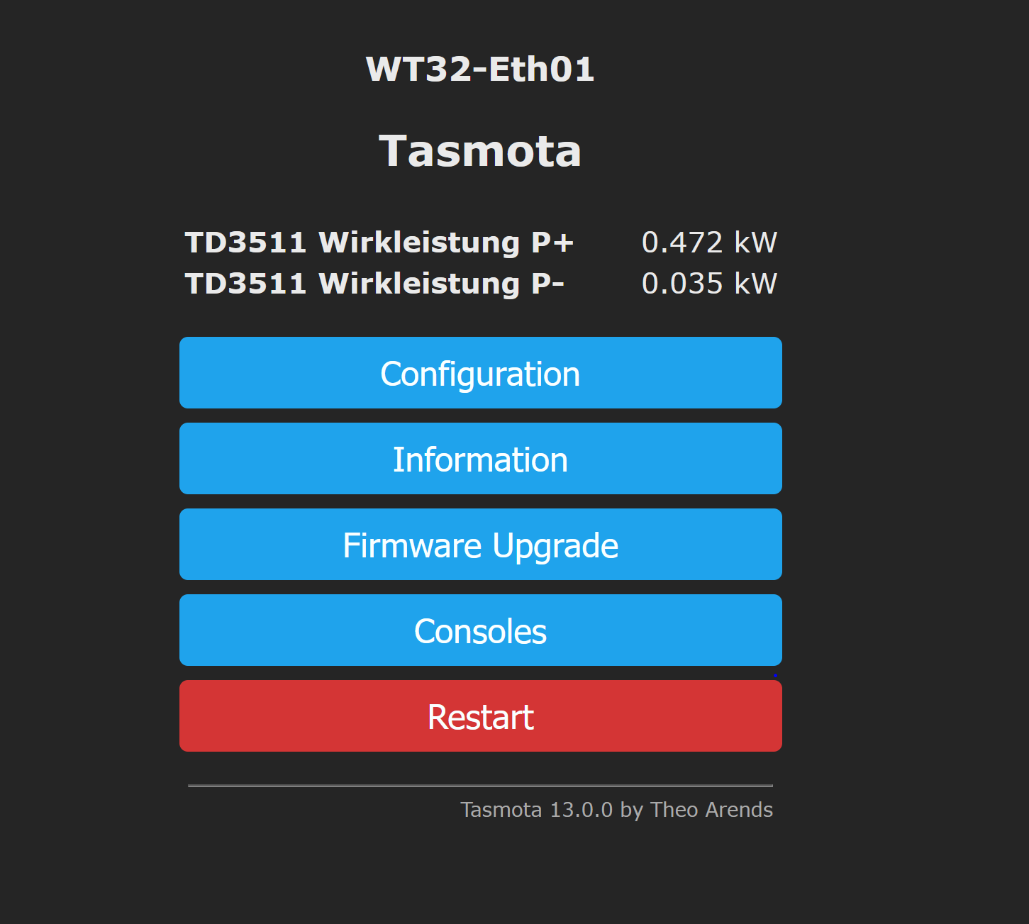

  1. Nun mit Skript 3+16:
15:39:14.376 CMD: sensor53 d1
15:42:54.871 : 1.7.0(0.117*kW)
und danach um:
15:47:13.812 : 2.7.0(0.211*kW)
Das ist ca. 5 Min.
Fazit: Immer noch 5 Min-Interval

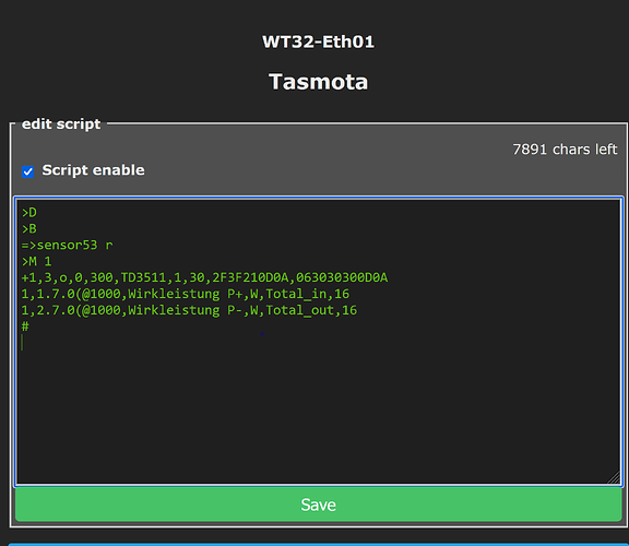

D
B
=>sensor53 r
M 1
+1,3,o,0,300,TD3511,1,30,2F3F210D0A,063030300D0A
1,1.7.0(@1000,Wirkleistung P+,W,Total_in,16
1,2.7.0(@1000,Wirkleistung P-,W,Total_out,16

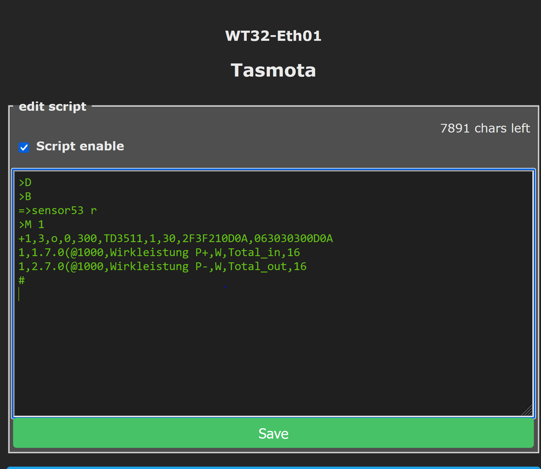

@anon58637561 Du hattest bei deinem Vorschlag in die falsche Richtung, mit *0.001 skaliert.
Noch ein Versuch:
  1. Skript:
  2. Sensor53 d1:
16:00:00.812 : 1.7.0(0.364kW)
danach um:
16:04:20.067 : 1.7.0(0.322
kW)
Neues Skript_1.txt (29,3 KB)
@ed.fischer Ok, die 16 wird also nicht angenommen. Leider kann ich deine vorigen Argumentation und Anhängen nicht folgen. Warum vergleichst du Zeitstempel von verschiedenen Werten? Ich kann einige Ausgaben nicht der Quelle zuordnen. Schwer wenn man es nicht live sehen kann.
Laut dem Skript müsste sich die Ausgabe des Zählers alle 3 Sekunden wiederholen:
Die 30 vor dem Initialisierungsstring 2F3F210D0A bedeutet 30*100ms = 3s. So steht es jedenfalls in der Tasmota Dokumentation. Probiere mal die von Hichi vorgeschlagene Zeile
+1,3,o,0,300,STROM,1,600, 2F3F210D0A
Er hat 063030300D0A nicht angegeben. Hat das funktioniert? Auf alle Fälle könnte es helfen sich näher mit dem Abfragebefehl 063030300D0A zu beschäftigen.
Bei meinen Zähler (ISKRA) brauchte ich die PIN nur, um mehr Details geliefert zu bekommen. Aber bei dir steckt das vermutlich in der Abfrage drin. Eine originale Dokumentation des Zählers wäre auf jedem Fall hilfreich.
