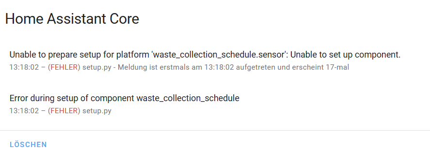

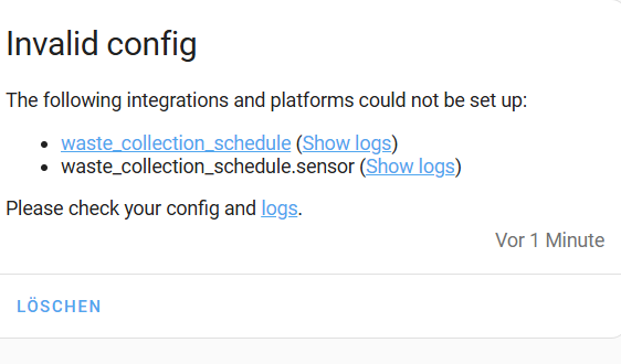

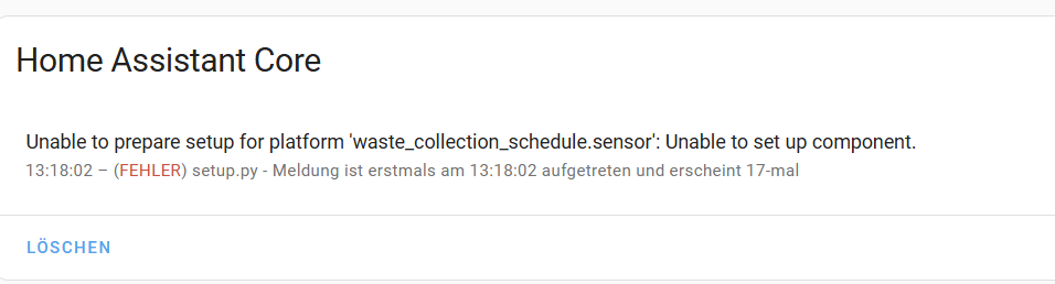

Since today, the integration is showing an invalid configuration in HomeAssistant - and won't load anymore.

```Shell
Logger: homeassistant.setup
Source: setup.py:416
First occurred: 11:39:24 AM (1 occurrences)
Last logged: 11:39:24 AM
Error during setup of component waste_collection_schedule
File "/usr/src/homeassistant/homeassistant/setup.py", line 416, in _async_setup_component
result = await task
File "/config/custom_components/waste_collection_schedule/init_yaml.py", line 109, in async_setup
await hass.async_add_executor_job(
...<6 lines>...
File "/usr/local/lib/python3.13/concurrent/futures/thread.py", line 59, in run
result = self.fn(*self.args, **self.kwargs)
File "/config/custom_components/waste_collection_schedule/waste_collection_api.py", line 88, in add_source_shell
new_shell = SourceShell.create(
source_name=source_name,
...<3 lines>...
day_offset=day_offset,
File "/config/custom_components/waste_collection_schedule/waste_collection_schedule/source_shell.py", line 217, in create
source_module: SourceModule = importlib.import_module(
f"waste_collection_schedule.source.{source_name}"
File "/usr/src/homeassistant/homeassistant/util/loop.py", line 200, in protected_loop_func
return func(*args, **kwargs)
File "/usr/local/lib/python3.13/importlib/__init__.py", line 88, in import_module
return _bootstrap._gcd_import(name[level:], package, level)
File "<frozen importlib._bootstrap>", line 1387, in _gcd_import
File "<frozen importlib._bootstrap>", line 1360, in _find_and_load
File "<frozen importlib._bootstrap>", line 1331, in _find_and_load_unlocked
File "<frozen importlib._bootstrap>", line 935, in _load_unlocked
File "<frozen importlib._bootstrap_external>", line 1026, in exec_module
File "<frozen importlib._bootstrap>", line 488, in _call_with_frames_removed
File "/config/custom_components/waste_collection_schedule/waste_collection_schedule/source/ics.py", line 16, in <module>
from waste_collection_schedule.service.ICS_v1 import ICS_v1
File "/config/custom_components/waste_collection_schedule/waste_collection_schedule/service/ICS_v1.py", line 6, in <module>
import recurring_ical_events
File "/usr/local/lib/python3.13/site-packages/recurring_ical_events.py", line 1530, in <module>
class CalendarQuery:
...<193 lines>...
raise IndexError("No components found.")
File "/usr/local/lib/python3.13/site-packages/recurring_ical_events.py", line 1547, in CalendarQuery
icalendar.InvalidCalendar,
AttributeError: module 'icalendar' has no attribute 'InvalidCalendar'
