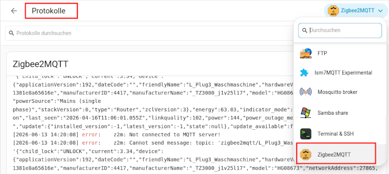

Ich habe ein Haus, die Geräte sind auch außerhalb.
[14.6.2026, 10:54:31] z2m:mqtt: MQTT publish: topic 'zigbee2mqtt/PV_West', payload '{"child_lock":"UNLOCK","countdown":0,"current":2,"energy":2747.12,"identify":null,"indicator_mode":"off/on","linkquality":45,"power":451,"power_outage_memory":"restore","state":"ON","switch_type_button":"release","update":{"installed_version":192,"latest_release_notes":null,"latest_source":null,"latest_version":192,"state":"idle"},"voltage":231}'
[14.6.2026, 10:54:31] z2m:mqtt: MQTT publish: topic 'zigbee2mqtt/PV_Ost', payload '{"child_lock":"UNLOCK","countdown":0,"current":1.93,"energy":3033.22,"identify":null,"indicator_mode":"off/on","linkquality":6,"power":435,"power_outage_memory":"restore","state":"ON","switch_type_button":null,"update":{"installed_version":77,"latest_release_notes":null,"latest_source":null,"latest_version":77,"state":"idle"},"voltage":231}'
[14.6.2026, 10:54:31] z2m:mqtt: MQTT publish: topic 'zigbee2mqtt/PV_Ost', payload '{"child_lock":"UNLOCK","countdown":0,"current":1.93,"energy":3033.22,"identify":null,"indicator_mode":"off/on","linkquality":6,"power":448,"power_outage_memory":"restore","state":"ON","switch_type_button":null,"update":{"installed_version":77,"latest_release_notes":null,"latest_source":null,"latest_version":77,"state":"idle"},"voltage":231}'
[14.6.2026, 10:54:31] z2m:mqtt: MQTT publish: topic 'zigbee2mqtt/PV_Süd', payload '{"child_lock":"UNLOCK","countdown":0,"current":2.09,"energy":3172.93,"identify":null,"indicator_mode":"off/on","linkquality":15,"power":503,"power_outage_memory":"restore","state":"ON","switch_type_button":null,"update":{"installed_version":-1,"latest_version":-1,"state":"available"},"voltage":233}'
[14.6.2026, 10:54:33] z2m:mqtt: MQTT publish: topic 'zigbee2mqtt/PV_West', payload '{"child_lock":"UNLOCK","countdown":0,"current":2,"energy":2747.12,"identify":null,"indicator_mode":"off/on","linkquality":48,"power":495,"power_outage_memory":"restore","state":"ON","switch_type_button":"release","update":{"installed_version":192,"latest_release_notes":null,"latest_source":null,"latest_version":192,"state":"idle"},"voltage":231}'
[14.6.2026, 10:54:35] z2m:mqtt: MQTT publish: topic 'zigbee2mqtt/PV_Süd', payload '{"child_lock":"UNLOCK","countdown":0,"current":2.55,"energy":3172.93,"identify":null,"indicator_mode":"off/on","linkquality":12,"power":503,"power_outage_memory":"restore","state":"ON","switch_type_button":null,"update":{"installed_version":-1,"latest_version":-1,"state":"available"},"voltage":233}'
[14.6.2026, 10:54:36] z2m:mqtt: MQTT publish: topic 'zigbee2mqtt/PV_West', payload '{"child_lock":"UNLOCK","countdown":0,"current":2.65,"energy":2747.12,"identify":null,"indicator_mode":"off/on","linkquality":48,"power":495,"power_outage_memory":"restore","state":"ON","switch_type_button":"release","update":{"installed_version":192,"latest_release_notes":null,"latest_source":null,"latest_version":192,"state":"idle"},"voltage":231}'
[14.6.2026, 10:54:36] z2m:mqtt: MQTT publish: topic 'zigbee2mqtt/PV_Ost', payload '{"child_lock":"UNLOCK","countdown":0,"current":2.57,"energy":3033.22,"identify":null,"indicator_mode":"off/on","linkquality":3,"power":448,"power_outage_memory":"restore","state":"ON","switch_type_button":null,"update":{"installed_version":77,"latest_release_notes":null,"latest_source":null,"latest_version":77,"state":"idle"},"voltage":231}'
[14.6.2026, 10:54:36] z2m:mqtt: MQTT publish: topic 'zigbee2mqtt/PV_Ost', payload '{"child_lock":"UNLOCK","countdown":0,"current":2.57,"energy":3033.22,"identify":null,"indicator_mode":"off/on","linkquality":3,"power":596,"power_outage_memory":"restore","state":"ON","switch_type_button":null,"update":{"installed_version":77,"latest_release_notes":null,"latest_source":null,"latest_version":77,"state":"idle"},"voltage":231}'
[14.6.2026, 10:54:36] z2m:mqtt: MQTT publish: topic 'zigbee2mqtt/PV_Süd', payload '{"child_lock":"UNLOCK","countdown":0,"current":2.55,"energy":3172.93,"identify":null,"indicator_mode":"off/on","linkquality":15,"power":602,"power_outage_memory":"restore","state":"ON","switch_type_button":null,"update":{"installed_version":-1,"latest_version":-1,"state":"available"},"voltage":233}'
[14.6.2026, 10:54:37] z2m:mqtt: MQTT publish: topic 'zigbee2mqtt/Hauswasserwerk', payload '{"child_lock":"UNLOCK","countdown":0,"current":0,"energy":59.32,"identify":null,"indicator_mode":"off/on","linkquality":36,"power":0,"power_outage_memory":"restore","state":"ON","switch_type_button":"release","update":{"installed_version":82,"latest_release_notes":null,"latest_source":null,"latest_version":82,"state":"idle"},"voltage":232}'
[14.6.2026, 10:54:38] z2m:mqtt: MQTT publish: topic 'zigbee2mqtt/PV_West', payload '{"child_lock":"UNLOCK","countdown":0,"current":2.65,"energy":2747.12,"identify":null,"indicator_mode":"off/on","linkquality":45,"power":556,"power_outage_memory":"restore","state":"ON","switch_type_button":"release","update":{"installed_version":192,"latest_release_notes":null,"latest_source":null,"latest_version":192,"state":"idle"},"voltage":231}'
[14.6.2026, 10:54:40] z2m:mqtt: MQTT publish: topic 'zigbee2mqtt/PV_Süd', payload '{"child_lock":"UNLOCK","countdown":0,"current":2.25,"energy":3172.93,"identify":null,"indicator_mode":"off/on","linkquality":12,"power":602,"power_outage_memory":"restore","state":"ON","switch_type_button":null,"update":{"installed_version":-1,"latest_version":-1,"state":"available"},"voltage":233}'
[14.6.2026, 10:54:40] z2m:mqtt: MQTT publish: topic 'zigbee2mqtt/PV_West', payload '{"child_lock":"UNLOCK","countdown":0,"current":2.21,"energy":2747.12,"identify":null,"indicator_mode":"off/on","linkquality":48,"power":556,"power_outage_memory":"restore","state":"ON","switch_type_button":"release","update":{"installed_version":192,"latest_release_notes":null,"latest_source":null,"latest_version":192,"state":"idle"},"voltage":231}'
[14.6.2026, 10:54:41] z2m:mqtt: MQTT publish: topic 'zigbee2mqtt/PV_Ost', payload '{"child_lock":"UNLOCK","countdown":0,"current":2.01,"energy":3033.22,"identify":null,"indicator_mode":"off/on","linkquality":0,"power":596,"power_outage_memory":"restore","state":"ON","switch_type_button":null,"update":{"installed_version":77,"latest_release_notes":null,"latest_source":null,"latest_version":77,"state":"idle"},"voltage":231}'

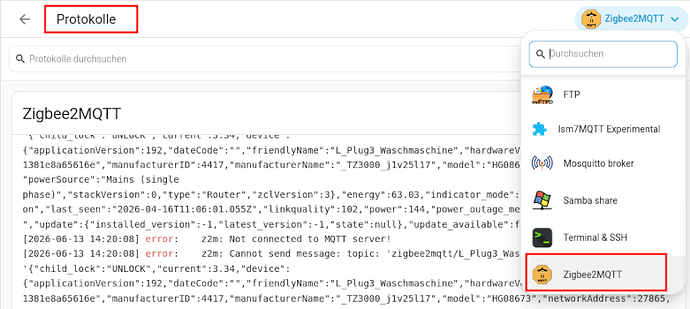

Die Geräte die Probleme machen, tauchen hier gar nicht auf.
Den Dongle habe ich:
SONOFF Zigbee 3.0 USB Dongle Plus,Zigbee Gateway TI CC2652P + CP2102N Zigbee USB Stick,Zigbee Hub für ZHA in Home Assistant or Zigbee2MQTT,Open HAB etc.

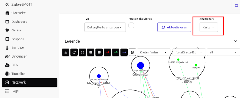

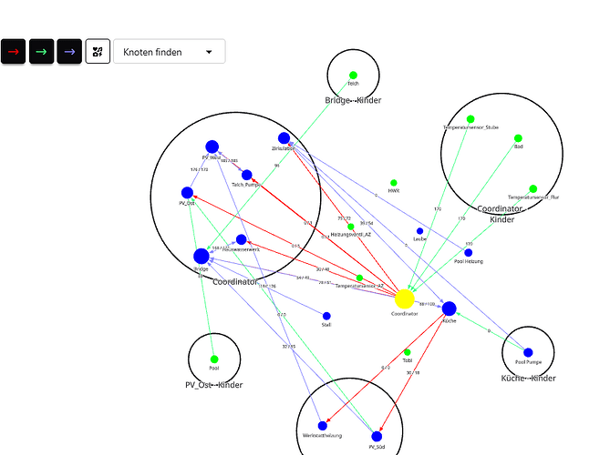

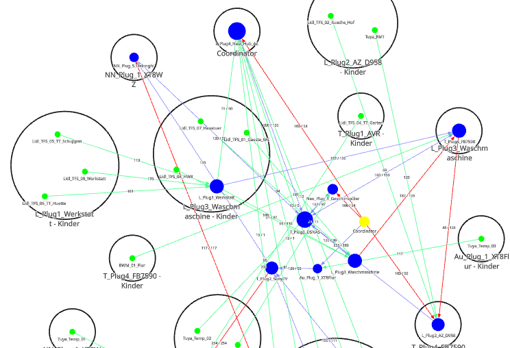

Ich sehe da etwas von PV Ost, West, Süd und außerdem Pool, Laube, Teich, Stall und Werkstatt. Das klingt für mich so als wären diese Router alle außerhalb des Hauses. Im Haus sehe ich dann nur den Coordinator und einen Router in der Küche. Sollte es im Haus wirklich nur den Coordinator und einen einzigen Router geben, dann sind dadurch schon mal Probleme vorprogrammiert. Ich hatte bei dem o.g. anderen Beitrag, bei dem Du Postings erstellt hattest, ja auch schon mal geschrieben:
“Je nach Örtlich- und Gegebenheit mind. eins besser zwei pro Raum und Flur. Über Stockwerke hinweg spielen dann eben die Flure und die möglichen Router dort eine Rolle.”
Auch wenn die Z2M Karte immer nur eine Momentaufnahme ist und man sich bekanntlich nicht darauf verlassen kann und sollte was diese so anzeigt, aber das sich unter den Bedingungen da bei Dir kein stabiles Zigbee Mesh aufbaut und aufbauen kann, ist sehr wahrscheinlich. Das es jetzt nach dem Z2M Update (wieder) zu Problemen kommt dürfte wohl eher nur Zufall sein.
Dir bleibt jetzt die Wahl: Entweder glaubst Du (weiterhin) das das Z2M Update Ursache für Deine aktuellen Probleme ist und versuchst Dein Glück mit irgendeinem Downgrade, oder Du baust Dein Zigbee Mesh mit zusätzlichen aktiven Geräten und somit auch Routen-Möglichkeiten, so aus das es möglichst stabil funktioniert, bzw. funktionieren kann. Mehr kann ich dazu dann auch nicht sagen. Einfach weil ich Deine Örtlichkeiten halt nicht kenne und eben auch nicht weiß ob da ggf. auch sonst noch irgendwelche Besonderheiten eine Rolle spielen könnten.
Aber die Temperatursensoren sind alle im Haus und alle mit mal ausgefallen, teilweise nur 1 m vom Dongle entfernt.

Ich bin da ganz bei @Jim_OS , die Probleme kommen vermutlich, weil du keine Zigbee Router im Haus verteilt hast.
Und wenn du neue Router ins Mesh bringst, auf jeden Fall die Aqara Batteriegeräte neu pairen.
Und vielleicht dazu auch noch die Erklärung: Weil Aqara Geräte bekannt dafür sind ganz gerne mal an einmal gewählten Routen “kleben zu bleiben” :laughing: und diese dann nicht mehr - wie es in einem Zigbee Mesh eigentlich vorgesehen ist - auch selbstständig wieder zu wechseln.

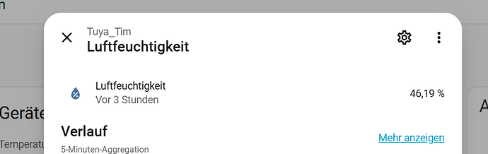

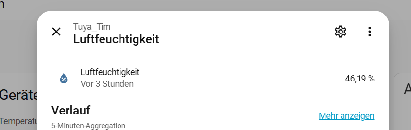

Ich habe das Problem dass meine Tuya Temperatursensoren nur ganz sporadisch Werte liefern aber im Netzwerk permanent als “verfügbar” angezeigt werden. Anbei das Netzwerk, Router sind ein paar verteilt:
3h nur weil ich hier ein Update instilliert habe und neustart danach war… teilweise stehen hier 2 Wochen.

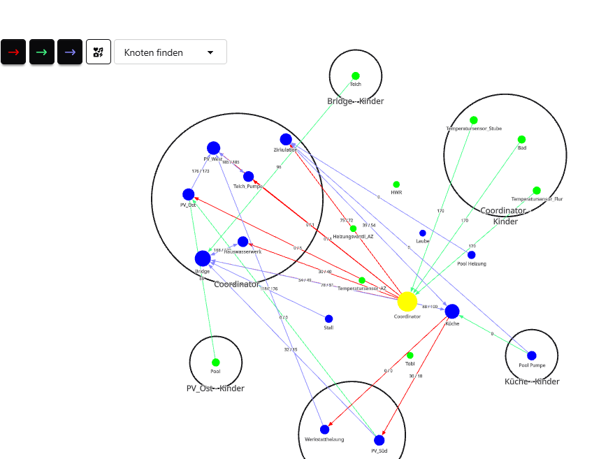

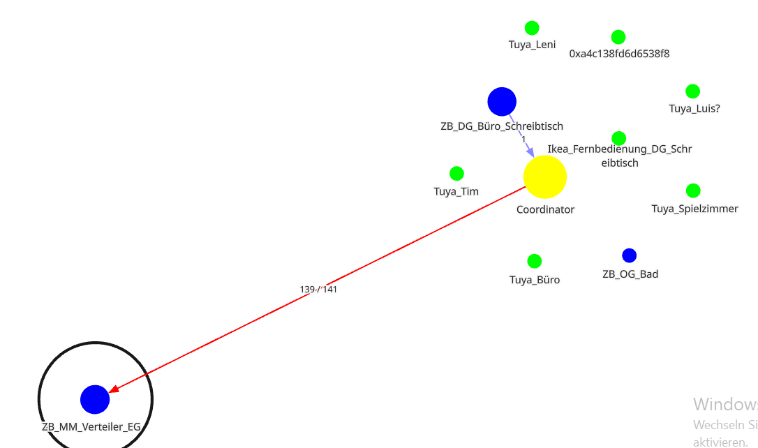

Du hast vermutlich auch gar keine Zigbee Router im Mesh, oder?
Auf das was da in einem Zigbee Mesh als verfügbar eingezeigt wird, oder auch nicht, kann man sich nicht wirklich verlassen.
Zu denen, lt. Deinem ersten Screenshot, aber eben wohl keine Verbindungen bestehen.
So in der Art sollte/könnte ein Zigbee Mesh z.B. aussehen, bei dem es dann in dem Beispiel ca. 20 Zigbee Endgeräte und ca. 20 Zigbee Router gibt.
Ich denke der Unterschied zu Deinem ersten Screenshot dürfte klar sein. :slightly_smiling_face:

Solange man die Verfügbarkeit nicht aktiviert, werden die Sensoren für immer und ewig als Verfügbar gelistet. :wink:
Bei aktivierter Verfügbarkeit wird nach definierter Zeit ein Sensor als nicht verfügbar gelistet, wenn er in dieser Zeit keine Lebenszeichen von sich gegeben hat.
