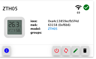

I have a problem with this sensor . i have full update a this day.
Zigbee2mqtt Edge , Home Assistant , lastet versions .
