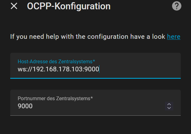

ich versuche mich auch gerade an der Einbindung der Vestel Box in HA.
In der Box habe ich so weit alle eingestellt. Nun scheiter es aber mit OCPP.
Meine Einstellungen
Dies sind wie in der Box.
Und noch die Protokolldatei
Logger: homeassistant.config_entries
Quelle: config_entries.py:762
Erstmals aufgetreten: 13:09:21 (1 Vorkommnis)
Zuletzt protokolliert: 13:09:21
Error setting up entry central for ocpp
File “/usr/src/homeassistant/homeassistant/config_entries.py”, line 762, in \__async_setup_with_context
result = await component.async_setup_entry(hass, self)
File “/config/custom_components/ocpp/**init**.py”, line 106, in async_setup_entry
central_sys = await CentralSystem.create(hass, entry)
File “/config/custom_components/ocpp/api.py”, line 184, in create
server = await websockets.serve(
…<9 lines>…
File “/usr/local/lib/python3.13/site-packages/websockets/asyncio/server.py”, line 831, in **await_impl**
server = await self.create_server
File “/usr/local/lib/python3.13/asyncio/base_events.py”, line 1581, in create_server
infos = await tasks.gather(\*fs)
File “/usr/local/lib/python3.13/asyncio/base_events.py”, line 1512, in \_create_server_getaddrinfo
infos = await self.\_ensure_resolved((host, port), family=family,
type=socket.SOCK_STREAM,
flags=flags, loop=self)
File “/usr/local/lib/python3.13/asyncio/base_events.py”, line 1508, in \_ensure_resolved
return await loop.getaddrinfo(host, port, family=family, type=type,
proto=proto, flags=flags)
File “/usr/local/lib/python3.13/asyncio/base_events.py”, line 939, in getaddrinfo
return await self.run_in_executor(
None, getaddr_func, host, port, family, type, proto, flags)
File “/usr/local/lib/python3.13/concurrent/futures/thread.py”, line 59, in run
result = self.fn(\*self.args, \*\*self.kwargs)
File “/usr/local/lib/python3.13/socket.py”, line 977, in getaddrinfo
for res in \_socket.getaddrinfo(host, port, family, type, proto, flags):
socket.gaierror: \[Errno -2\] Name does not resolve
Wer kann helfen?
Keine Ahnung, ob du dein Problem schon lösen konntest. Aber bei der Host-Adresse des Zentralsystems am besten 0.0.0.0 eintragen, dann kannst du alle ipv4 Adressen deine HA nutzen.
ws:// und :9000 weglassen!!!
