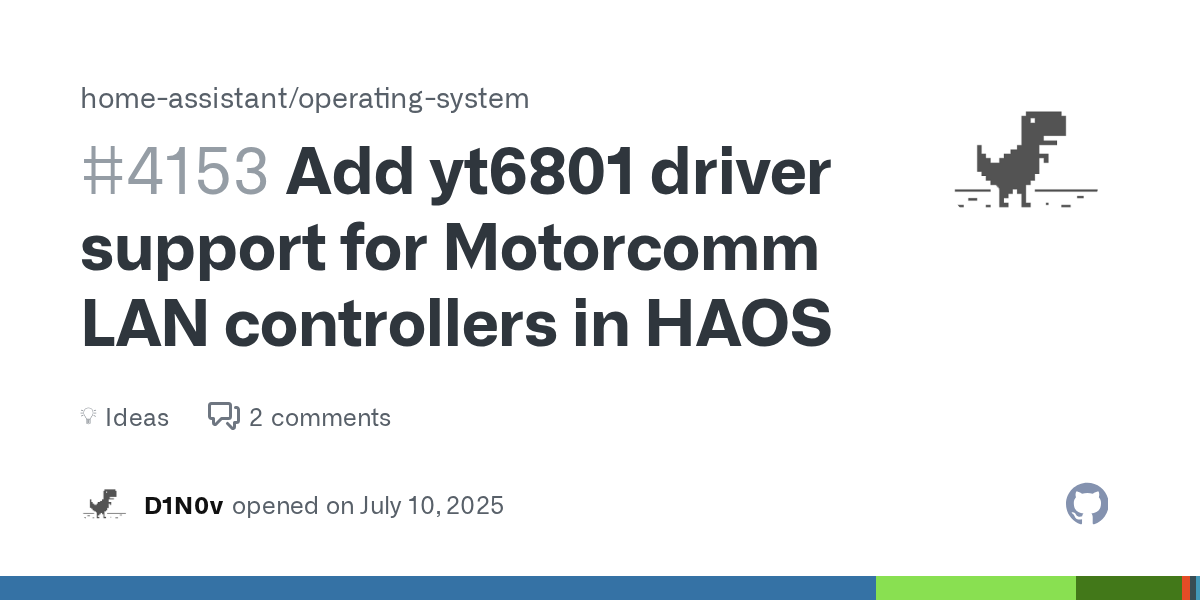

Wenn ich das richtig sehe sieht es bisher wohl eher schlecht aus was die Treiber anbelangt, denn:
I am sorry, but I’ll disappoint you here. With some very rare exceptions, HAOS only uses mainline Linux drivers. And even in those exceptions, the drivers have proper open source license, so there is no legal compliance issue when including it in our project.
Und:
There is still no yt6801 driver in mainline. Last update I can find is from April where the Motorcomm team decided to suspend the upstreaming effort.
Quellen:
Anm.: Das ist nur das Ergebnis einer schnellen und kurzen Suche per Google.
