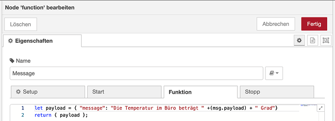

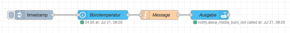

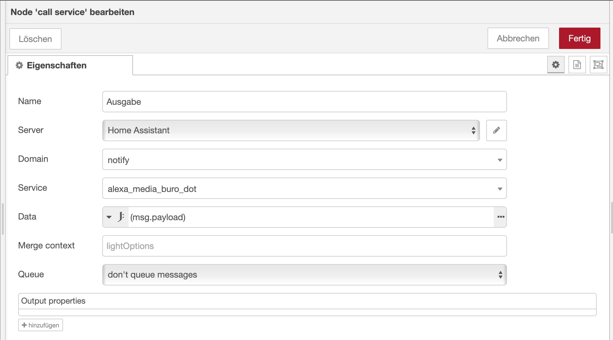

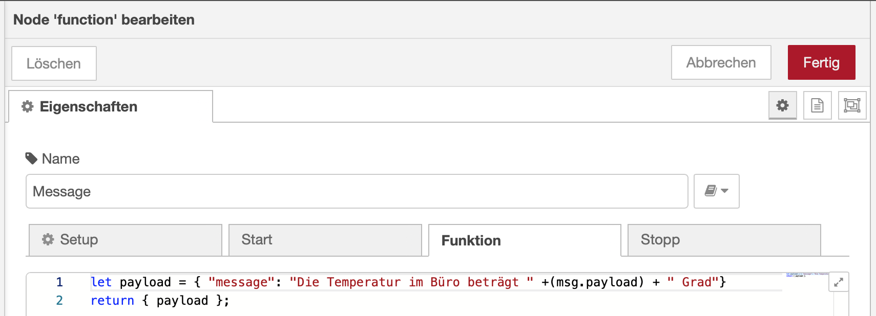

Da wirst den “Umweg” über eine “function-node” gehen müssen und für die Sprachausgabe die
normale “Call-service-node” verwenden.
Hier der Flow:
und als Code:
[{"id":"2776d3a90674c078","type":"tab","label":"Flow 1","disabled":false,"info":"","env":[]},{"id":"2da8a6ad1cf26b8c","type":"inject","z":"2776d3a90674c078","name":"","props":[{"p":"payload"},{"p":"topic","vt":"str"}],"repeat":"","crontab":"","once":false,"onceDelay":0.1,"topic":"","payload":"","payloadType":"date","x":420,"y":160,"wires":[["e26e1eb4ca293525"]]},{"id":"e26e1eb4ca293525","type":"api-current-state","z":"2776d3a90674c078","name":"Bürotemperatur","server":"a1aba8eb.bfd618","version":3,"outputs":1,"halt_if":"","halt_if_type":"num","halt_if_compare":"is","entity_id":"sensor.buro_temperature","state_type":"num","blockInputOverrides":false,"outputProperties":[{"property":"payload","propertyType":"msg","value":"","valueType":"entityState"},{"property":"data","propertyType":"msg","value":"","valueType":"entity"}],"for":"0","forType":"num","forUnits":"minutes","override_topic":false,"state_location":"payload","override_payload":"msg","entity_location":"data","override_data":"msg","x":640,"y":160,"wires":[["870121a322a111ea"]]},{"id":"97b4e21b4cdcc67e","type":"api-call-service","z":"2776d3a90674c078","name":"Ausgabe","server":"a1aba8eb.bfd618","version":5,"debugenabled":true,"domain":"notify","service":"alexa_media_buro_dot","areaId":[],"deviceId":[],"entityId":[],"data":"(msg.payload)","dataType":"jsonata","mergeContext":"","mustacheAltTags":false,"outputProperties":[],"queue":"none","x":980,"y":160,"wires":[[]]},{"id":"870121a322a111ea","type":"function","z":"2776d3a90674c078","name":"Message","func":"let payload = { \"message\": \"Die Temperatur im Büro beträgt \" +(msg.payload) + \" Grad\"}\nreturn { payload };","outputs":1,"noerr":0,"initialize":"","finalize":"","libs":[],"x":820,"y":160,"wires":[["97b4e21b4cdcc67e"]]},{"id":"a1aba8eb.bfd618","type":"server","name":"Home Assistant","version":5,"addon":true,"rejectUnauthorizedCerts":true,"ha_boolean":"y|yes|true|on|home|open","connectionDelay":true,"cacheJson":true,"heartbeat":false,"heartbeatInterval":30,"areaSelector":"friendlyName","deviceSelector":"friendlyName","entitySelector":"friendlyName","statusSeparator":"at: ","statusYear":"hidden","statusMonth":"short","statusDay":"numeric","statusHourCycle":"h23","statusTimeFormat":"h:m","enableGlobalContextStore":true}]

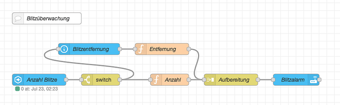

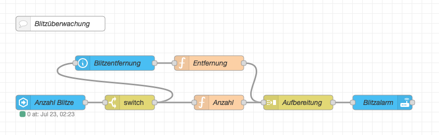

Du kannst den oben gezeigten FLOW für mehrere Sensoren parallel aufbauen und anschließend in einer “function-node” die Nachrichten Zusammenführer.
Hier ein Beispiel von mir mit 2 Sensoren:
in der ich für die Blitzüberwachung die Anzahl der Blitze und deren Entfernung in eine Nachricht zusammenführe.

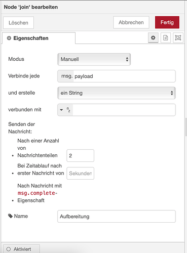

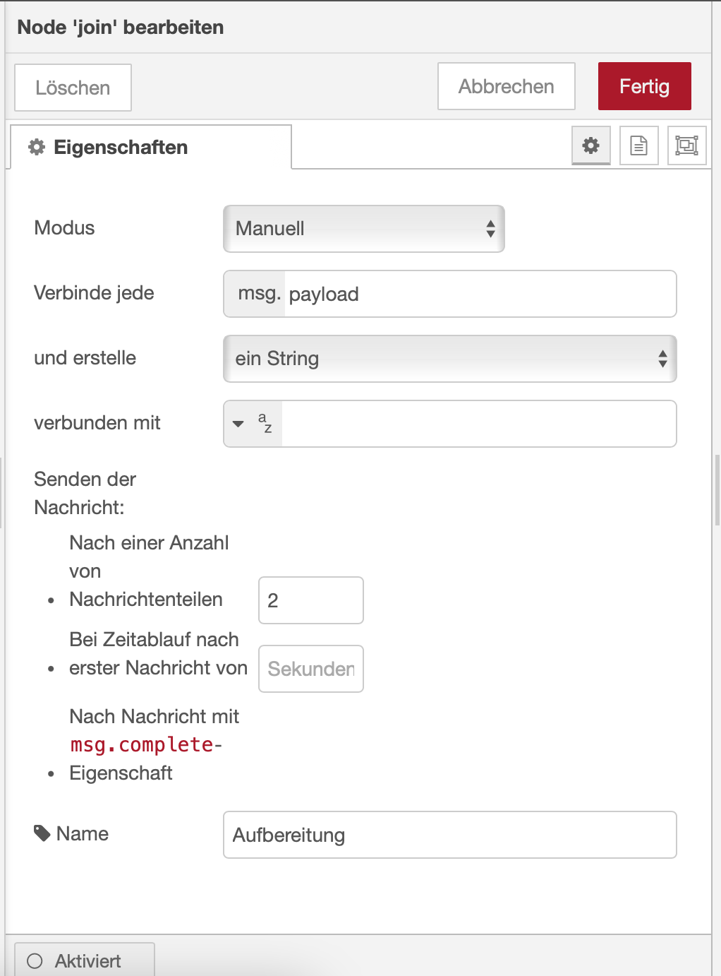

Hier noch die “join-Node” für die “Zusammenführung”:

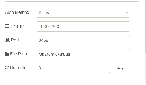

hast du bei deiner Einstellungen des Alexa Accounts, zum speichern des Accounts auch den File Path genommen?
Falls ja, kannst du mir sagen was du dort eingetragen hast?
Ich habe dort /config/node-red/amazon.txt eingetragen aber leider ohne Erfolg.
Danke.
nein das ist hier der Ordner
