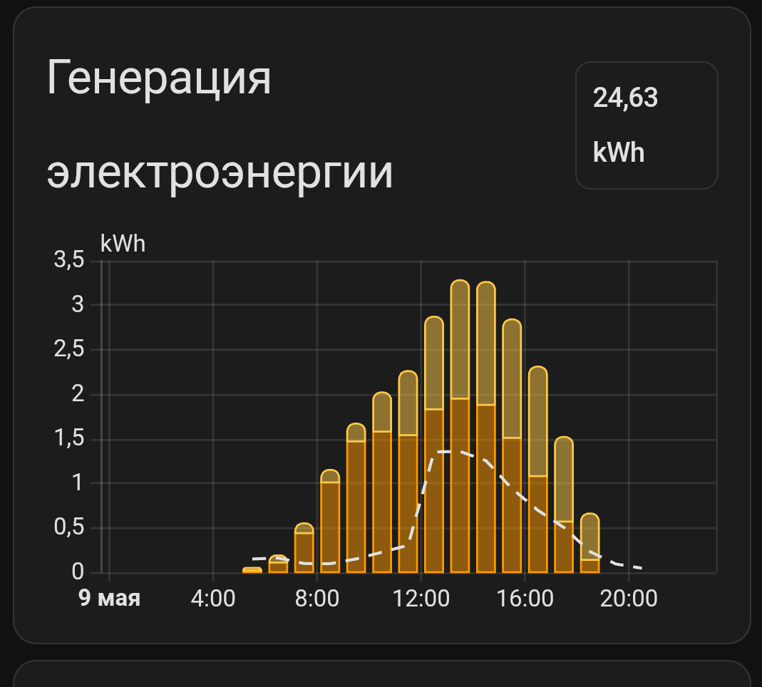

So, I fixed the problem with the solar power sensor for battery charging. It really was a problem. Last week, the accuracy was excellent, but the weather was very stable. Today, the weather started to change, and instead of the predicted 7 kW, I got 24 kW. Judging by the readings for tomorrow, it will be the same.
I don’t quite understand what information I need to provide and where to get it
