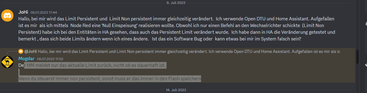

Mal ne andere Frage an alle: Werden bei euch auch das “persistant limit” mit geĂ€ndert oder nur das non-persistant limit? Bei mir wird beides immer gleich geĂ€ndert und ich meine mal gelesen zu haben, das wĂ€re nicht so gut. Kann das mal jemand ĂŒberprĂŒfen? Danke
Ich hatte mal die gleiche Frage in Github gestellt. Die Antwort war dass bei Aenderung vo ’ Non Persistent Limit: Im Wechselrichter auch nur Non Persistent geĂ€ndert wird aber in OpenDTU der Wert beider geĂ€ndert erscheint.
War in Discord:
1 „GefĂ€llt mir“

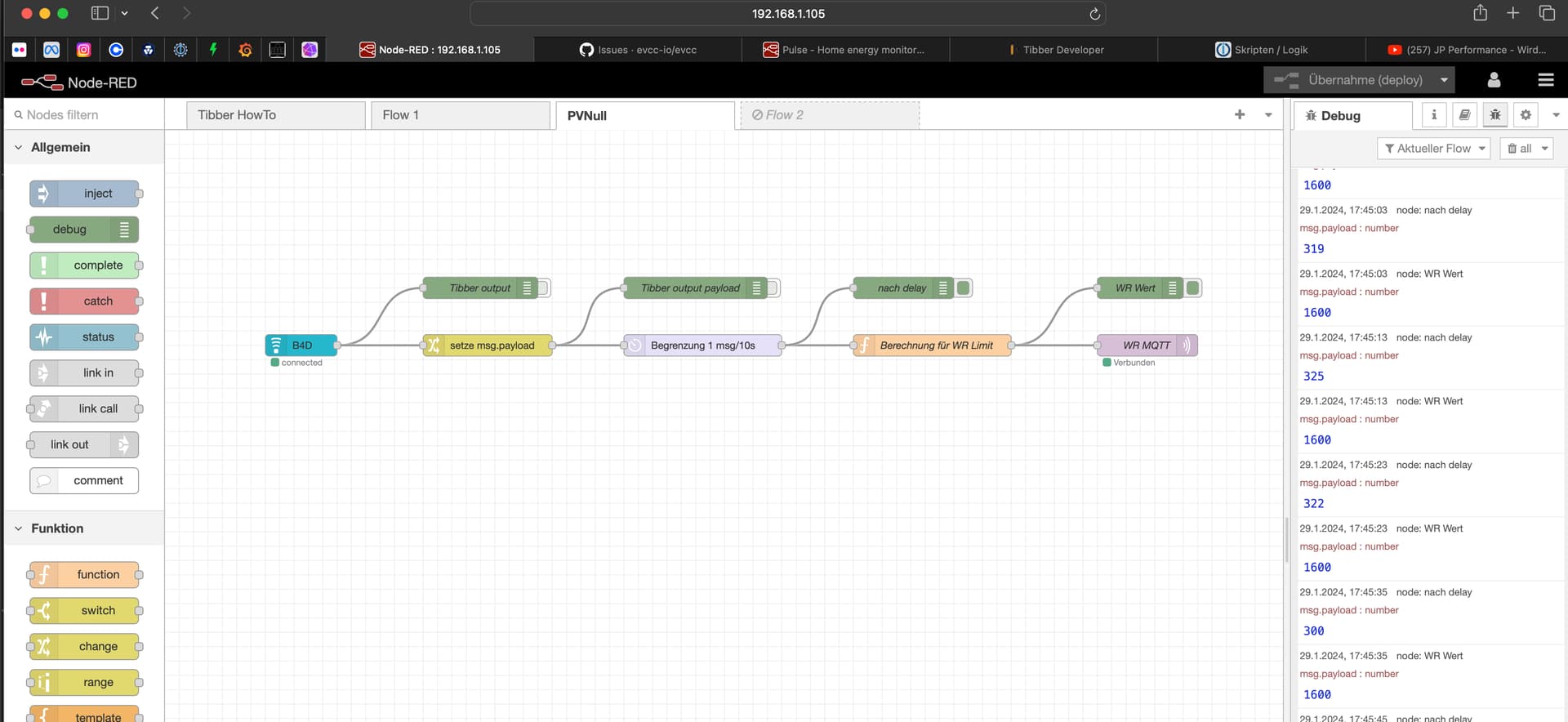

mein Setup:
Tibber Puls
HMS-1600
OpenDTU
        "id": "7bf3afac51a18e13",
        "type": "tab",
        "label": "PVNull",
        "disabled": false,
        "info": "",
        "env": []
        "id": "2dacc22b5419c832",
        "type": "mqtt out",
        "z": "7bf3afac51a18e13",
        "name": "WR MQTT",
        "topic": "solar/116484658617/cmd/limit_nonpersistent_absolute",
        "qos": "",
        "retain": "",
        "respTopic": "",
        "contentType": "",
        "userProps": "",
        "correl": "",
        "expiry": "",
        "broker": "87b2d138566ff5cc",
        "x": 1370,
        "y": 300,
        "wires": []
        "id": "992140f008964c0e",
        "type": "function",
        "name": "Berechnung fĂŒr WR Limit",
        "func": "// MAX generation of the inverter Watts\nvar maxPower = 1600;\n\n// Get current power limit or default\nvar power = context.get('power') || maxPower;\npower += msg.payload;\n\n// clamp power between 0 and max\nif (power > maxPower) power = maxPower;\nif (power < 10) power = 1;\n\n\n// store current powerlimit and update message\ncontext.set('power', power);\nmsg.payload = power;\n\nreturn msg;",
        "outputs": 1,
        "timeout": "",
        "noerr": 0,
        "initialize": "",
        "finalize": "",
        "libs": [],
        "x": 1070,
        "y": 300,
        "wires": [
                "cfc7a51cd2515e7c",
                "2dacc22b5419c832"
        "id": "cfc7a51cd2515e7c",
        "type": "debug",
        "name": "WR Wert",
        "active": true,
        "tosidebar": true,
        "console": false,
        "tostatus": false,
        "complete": "payload",
        "targetType": "msg",
        "statusVal": "",
        "statusType": "auto",
        "x": 1360,
        "y": 220,
        "wires": []
        "id": "7c9607b020e57be9",
        "type": "tibber-feed",
        "z": "7bf3afXXXXXXXXXXX",
        "name": "B4D",
        "active": true,
        "apiEndpointRef": "acaea9118c2d1751",
        "homeId": "6453fa8f-XXXXXXXXXXX",
        "timestamp": false,
        "power": "1",
        "lastMeterConsumption": false,
        "accumulatedConsumption": false,
        "accumulatedProduction": false,
        "accumulatedConsumptionLastHour": false,
        "accumulatedProductionLastHour": false,
        "accumulatedCost": false,
        "accumulatedReward": false,
        "currency": false,
        "minPower": false,
        "averagePower": false,
        "maxPower": false,
        "powerProduction": false,
        "minPowerProduction": false,
        "maxPowerProduction": false,
        "lastMeterProduction": false,
        "powerFactor": false,
        "voltagePhase1": false,
        "voltagePhase2": false,
        "voltagePhase3": false,
        "currentL1": false,
        "currentL2": false,
        "currentL3": false,
        "signalStrength": false,
        "x": 190,
        "y": 300,
        "wires": [
                "303c3a9e684e3aca",
                "727ade03c58e2d2b"
        "id": "303c3a9e684e3aca",
        "type": "debug",
        "name": "Tibber output",
        "active": false,
        "tosidebar": true,
        "console": false,
        "tostatus": false,
        "statusVal": "",
        "x": 440,
        "y": 220,
        "wires": []
        "id": "f2cca6ecae7ad5fc",
        "type": "debug",
        "name": "Tibber output payload",
        "active": false,
        "tosidebar": true,
        "console": false,
        "tostatus": false,
        "statusVal": "",
        "x": 740,
        "y": 220,
        "wires": []
        "id": "727ade03c58e2d2b",
        "type": "change",
        "name": "",
        "rules": [
                "t": "set",
                "p": "payload",
                "pt": "msg",
                "to": "payload.power",
                "tot": "msg"
        "action": "",
        "property": "",
        "from": "",
        "to": "",
        "reg": false,
        "x": 450,
        "y": 300,
        "wires": [
                "f2cca6ecae7ad5fc",
                "52b31c00780196ab"
        "id": "52b31c00780196ab",
        "type": "delay",
        "name": "",
        "pauseType": "rate",
        "timeout": "10",
        "timeoutUnits": "seconds",
        "rate": "1",
        "nbRateUnits": "10",
        "rateUnits": "second",
        "randomFirst": "1",
        "randomLast": "5",
        "randomUnits": "seconds",
        "drop": true,
        "allowrate": false,
        "outputs": 1,
        "x": 750,
        "y": 300,
        "wires": [
                "992140f008964c0e",
                "aed44dec4557ee97"
        "id": "aed44dec4557ee97",
        "type": "debug",
        "name": "nach delay",
        "active": true,
        "tosidebar": true,
        "console": false,
        "tostatus": false,
        "statusVal": "",
        "x": 1030,
        "y": 220,
        "wires": []
        "id": "87b2d138566ff5cc",
        "type": "mqtt-broker",
        "name": "",
        "broker": "192.168.1.2",
        "port": "1883",
        "clientid": "",
        "autoConnect": true,
        "usetls": false,
        "protocolVersion": "4",
        "keepalive": "60",
        "cleansession": true,
        "autoUnsubscribe": true,
        "birthTopic": "",
        "birthQos": "0",
        "birthPayload": "",
        "birthMsg": {},
        "closeTopic": "",
        "closeQos": "0",
        "closePayload": "",
        "closeMsg": {},
        "willTopic": "",
        "willQos": "0",
        "willPayload": "",
        "willMsg": {},
        "userProps": "",
        "sessionExpiry": ""
        "id": "acaea9118c2d1751",
        "type": "tibber-api-endpoint",
        "queryUrl": "https://api.tibber.com/v1-beta/gql",
        "feedConnectionTimeout": "30",
        "feedTimeout": "60",
        "queryRequestTimeout": "30",
        "name": "B4D"

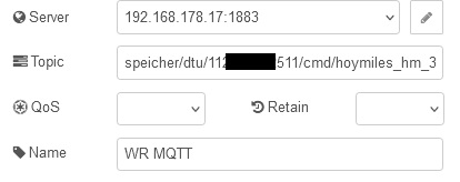

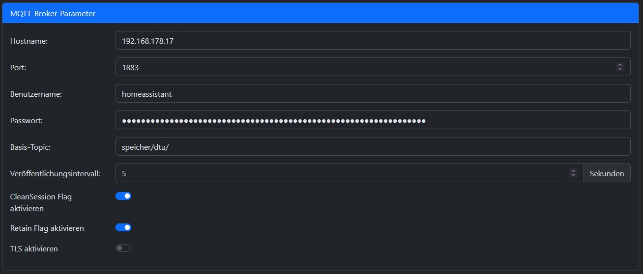

Hallo an alle,
vielleicht kann mir jemand weiterhelfen.
Nutze Node-Red zum ersten mal im Home Assistant und komme mit der Konfiguration noch nicht klar.
Meine Konfiguration:
Shelly 3EM
Hoymiles HM-300
24V Lifepo4 Akku (3,6V x 8 Zellen)
Der Akku ist am Hoymiles angeschlossen, OpenDTU lÀuft auch und die MQTT Verbindung zu HA habe ich auch. Ich kann alle Daten vom Wechselrichter sehen, die WR-Leistung regeln usw. Das funktioniert alles.
Allerdings bekomme ich im Node-Red keine Verbindung zum Wechselrichter.
Hier ein paar Screenshots von den DTU und Node-Red Einstellungen:
NodeRed_MQTT
Bei dem WR MQTT Node habe ich meine Seriennummer und das topic aus OpenDTU eingetragen. Trotzdem steht dort immer “Verbindung wird hergestellt”
Kann mir jemand weiterhelfen, was ich falsch mache ?
Edit:
Hier noch ein Auszug vom Node-Red log:
[mqtt-broker:87b2d138566ff5cc] Connection failed to broker: mqtt://192.168.178.17:1883
Danke und Gruß
Thomas

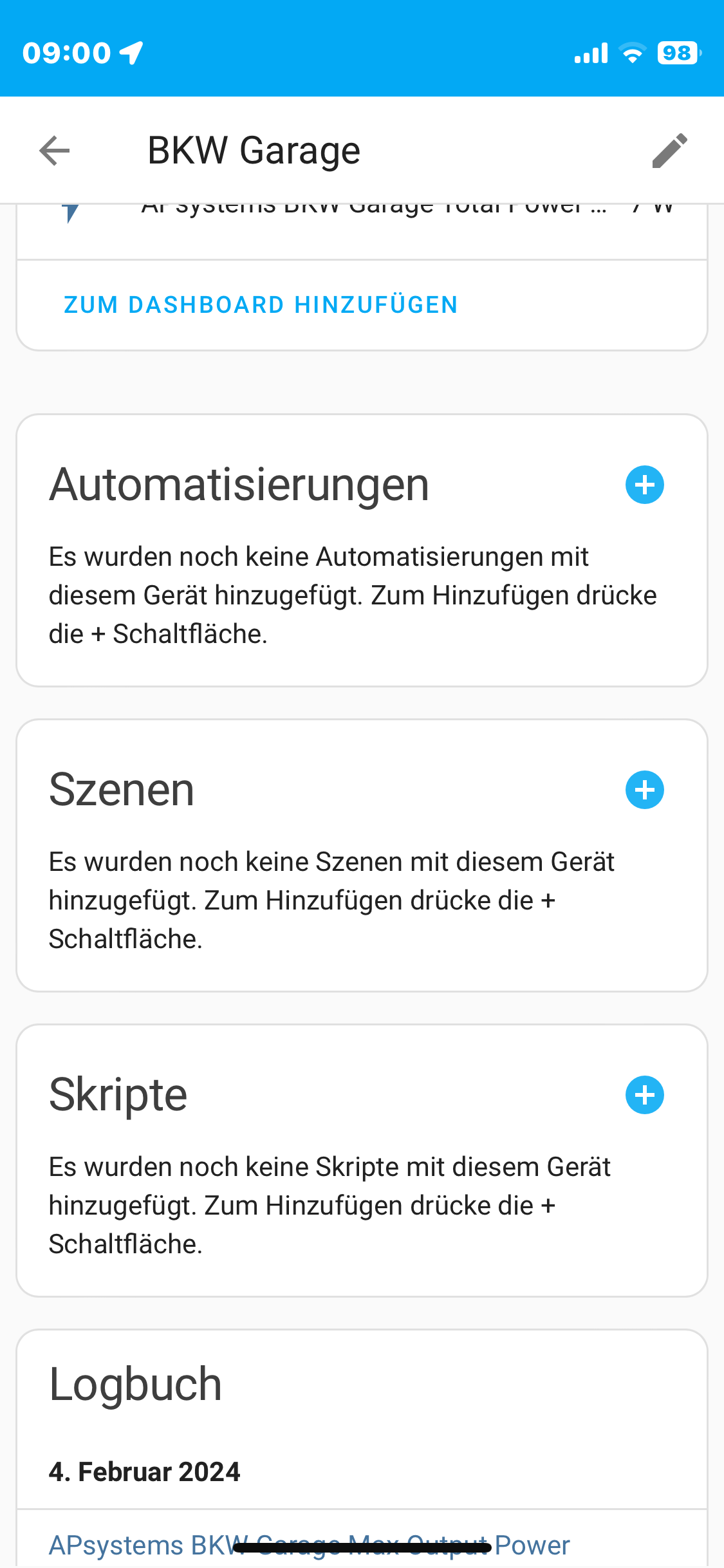

Hallo in die Runde.
Ich bin in Sachen Home Assistent und Node Red noch sehr unerfahren. Ich habe diesen Flow mal bei mir eingegeben. Mit meinen IR Lesekopf klappte es wunderbar. Nur mein Wechselrichter funktioniert dort nicht. Ich haben einen Apsyszems EZ1. Ich vermute das er kein MQTT hat. Gibt es eine andere Möglichkeit ihn anzusteuern ?

Moin berowicz,

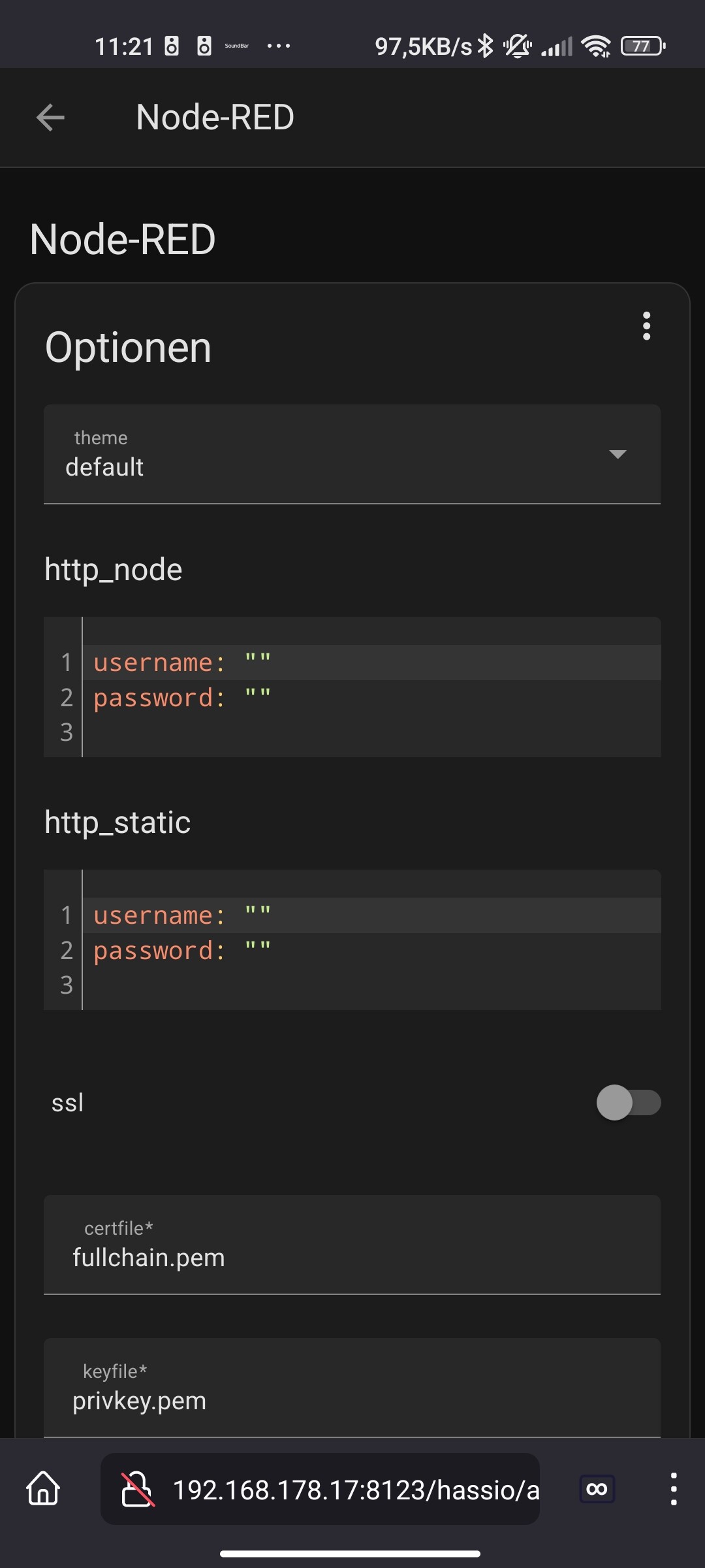

du musst auch in Node Red beim mqtt-Server den Benutzernamen und das Passwort eintragen, hast du das gemacht?
GrĂŒĂŸe
LL
Die HA-Integration ist hier beschrieben, aus meiner Sicht auch fĂŒr AnfĂ€nger geeignet.

Das habe ich schon gemacht. In Homeassistent ist mein Wechselrichter integriert und auch einsehbar. Zudem diese ich meinen ZĂ€hlerstand ĂŒber einen Tasmota ab. Dieser ist auch schon im HA drin. Nur wo muss ich jetzt was machen um eine Nulleinspeisung zu bekommen ? Muss ich dann, wenn ich auf der API Seite des WR bin unter Skripte
das Python Skript hinzufĂŒgen von dem er in dem Video spricht ? Vor ein paar Tagen konnte ich nirgendwo was eintragen. Es ist immer eine Art Fehlermeldung gekommen. Jetzt wenn ich Skripte öffne, steht zumindest was.

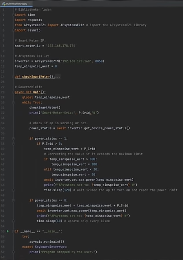

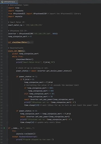

Ich habe glaube, so langsam könnte Licht ins Dunkel kommen :joy:. Wie schon gesagt, ich beschĂ€fftige mich da seit einer Woche etwa mit. Ist alles noch sehr kompliziert fĂŒr mich.
Nachtrag:
Habe mir das Video nochmals angeschaut. Habe von dem Script ein Screenshot gemacht. Muss das dann in HA unter Skripte hinzugefĂŒgt werde ?
:crayon:by HarryP:
ZusammenfĂŒhrung Doppelpost
Codezeilen besser ĂŒber </> (s.o.) einfĂŒgen als mit screenshot
Meinst du hier? Bei beiden? Also node und static?
Das ist dann der Benutzer fĂŒr MQTT, den ich unter “Benutzer” bei Home Assistant angelegt habe?
Danke und Gruß
