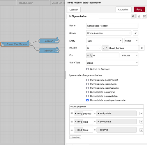

Danke für den Tip. Ich hab sowieso gemerkt das ich da ein paar Fehler drin hatte und das ganze nochmal neu erstellt. Leider macht es noch nicht das was es soll. Die Rollos gingen nicht runter. Das mit dem testen hab ich auch ausprobiert und es hat mir eigentlich angezeigt, da die Rollos schon zu waren, das es die schliessen wollte. Mal sehen ob die morgen früh wieder hochgehen. Ist halt immer Versuch und Irrtum wenn man von dem ganzen nicht so viel Ahnung hat, aber man kann ja alles lernen.

[{"id":"48b1f2c163bd4291","type":"tab","label":"Rollo morgens/abends","disabled":false,"info":"","env":[]},{"id":"56fdddc62c91ec58","type":"comment","z":"48b1f2c163bd4291","name":"Rollosteuerung auf/zu","info":"","x":160,"y":100,"wires":[]},{"id":"6612574d06c2591a","type":"api-call-service","z":"48b1f2c163bd4291","name":"Rollo zu","server":"49761872cda20bfb","version":5,"debugenabled":false,"domain":"cover","service":"close_cover","areaId":["wohnzimmer"],"deviceId":[],"entityId":["cover.rollos_wohnzimmer"],"data":"","dataType":"jsonata","mergeContext":"","mustacheAltTags":false,"outputProperties":[],"queue":"none","x":520,"y":320,"wires":[[]]},{"id":"7970fcd1ee76c588","type":"api-call-service","z":"48b1f2c163bd4291","name":"Rollo auf","server":"49761872cda20bfb","version":5,"debugenabled":false,"domain":"cover","service":"open_cover","areaId":["wohnzimmer"],"deviceId":[],"entityId":["cover.rollos_wohnzimmer"],"data":"","dataType":"jsonata","mergeContext":"","mustacheAltTags":false,"outputProperties":[],"queue":"none","x":520,"y":200,"wires":[[]]},{"id":"71d721ce5fa80806","type":"server-state-changed","z":"48b1f2c163bd4291","name":"Rollos auf/zu","server":"49761872cda20bfb","version":5,"outputs":2,"exposeAsEntityConfig":"","entityId":"sun.sun","entityIdType":"exact","outputInitially":false,"stateType":"str","ifState":"above_horizont","ifStateType":"str","ifStateOperator":"is","outputOnlyOnStateChange":true,"for":"0","forType":"num","forUnits":"minutes","ignorePrevStateNull":false,"ignorePrevStateUnknown":false,"ignorePrevStateUnavailable":false,"ignoreCurrentStateUnknown":false,"ignoreCurrentStateUnavailable":false,"outputProperties":[{"property":"payload","propertyType":"msg","value":"","valueType":"entityState"},{"property":"data","propertyType":"msg","value":"","valueType":"eventData"},{"property":"topic","propertyType":"msg","value":"","valueType":"triggerId"}],"x":170,"y":260,"wires":[["7970fcd1ee76c588"],["6612574d06c2591a"]]},{"id":"49761872cda20bfb","type":"server","name":"Home Assistant","version":5,"addon":false,"rejectUnauthorizedCerts":true,"ha_boolean":"y|yes|true|on|home|open","connectionDelay":true,"cacheJson":true,"heartbeat":false,"heartbeatInterval":"30","areaSelector":"id","deviceSelector":"id","entitySelector":"id","statusSeparator":"at: ","statusYear":"hidden","statusMonth":"short","statusDay":"numeric","statusHourCycle":"h23","statusTimeFormat":"h:m","enableGlobalContextStore":true}]
Ich muss mal sehen ob da nicht noch hinter dem jeweiligen hoch oder runter ein Stop angehangen werden muss, weil die zwar runtergefahren sind aber nicht wieder hoch. Mal sehen wie die sich heute verhalten.
Rollo hat wieder nicht geöffnet. Hab das ganze jetzt mal als zwei Teile gemacht, damit ich sehe ob das überhaupt funktioniert. Also einmal für auf und einmal für zu. Ich muss schon sagen das sehr viele mit node-red arbeiten und sehr komplizierte Programmierungen vornehmen, aber für die einfachen Sachen hat noch keiner so richtig was gemacht oder in einem Video das erklärt, schade… Ich werd ma weiter versuchen mich durch node-red ein zu arbeiten, vielleicht versteh ich es irgendwann.
