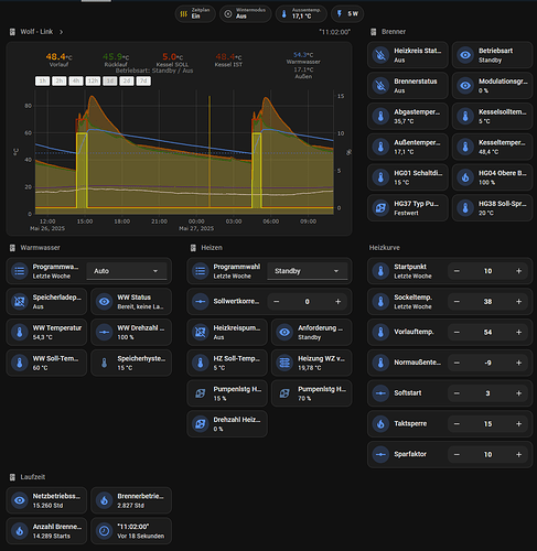

Ja klar, kein Problem - hier, um es für mich einfach zu machen, der yaml-Code dieses Dashboards:
  - type: sections
    path: tob
    max_columns: 3
    title: TOB
    sections:
      - type: grid
        cards:
          - type: heading
            icon: mdi:fridge
            heading: Wolf - Link
            heading_style: subtitle
            badges:
              - type: entity
                show_state: true
                show_icon: false
                entity: sensor.wolf_bm2_0x30_220032_uhrzeit
                state_content: state
            tap_action:
              action: url
              url_path: http://192.168.178.208
          - type: horizontal-stack
            cards:
              - type: custom:plotly-graph
                entities:
                  - entity: sensor.wolf_dhk_bm2_0x30_340011_vorlauftemperatur
                    line:
                      color: rgb(255, 140, 0)
                      width: 2
                      shape: spline
                    fill: tozeroy
                    fillcolor: rgba(255, 155, 48, 0.3)
                    show_value: false
                    showlegend: false
                  - entity: sensor.wolf_tob_0x3_210004_ruecklauftemperatur
                    line:
                      color: rgb(0, 100, 0)
                      width: 2
                      shape: spline
                    fill: tozeroy
                    fillcolor: rgba(108, 138, 68, 0.3)
                    show_value: false
                    showlegend: false
                  - entity: sensor.wolf_tob_0x3_210072_kesselsolltemperatur
                    line:
                      color: rgb(200, 0, 0)
                      width: 2
                  - entity: sensor.wolf_tob_0x3_210003_kesseltemperatur
                    line:
                      color: rgb(139, 0, 0)
                      width: 1
                  - entity: sensor.wolf_tob_0x3_210016_warmwassertemperatur
                    line:
                      color: rgb(26, 118, 192)
                      width: 2
                      shape: spline
                  - entity: sensor.wolf_warmwassermintemperatur
                    line:
                      width: 1
                      dash: dot
                  - entity: sensor.wolf_tob_0x3_210015_aussentemperatur
                    line:
                      color: rgb(243, 223, 220)
                      width: 1
                      shape: spline
                  - entity: sensor.tmp_heizung_wz_vorne_temperature
                    line:
                      color: rgb(75, 0, 130)
                      width: 1
                  - entity: sensor.wolf_tob_brennerstatus_num
                    line:
                      color: rgb(204, 204, 0)
                      width: 2
                    fill: tozeroy
                    fillcolor: rgba(204, 204, 0, 0.3)
                  - entity: sensor.wolf_tob_0x3_210020_drehzahl_heizkreispumpe
                    line:
                      color: rgb(184, 134, 11)
                      width: 1
                hours_to_show: 1d
                refresh_interval: 10
                layout:
                  yaxis:
                    title: °C
                  height: 400
                  margin:
                    r: 40
                    t: 90
                  annotations:
                    - text: |-
                        $fn ({hass}) =>
                          "<span style='font-size: 18px;'><span style='color: rgb(255, 140, 0)'>"
                          + Number(hass.states['sensor.wolf_dhk_bm2_0x30_340011_vorlauftemperatur'].state).toFixed(1) + "</span></span>°C<br>"
                          +  "</span><span style=''>Vorlauf</span><br>"
                      xref: x domain
                      yref: y domain
                      xanchor: center
                      yanchor: center
                      x: 0.08
                      'y': 1.32
                      showarrow: false
                    - text: |-
                        $fn ({hass}) =>
                          "<span style='font-size: 18px;'><span style='color: rgb(0, 100, 0)'>"
                          + Number(hass.states['sensor.wolf_tob_0x3_210004_ruecklauftemperatur'].state).toFixed(1) + "</span></span>°C<br>"
                          +  "</span><span style=''>Rücklauf</span><br>"
                      xref: x domain
                      yref: y domain
                      xanchor: center
                      yanchor: center
                      x: 0.27
                      'y': 1.32
                      showarrow: false
                    - text: |-
                        $fn ({hass}) =>
                          "<span style='font-size: 18px;'><span style='color: rgb(200, 0, 0)'>"
                          + Number(hass.states['sensor.wolf_tob_0x3_210072_kesselsolltemperatur'].state).toFixed(1) + "</span></span>°C<br>"
                          +  "</span><span style=''>Kessel SOLL</span><br>"
                      xref: x domain
                      yref: y domain
                      xanchor: center
                      yanchor: center
                      x: 0.46
                      'y': 1.32
                      showarrow: false
                    - text: |-
                        $fn ({hass}) =>
                          "<span style='font-size: 18px;'><span style='color: rgb(139, 0, 0)'>"
                          + Number(hass.states['sensor.wolf_tob_0x3_210003_kesseltemperatur'].state).toFixed(1) + "</span></span>°C<br>"
                          +  "</span><span style=''>Kessel IST</span><br>"
                      xref: x domain
                      yref: y domain
                      xanchor: center
                      yanchor: center
                      x: 0.65
                      'y': 1.32
                      showarrow: false
                    - text: |-
                        $fn ({hass}) =>
                          "<span style='font-size: 12px;'><span style='color: gray'>Betriebsart: "
                          + hass.states['sensor.wolf_tob_0x3_210010_betriebsart'].state + " / " + hass.states['sensor.wolf_tob_0x3_210011_brennerstatus'].state + "</span>"
                      xref: x domain
                      yref: y domain
                      xanchor: center
                      yanchor: center
                      x: 0.4
                      'y': 1.191
                      showarrow: false
                    - text: |-
                        $fn ({hass}) =>
                          "<span style='font-size: 12px;'><span style='color: gray'>"
                          + Number(hass.states['sensor.wolf_bm2_0x30_220103_aussentemperatur'].state).toFixed(1) + "</span></span>°C<br>"
                          +  "</span><span style=''>Außen</span><br>"
                      xref: x domain
                      yref: y domain
                      xanchor: center
                      yanchor: center
                      x: 0.9
                      'y': 1.2
                      showarrow: false
                    - text: |-
                        $fn ({hass}) =>
                          "<span style='font-size: 12px;'><span style='color: rgb(26, 118, 192)'>"
                          + Number(hass.states['sensor.wolf_tob_0x3_210016_warmwassertemperatur'].state).toFixed(1) + "</span></span>°C<br>"
                          +  "</span><span style=''>Warmwasser</span><br>"
                      xref: x domain
                      yref: y domain
                      xanchor: center
                      yanchor: center
                      x: 0.9
                      'y': 1.32
                      showarrow: false
                  showlegend: false
                  xaxis:
                    rangeselector:
                      'y': 1.034
                      buttons:
                        - count: 1
                          step: hour
                        - count: 2
                          step: hour
                        - count: 4
                          step: hour
                        - count: 12
                          step: hour
                        - count: 1
                          step: day
                        - count: 2
                          step: day
                        - count: 7
                          step: day
            grid_options:
              columns: 24
              rows: auto
        column_span: 2
      - type: grid
        cards:
          - type: heading
            icon: mdi:fridge
            heading: Brenner
          - type: custom:mushroom-template-card
            entity: sensor.wolf_dhk_bm2_0x30_340005_heizkreis_status
            primary: Heizkreis Status
            secondary: '{{ states(''sensor.wolf_dhk_bm2_0x30_340005_heizkreis_status'') }}'
            icon: >-
              {% if states('sensor.wolf_dhk_bm2_0x30_340005_heizkreis_status')
              == 'Heizbetrieb' or
              states('sensor.wolf_dhk_bm2_0x30_340005_heizkreis_status') ==
              'Warmwasservorrang' %}
                mdi:fire
              {% else %}
                mdi:fire-off
              {% endif %}
            icon_color: >-
              == 'Heizbetrieb' or
                yellow
              {% else %}
                blue
              {% endif %}
            fill_container: false
            tap_action:
              action: more-info
          - type: custom:mushroom-entity-card
            entity: sensor.wolf_tob_0x3_210010_betriebsart
            primary_info: name
            entity: sensor.wolf_tob_0x3_210011_brennerstatus
            primary: Brennerstatus
            secondary: '{{ states(''sensor.wolf_tob_0x3_210011_brennerstatus'') }}'
            icon: >-
              {% if states('sensor.wolf_tob_0x3_210011_brennerstatus') == 'Ein'
                mdi:fire
              {% else %}
                mdi:fire-off
              {% endif %}
            icon_color: >-
                yellow
              {% else %}
                blue
              {% endif %}
            tap_action:
              action: more-info
            entity: sensor.wolf_tob_0x3_210019_modulationsgrad
            primary_info: name
            entity: sensor.wolf_tob_0x3_210014_abgastemperatur
            primary_info: name
            primary_info: name
            primary_info: name
            primary_info: name
            primary_info: name
            entity: number.wolf_tob_0x3_210030_schaltdifferenz_brenner
            name: HG01 Schaltdifferenz Brenner
            primary_info: name
            entity: number.wolf_tob_0x3_210033_obere_brennerleistung_heizung
            name: HG04 Obere Brennerleistung Heizung
            primary_info: name
            entity: select.wolf_tob_0x3_210051_typ_pumpenregelung
            name: HG37 Typ Pumpenregelung
            primary_info: name
            entity: number.wolf_tob_0x3_210052_sollspreizung_dt_pumpenregelung
            name: HG38 Soll-Spreizung dT Pumpenregelung
      - type: grid
        cards:
          - type: heading
            icon: mdi:fridge
            heading: Warmwasser
          - type: custom:mushroom-select-card
            layout: horizontal
            entity: select.wolf_wwsystem_bm2_0x30_350012_programmwahl
            secondary_info: last-changed
            entity: binary_sensor.wolf_tob_0x3_210028_speicherladepumpe
            primary: Speicherladepumpe
            secondary: >-
              {% if
              is_state('binary_sensor.wolf_tob_0x3_210028_speicherladepumpe',
              'on') %}
                An
              {% else %}
                Aus
              {% endif %}
            icon: >-
              {% if
              'on') %}
                mdi:pump
              {% else %}
                mdi:pump-off
              {% endif %}
            icon_color: >-
              {% if
              'on') %}
                yellow
              {% else %}
                blue
              {% endif %}
            tap_action:
              action: more-info
            entity: sensor.wolf_wwsystem_bm2_0x30_350001_warmwasser_status
            primary_info: name
            primary_info: name
            name: WW Temperatur
            tap_action:
              action: more-info
            primary_info: name
            name: WW Drehzahl ZHP
            entity: number.wolf_tob_0x3_210055_drehzahl_zhp_ww
            entity: sensor.wolf_tob_0x3_210073_warmwassersolltemperatur
            primary_info: name
            name: WW Soll-Temperatur
          - type: tile
            entity: number.wolf_tob_0x3_210041_speicherhysterese
      - type: grid
        cards:
          - type: heading
            icon: mdi:fridge
            heading: Heizen
            entity: select.wolf_dhk_bm2_0x30_340029_programmwahl
            layout: horizontal
          - type: custom:mushroom-number-card
            entity: number.wolf_dhk_bm2_0x30_340026_sollwertkorrektur
            display_mode: buttons
            layout_options:
              grid_columns: full
              grid_rows: 1
            layout: horizontal
            secondary_info: none
            entity: binary_sensor.wolf_tob_0x3_210007_heizkreispumpe
            primary: Heizkreispumpe
            secondary: >-
              {% if is_state('binary_sensor.wolf_tob_0x3_210007_heizkreispumpe',
              'on') %}
                An
              {% else %}
                Aus
              {% endif %}
            icon: >-
              'on') %}
                mdi:pump
              {% else %}
                mdi:pump-off
              {% endif %}
            icon_color: >-
              'on') %}
                yellow
              {% else %}
                blue
              {% endif %}
            tap_action:
              action: more-info
            entity: sensor.wolf_dhk_bm2_0x30_340004_anforderung_heizkreis
            primary_info: name
            name: Anforderung Heizkreis
            primary_info: name
            name: HZ Soll-Temperatur
            primary_info: name
            name: Heizung WZ vorne
            icon: mdi:heating-coil
          - type: tile
            entity: number.wolf_tob_0x3_210042_pumpenleistung_hk_minimal
            name: Pumpenlstg HK minimal
          - type: tile
            entity: number.wolf_tob_0x3_210043_pumpenleistung_hk_maximal
            name: Pumpenlstg HK maximal
            primary_info: name
            name: Drehzahl Heizkreispumpe
      - type: grid
        cards:
          - type: heading
            heading: Heizkurve
            layout_options:
              grid_columns: full
              grid_rows: 1
            layout: horizontal
            entity: number.wolf_dhk_bm2_0x30_340013_startpunkt_heizkurve
            entity: number.wolf_dhk_bm2_0x30_340012_sockeltemperatur_heizkurve
            layout_options:
              grid_columns: full
              grid_rows: 1
            layout: horizontal
            layout_options:
              grid_columns: full
              grid_rows: 1
            layout: horizontal
            entity: number.wolf_dhk_bm2_0x30_340015_vorlauftemperatur_heizkurve
            layout_options:
              grid_columns: full
              grid_rows: 1
            layout: horizontal
            entity: number.wolf_dhk_bm2_0x30_340014_normaussentemperatur_heizkurve
            layout_options:
              grid_columns: full
              grid_rows: 1
            layout: horizontal
            entity: number.wolf_tob_0x3_210053_zeit_softstart
            layout_options:
              grid_columns: full
              grid_rows: 1
            layout: horizontal
            entity: number.wolf_tob_0x3_210036_brennertaktsperre_heizbetrieb
            layout_options:
              grid_columns: full
              grid_rows: 1
            layout: horizontal
            entity: number.wolf_dhk_bm2_0x30_340006_sparfaktor
      - type: grid
        cards:
          - type: heading
            icon: mdi:fridge
            heading: Laufzeit
            primary_info: name
            entity: sensor.wolf_tob_0x3_210009_netzbetriebsstunden
            entity: sensor.wolf_tob_0x3_210008_brennerbetriebsstunden
            primary_info: name
            entity: sensor.wolf_tob_0x3_210021_anzahl_brennerstarts
            primary_info: name
            name: Anzahl Brennerstarts
            primary_info: state
            icon: mdi:clock-time-eight-outline
            secondary_info: last-updated
    badges:
      - type: entity
        show_name: true
        show_state: true
        show_icon: true
        entity: schedule.heizen_zeitplan
        color: ''
      - type: entity
        show_name: true
        show_state: true
        show_icon: true
        entity: input_boolean.heizen_wintermodus
        color: ''
      - type: entity
        show_name: true
        show_state: true
        show_icon: true
        color: ''
        tap_action:
          action: none
      - type: entity
        show_name: false
        show_state: true
        show_icon: true
        entity: sensor.swt_heizung_power
        color: ''
    visible:
      - user: 5ea94f9c90534bb0a1c3404ab610acf6
      - user: 1a42f5b5997c41d1924f4eca1ac7239c
    cards: []
    dense_section_placement: true
Gruß, Lars

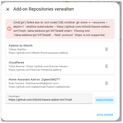

Als Trockenübung habe ich probiert diesen Addon zuzufügen:
Scheinbar ist sogar die Anfängeranleitung zu kompliziert für mich.
Wie seid ihr vorgegangen? Könnt ihr mir das bitte erklären?
Danke und VG
Alex
ich würde da eher auf ein internes Problem bei Dir schließen, hast Du einmal alle sauber neu gestartet?
Ich habe das schon vor langer Zeit gemacht, da lief das ohne Probleme, auch letztens habe ich da ein neues Repository hinzugefügt, auch ohne Probleme.
Zum Neustart bin ich nicht gekommen, denn Add on zu laden ist ha der erste Schritt, nicht?
Ansonsten scheint HA normal zu funktionieren mit Ausnahme der Sachen, die ich zum ersten Mal mache…
Exakt nach der Anfängeranleitung vorgegangen.
Ist es eine Integration oder Addon?..
das ist ein Add-on!
Steht doch aber auch in der Anleitung, oder?
Go to Settings → Add Ons “Add On Store” (bottom right) → Repository (Top Right) → Add “GitHub - b3nn0/hassio-addon-ism7mqtt: HomeAssistant Addon for running ism7mqtt to fetch data from Wolf heaters” Repository
Den Satz verstehe ich nicht, was hat das mit einem Problem zu tun?
Ein Neustart von HA, kann helfen Probleme, die sich über die Zeit in das System geschlichen haben, z.B. nach Updates, configuration.yaml Änderungen usw. aus dem System, zu tilgen!
Danach kann man anfangen, das Repository in seine Liste mit aufzunehmen.
Danke Bernd,
hat geklappt.

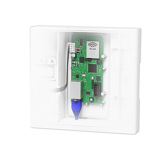

PS. ISM7i ist nun auch unterwegs
Darf ich fragen wo ihr das ISM7 angeschlossen habt? Ich habe im Heizungsraum eine CGW24/200 ,dann geht ein Kabel in unsere Wohnung,wo das BM angeschlossen ist. Wird das an der Heizung angeschlossen oder am BM??
Steht in der Anleitung :wink:
Es gibt zwei, Systeme, einmal ISM7i und ISM7e, wobei
Vielen Dank @dp20eic … Ich bin immer etwas verwirrt was die Kompatibilität angeht: in den Anleitungen steht immer CGW-2 - ich habe eine CGW-24/200 → ist das eine CGW-2 ? Passt das ISM7e an meiner Heizung?
ich bin kein Heizungsbauer oder der sich mit Wolfgeräten auskennt, aber ich würde vermuten, Bauchgefühl, dass Du da ein Denkfehler machst und das Gerät heißt im Grunde genommen CGW 2-24, wie z. B.
Wolf CGW-2-24/140 24kW Gas-Brennwert-Zentrale, Gas-Brennwerttherme
Die 24 ist die Leistung, was die 140, bzw. 200 bedeutet, müsste ich erst nachschauen, das kannst Du aber auch alleine schaffen :wink:
Könnte die Literzahl des Speichers sein :thinking:
Ich habe herausgefunden,das CGW-2 Geräte die Nachfolger meiner CGW Serie ist. Ob das ISM7E passt werde ich wohl austesten müssen. Allerdings sagt die Anleitung der ISM7E,das auch mein BM (auch der Vorgänger des BM2) passend bzw als Voraussetzung ist bzw gebraucht wird.
