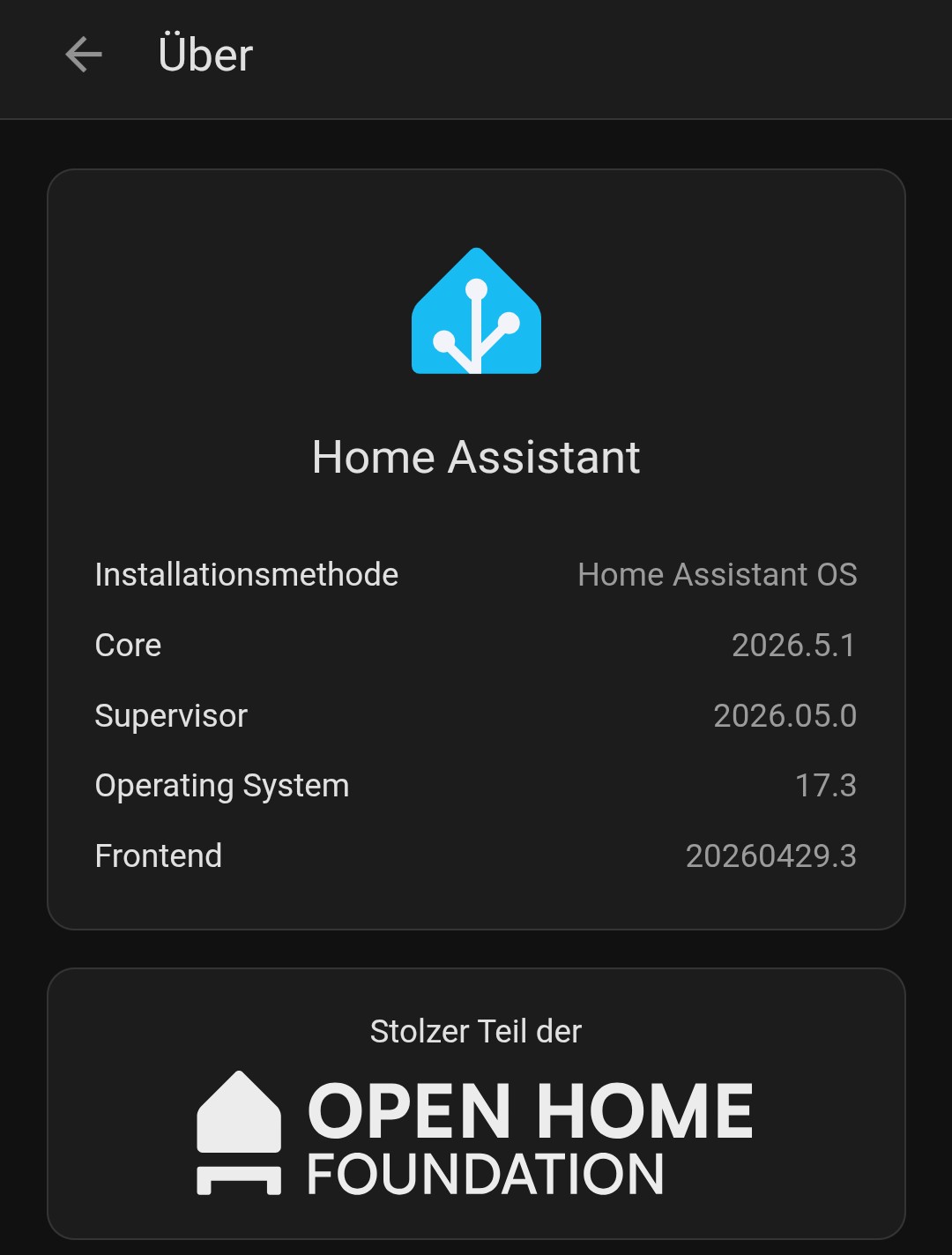

Home Assistant Version: 2026.5.1 (Frontend-Version: 20260510.0)
Python-Version: 3.14 (laut Logs)
