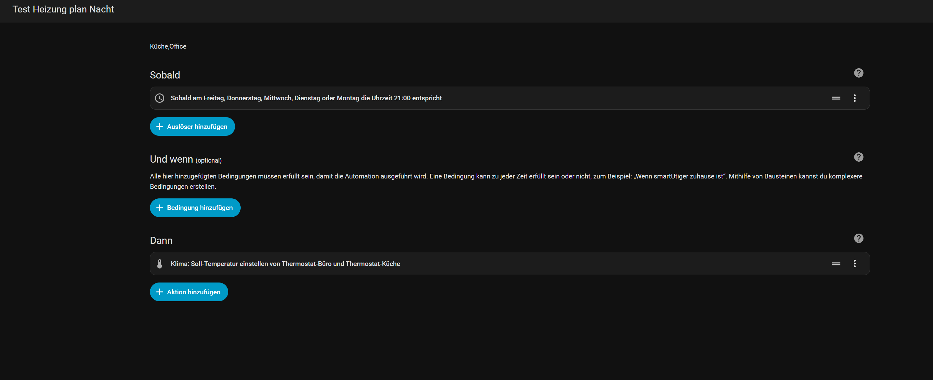

alias: Test Heizung plan  Nacht
description: "Küche,Office "
- trigger: time
  at: “21:00:00”
  weekday:
  - fri
  - thu
  - wed
  - tue
  - mon
    conditions: [ ]
- action: climate.set_temperature
  metadata: {}
  entity_id:
  - climate.thermostat_buro
  - climate.thermostat_kuche
  temperature: 15
