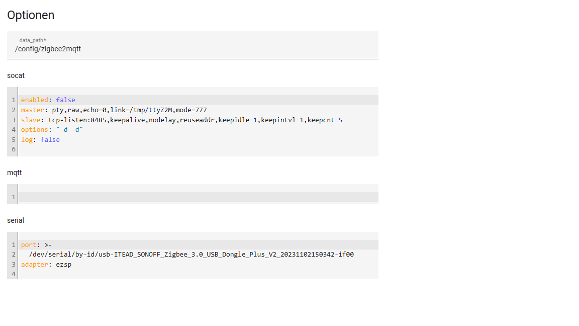

    Meine Konfig:
Zur Konfig: Ich habe die kurze und lange Version des Ports getestet. Beides ohne Erfolg.

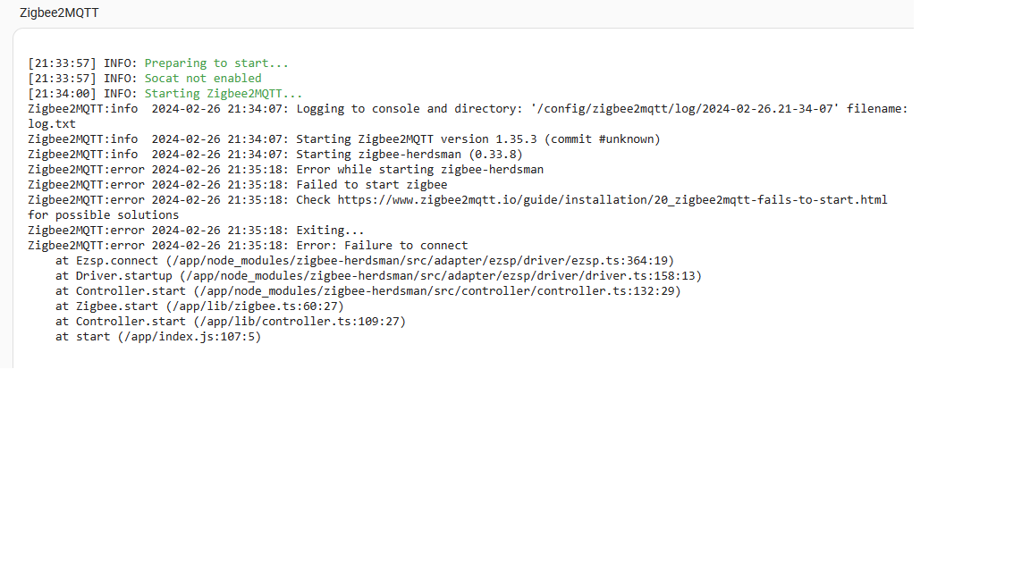

Das daraus entstandene Protokoll:
Ich werde leider daraus nicht schlau…wo mache ich einen Fehler ???

Sorry das ich erst jetzt antworte…hier mal meine jetzige Config
frontend:
  port: 8099
homeassistant:
  legacy_entity_attributes: true
  status_topic: homeassistant/status
permit_join: false
serial:
  port: >-
    /dev/serial/by-id/usb-ITEAD_SONOFF_Zigbee_3.0_USB_Dongle_Plus_V2_20231102150342-if00
  adapter: ezsp
  baudrate: 115200
  rtscts: true
advanced:
  pan_id: 12015
  network_key:
    - 243
    - 226
    - 115
    - 45
    - 175
    - 185
    - 186
    - 135
    - 192
    - 154
    - 113
    - 127
    - 229
    - 186
    - 42
    - 12
  channel: 25
mqtt:
  user: addons
  password: quooheeyiyei0athaethaiheequah4aiShasooy6bohsooPheeFeeDohwohNgai7
Der Log.txt schaut danach so aus:
info  2024-03-13 21:51:40: Logging to console and directory: '/config/zigbee2mqtt/log/2024-03-13.21-51-40' filename: log.txt
info  2024-03-13 21:51:40: Starting Zigbee2MQTT version 1.36.0 (commit #unknown)
info  2024-03-13 21:51:40: Starting zigbee-herdsman (0.35.1)
error 2024-03-13 21:52:11: Error while starting zigbee-herdsman
error 2024-03-13 21:52:11: Failed to start zigbee
error 2024-03-13 21:52:11: Check https://www.zigbee2mqtt.io/guide/installation/20_zigbee2mqtt-fails-to-start.html for possible solutions
error 2024-03-13 21:52:11: Exiting...
error 2024-03-13 21:52:11: Error: Failure to connect
    at Ezsp.connect (/app/node_modules/zigbee-herdsman/src/adapter/ezsp/driver/ezsp.ts:373:19)
    at Driver.startup (/app/node_modules/zigbee-herdsman/src/adapter/ezsp/driver/driver.ts:163:13)
    at Controller.start (/app/node_modules/zigbee-herdsman/src/controller/controller.ts:132:29)
    at Zigbee.start (/app/lib/zigbee.ts:62:27)
    at Controller.start (/app/lib/controller.ts:109:27)
    at start (/app/index.js:107:5)
