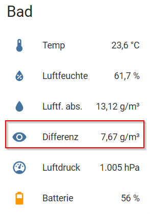

Funktioniert.
Für den Sensor im Bad sieht das dann z.B. so aus:

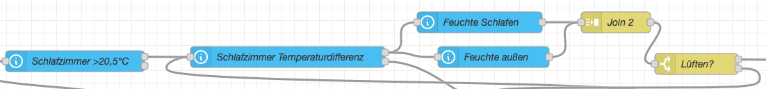

Ich verwende auch die Differenz innen/außen (die Luftfeuchtigkeit und die Temperatur jeweils über Shelly H/T erfasst).
Mache das Ganze aber über Node-Red, was mir den Template-Sensor erspart:
[{"id":"3301cc5d92b6ac73","type":"api-current-state","z":"ee39372d6d31698e","name":"Schlafzimmer Temperaturdifferenz","server":"a1aba8eb.bfd618","version":3,"outputs":2,"halt_if":"-0.5","halt_if_type":"num","halt_if_compare":"lt","entity_id":"sensor.temperaturunterschied_schlafzimmer_aussen","state_type":"num","blockInputOverrides":false,"outputProperties":[{"property":"payload","propertyType":"msg","value":"","valueType":"entityState"},{"property":"data","propertyType":"msg","value":"","valueType":"entity"},{"property":"topic","propertyType":"msg","value":"","valueType":"triggerId"}],"for":"0","forType":"num","forUnits":"minutes","override_topic":false,"state_location":"payload","override_payload":"msg","entity_location":"data","override_data":"msg","x":782,"y":1276,"wires":[["c710971677230407","f775a77f1044554a"],["0ccd5013e44bc2a6"]]},{"id":"9d0835943fed4045","type":"api-current-state","z":"ee39372d6d31698e","name":"Schlafzimmer >20,5°C","server":"a1aba8eb.bfd618","version":3,"outputs":2,"halt_if":"20.5","halt_if_type":"num","halt_if_compare":"gt","entity_id":"sensor.schlafraum_temperature","state_type":"num","blockInputOverrides":false,"outputProperties":[{"property":"payload","propertyType":"msg","value":"","valueType":"entityState"},{"property":"data","propertyType":"msg","value":"","valueType":"entity"}],"for":"0","forType":"num","forUnits":"minutes","override_topic":false,"state_location":"payload","override_payload":"msg","entity_location":"data","override_data":"msg","x":476,"y":1282,"wires":[["3301cc5d92b6ac73"],[]]},{"id":"c710971677230407","type":"api-current-state","z":"ee39372d6d31698e","name":"Feuchte Schlafen","server":"a1aba8eb.bfd618","version":3,"outputs":1,"halt_if":"","halt_if_type":"num","halt_if_compare":"is","entity_id":"sensor.schlafzimmerluft_absolute_luftfeuchtigkeit","state_type":"num","blockInputOverrides":false,"outputProperties":[{"property":"payload","propertyType":"msg","value":"","valueType":"entityState"},{"property":"data","propertyType":"msg","value":"","valueType":"entity"},{"property":"topic","propertyType":"msg","value":"","valueType":"triggerId"}],"for":"0","forType":"num","forUnits":"minutes","override_topic":false,"state_location":"payload","override_payload":"msg","entity_location":"data","override_data":"msg","x":1058,"y":1226,"wires":[["20accdf3733f46c1"]]},{"id":"f775a77f1044554a","type":"api-current-state","z":"ee39372d6d31698e","name":"Feuchte  außen","server":"a1aba8eb.bfd618","version":3,"outputs":1,"halt_if":"","halt_if_type":"num","halt_if_compare":"is","entity_id":"sensor.aussenluft_absolute_luftfeuchtigkeit","state_type":"num","blockInputOverrides":false,"outputProperties":[{"property":"payload","propertyType":"msg","value":"","valueType":"entityState"},{"property":"data","propertyType":"msg","value":"","valueType":"entity"},{"property":"topic","propertyType":"msg","value":"","valueType":"triggerId"}],"for":"0","forType":"num","forUnits":"minutes","override_topic":false,"state_location":"payload","override_payload":"msg","entity_location":"data","override_data":"msg","x":1078,"y":1276,"wires":[["20accdf3733f46c1"]]},{"id":"20accdf3733f46c1","type":"join","z":"ee39372d6d31698e","name":"Join","mode":"custom","build":"array","property":"payload","propertyType":"msg","key":"topic","joiner":"\\n","joinerType":"str","accumulate":false,"timeout":"","count":"2","reduceRight":false,"reduceExp":"","reduceInit":"","reduceInitType":"","reduceFixup":"","x":1254,"y":1226,"wires":[["03c9a5c47dac3615"]]},{"id":"03c9a5c47dac3615","type":"switch","z":"ee39372d6d31698e","name":"Lüften?","property":"payload[0]","propertyType":"msg","rules":[{"t":"lt","v":"payload[1]","vt":"msg"},{"t":"gte","v":"payload[1]","vt":"msg"}],"checkall":"true","repair":false,"outputs":2,"x":1370,"y":1286,"wires":[["c717e76c9b3e3bd8"],["0ccd5013e44bc2a6"]]},{"id":"a1aba8eb.bfd618","type":"server","name":"Home Assistant","version":5,"addon":true,"rejectUnauthorizedCerts":true,"ha_boolean":"y|yes|true|on|home|open","connectionDelay":true,"cacheJson":true,"heartbeat":false,"heartbeatInterval":30,"areaSelector":"friendlyName","deviceSelector":"friendlyName","entitySelector":"friendlyName","statusSeparator":"at: ","statusYear":"hidden","statusMonth":"short","statusDay":"numeric","statusHourCycle":"h23","statusTimeFormat":"h:m","enableGlobalContextStore":true}]
