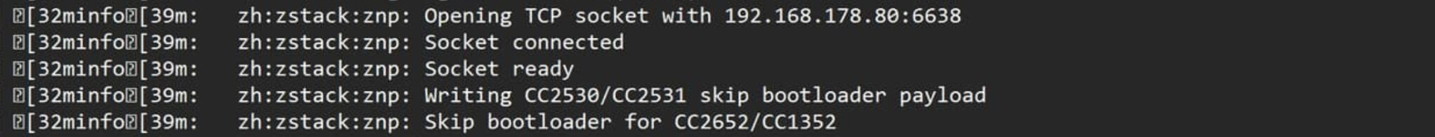

[2025-06-15 21:27:59] e[32minfoe[39m: 	z2m: Logging to console, file (filename: log.log)
[2025-06-15 21:27:59] e[32minfoe[39m: 	z2m: Starting Zigbee2MQTT version 2.4.0 (commit #unknown)
[2025-06-15 21:27:59] e[32minfoe[39m: 	z2m: Starting zigbee-herdsman (4.1.0)
[2025-06-15 21:27:59] e[32minfoe[39m: 	zh:zstack:znp: Opening TCP socket with 192.168.178.80:6638
[2025-06-15 21:27:59] e[32minfoe[39m: 	zh:zstack:znp: Socket connected
[2025-06-15 21:27:59] e[32minfoe[39m: 	zh:zstack:znp: Socket ready
[2025-06-15 21:27:59] e[32minfoe[39m: 	zh:zstack:znp: Writing CC2530/CC2531 skip bootloader payload
[2025-06-15 21:28:00] e[32minfoe[39m: 	zh:zstack:znp: Skip bootloader for CC2652/CC1352
[2025-06-15 21:28:18] e[31merrore[39m: 	z2m: Error while starting zigbee-herdsman
[2025-06-15 21:28:18] e[31merrore[39m: 	z2m: Failed to start zigbee-herdsman
[2025-06-15 21:28:18] e[31merrore[39m: 	z2m: Check https://www.zigbee2mqtt.io/guide/installation/20_zigbee2mqtt-fails-to-start_crashes-runtime.html for possible solutions
[2025-06-15 21:28:18] e[31merrore[39m: 	z2m: Exiting...
[2025-06-15 21:28:18] e[31merrore[39m: 	z2m: Error: Failed to connect to the adapter (Error: SRSP - SYS - ping after 6000ms)

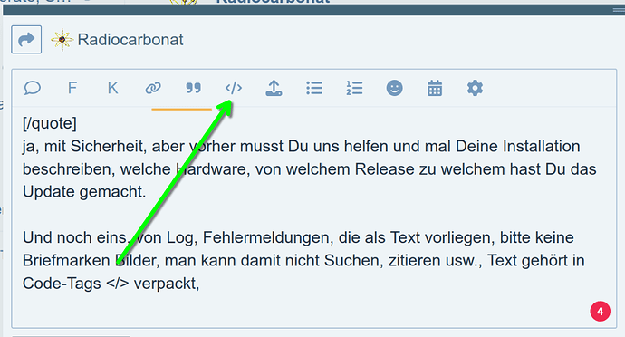

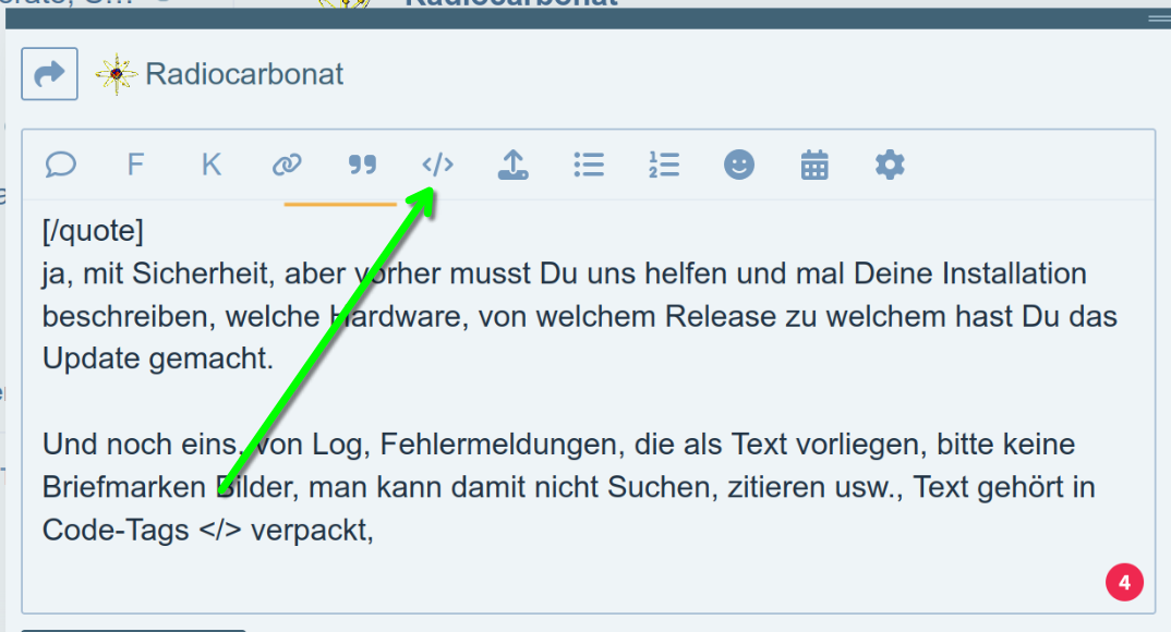

Und noch eins, von Log, Fehlermeldungen, die als Text vorliegen, bitte keine Briefmarken Bilder, man kann damit nicht Suchen, zitieren usw., Text gehört in Code-Tags </> verpackt,
