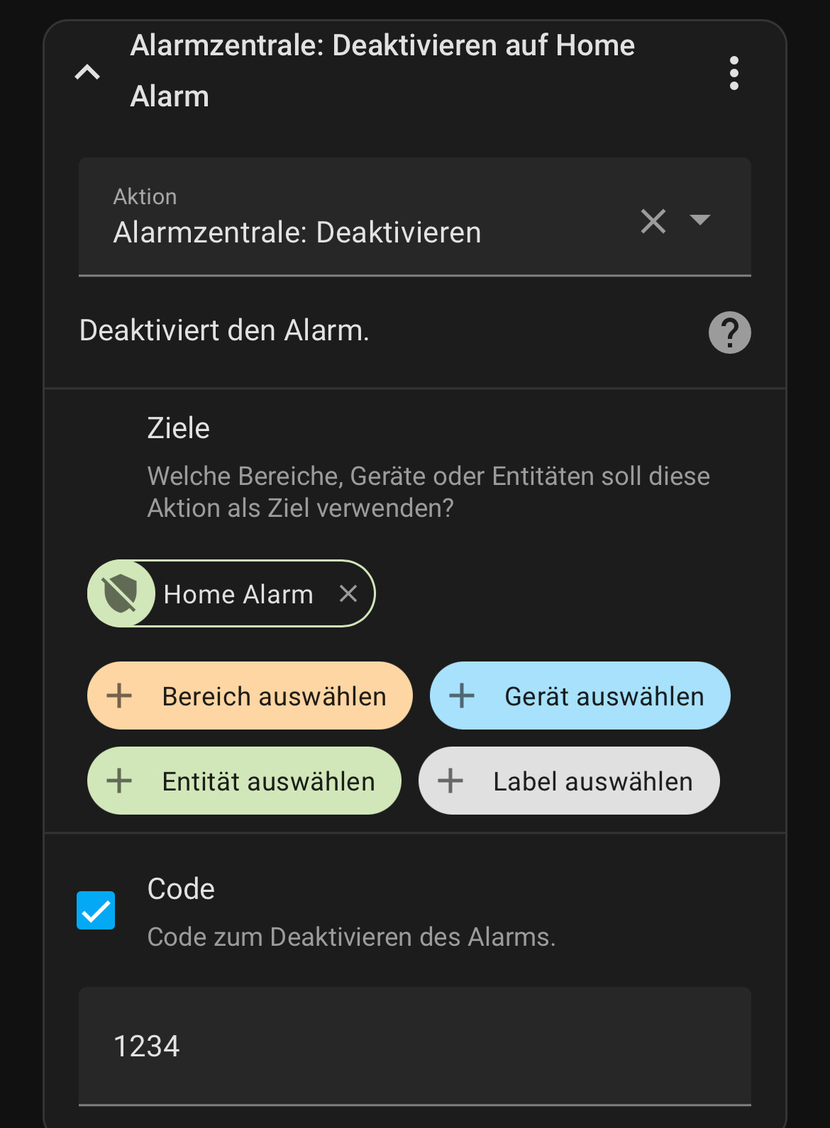

Das Ziel fehlt, die Entität des alarm_control_panel
  - action: alarm_control_panel.alarm_disarm
      entity_id: alarm_control_panel.home_alarm
      code: "1234"

Vielen Dank, jetzt hat es geklappt…
alias: Garage Auto Alarm aus
  - trigger: state
    entity_id:
      - binary_sensor.garage_door_garage_door_light
    from: "off"
    to: "on"
conditions: []
    metadata: {}
    data: {}
      entity_id: alarm_control_panel.intrusion_detection_system
