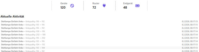

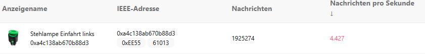

Eine unserer Außensteckdosen (Zigbee) verursachen extrem viel Traffic im Netz. Ist das normal?
4.427 Nachrichten pro Sekunde
[8.2.2026, 08:17:36] z2m:mqtt: MQTT publish: topic 'zigbee2mqtt/Stehlampe Einfahrt links', payload '{"child_lock":"UNLOCK","countdown":0,"current":0.01,"energy":1.4,"indicator_mode":"off/on","linkquality":116,"power":0,"power_outage_memory":"restore","state":"OFF","update":{"installed_version":-1,"latest_version":-1,"state":null},"voltage":231}'
[8.2.2026, 08:17:37] z2m:mqtt: MQTT publish: topic 'zigbee2mqtt/Stehlampe Einfahrt links', payload '{"child_lock":"UNLOCK","countdown":0,"current":0.01,"energy":1.4,"indicator_mode":"off/on","linkquality":116,"power":0,"power_outage_memory":"restore","state":"OFF","update":{"installed_version":-1,"latest_version":-1,"state":null},"voltage":231}'
