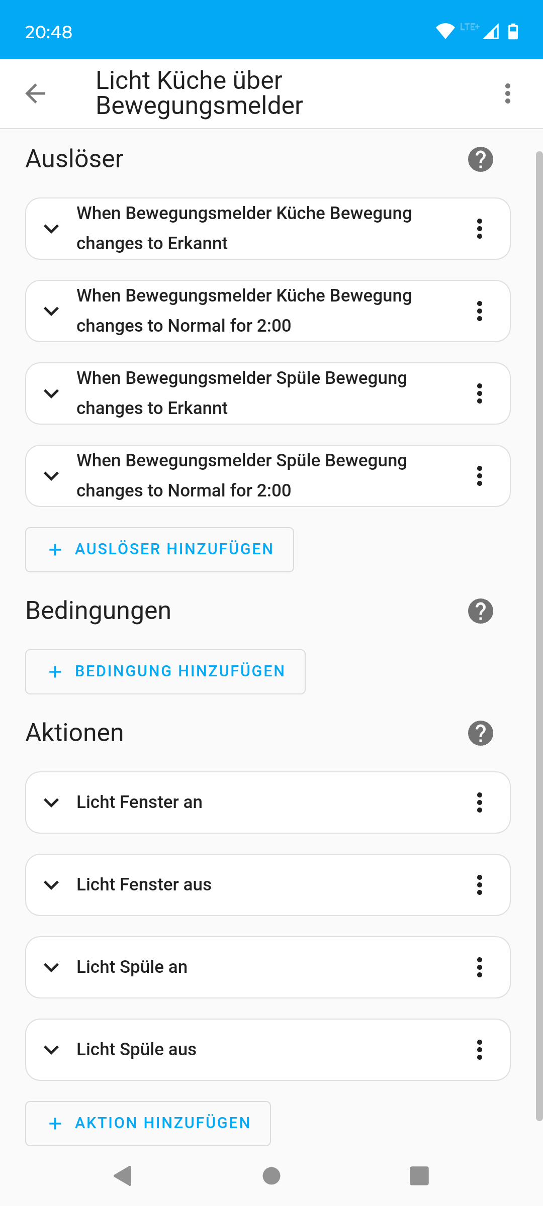

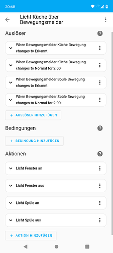

- platform: state
    entity_id:
      - binary_sensor.bewegungsmelder_kuche_occupancy
    to: "on"
  - platform: state
    entity_id:
    to: "off"
    for:
      hours: 0
      minutes: 2
      seconds: 0
Grüße Markus
