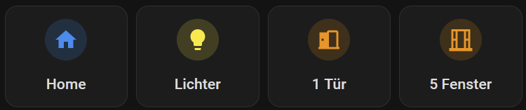

So sehen die Karten aus:
Und das ist der Code dazu:
type: horizontal-stack
cards:
  - type: custom:mushroom-template-card
    primary: Home
    secondary: ''
    icon: mdi:home
    icon_color: blue
    layout: vertical
    tap_action:
      action: navigate
      navigation_path: /lovelace/default_view
    primary: Lichter
    secondary: ''
    icon: mdi:lightbulb
    icon_color: yellow
    layout: vertical
    tap_action:
      action: navigate
      navigation_path: /dashboard-pilz/lichter
    primary: >-
      {{ states('sensor.offene_turen') }} {% if is_state('sensor.offene_turen',
      '1') %} Tür
      {% else %}
        Türen
      {% endif %}
    secondary: ''
    icon: |-
      {% if is_state('sensor.offene_turen', '0') %}
        mdi:door-closed
      {% else %}
        mdi:door-open
      {% endif %}
    icon_color: |-
        green
      {% else %}
        orange
      {% endif %}
    layout: vertical
    tap_action:
      action: navigate
      navigation_path: /dashboard-pilz/turen
    primary: '{{ states(''sensor.offene_fenster'') }} Fenster'
    secondary: ''
    icon: |-
      {% if is_state('sensor.offene_fenster', '0') %}
        mdi:window-closed-variant
      {% else %}
        mdi:window-open-variant
      {% endif %}
    icon_color: |-
        green
      {% else %}
        orange
      {% endif %}
    layout: vertical
    tap_action:
      action: navigate
      navigation_path: /dashboard-pilz/fenster
Vielen Dank
