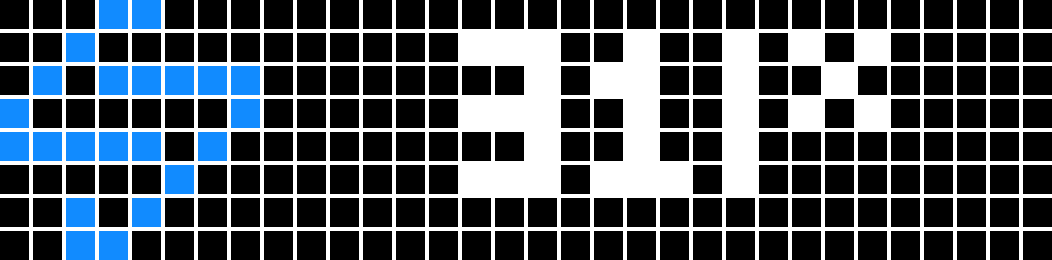

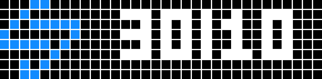

Im Ulanzi Display habe ich dann auch folgende Anzeige, z.b. sofern Sensor 10 auf true steht. Den aktuellen Tibber Bruttopreis/Cent|10 - sieht dann so aus:
Also aktuell 30 Cent und eine der 10 günstigsten Stunden…
Sofern aktuell keine der günstigsten Stunden, wird ein * ausgegeben:

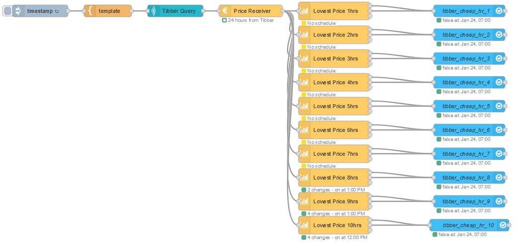

Wo kommt Dein binary_sensor.tibber_cheap_hr_1 her?
Ist ein NodeRed Flow, den ich schon unterm IoBroker in Verwendung hatte.
Ja, die neuen Preise kommen immer um 13:00 Uhr. Ich trigger den Flow allerdings stündlich vorne über den Timestamp Node, damit sich hinten raus die HA Entitäten cheap hr 1 bis 10 auch entsprechend stündlich aktualisieren.
Im Node “Tibber Query” gehört dann der eigene Tibber Token rein.
Der Flow zum möglichen Import:
[{"id":"86d000b579debf61","type":"tab","label":"Tibber Günstigste Stunden","disabled":false,"info":"","env":[]},{"id":"1431605b2d20555b","type":"inject","z":"86d000b579debf61","name":"","props":[{"p":"payload"},{"p":"topic","vt":"str"}],"repeat":"","crontab":"0 0-23 * * *","once":true,"onceDelay":0.1,"topic":"","payload":"","payloadType":"date","x":170,"y":260,"wires":[["99594a21f61dcf53"]]},{"id":"99594a21f61dcf53","type":"template","z":"86d000b579debf61","name":"","field":"payload","fieldType":"msg","format":"handlebars","syntax":"mustache","template":"{\n  viewer {\n    homes {\n      currentSubscription {\n        priceInfo {\n          today {\n            total\n            startsAt\n          }\n          tomorrow {\n            total\n            startsAt\n          }\n        }\n      }\n    }\n  }\n}","output":"str","x":340,"y":260,"wires":[["3a406cd74a465339"]]},{"id":"3a406cd74a465339","type":"tibber-query","z":"86d000b579debf61","name":"Tibber Query","active":true,"apiEndpointRef":"6c0ebed9c4db1a3b","x":510,"y":260,"wires":[["eb1644a5e8baecb8"]]},{"id":"eb1644a5e8baecb8","type":"ps-receive-price","z":"86d000b579debf61","name":"Price Receiver","x":700,"y":260,"wires":[["7659982adc0e294f","8aa67fc363a3a2ee","c375988822ca6220","733acc158526de21","b90704fe78cf2b38","47a7434b094a9f39","a2da6bca9e5fc44f","4296c3a8732d8cab","56211fc8b5aff163","346d1ea3bcd76627"]]},{"id":"7659982adc0e294f","type":"ps-strategy-lowest-price","z":"86d000b579debf61","name":"Lowest Price 2hrs","fromTime":"00","toTime":"00","hoursOn":"2","maxPrice":"2","doNotSplit":false,"sendCurrentValueWhenRescheduling":true,"outputValueForOn":"true","outputValueForOff":"false","outputValueForOntype":"bool","outputValueForOfftype":"bool","outputIfNoSchedule":"false","outputOutsidePeriod":"false","contextStorage":"memory","x":910,"y":320,"wires":[["b45855afd1ca7bb8"],["b45855afd1ca7bb8"],[]]},{"id":"8aa67fc363a3a2ee","type":"ps-strategy-lowest-price","z":"86d000b579debf61","name":"Lowest Price 3hrs","fromTime":"00","toTime":"00","hoursOn":"3","maxPrice":"2","doNotSplit":false,"sendCurrentValueWhenRescheduling":true,"outputValueForOn":"true","outputValueForOff":"false","outputValueForOntype":"bool","outputValueForOfftype":"bool","outputIfNoSchedule":"false","outputOutsidePeriod":"false","contextStorage":"memory","x":910,"y":380,"wires":[["68e75fdccd1ca055"],["68e75fdccd1ca055"],[]]},{"id":"c375988822ca6220","type":"ps-strategy-lowest-price","z":"86d000b579debf61","name":"Lowest Price 4hrs","fromTime":"00","toTime":"00","hoursOn":"4","maxPrice":"2","doNotSplit":false,"sendCurrentValueWhenRescheduling":true,"outputValueForOn":"true","outputValueForOff":"false","outputValueForOntype":"bool","outputValueForOfftype":"bool","outputIfNoSchedule":"false","outputOutsidePeriod":"false","contextStorage":"memory","x":910,"y":440,"wires":[["9b9a514ed40afc23"],["9b9a514ed40afc23"],[]]},{"id":"733acc158526de21","type":"ps-strategy-lowest-price","z":"86d000b579debf61","name":"Lowest Price 5hrs","fromTime":"00","toTime":"00","hoursOn":"5","maxPrice":"2","doNotSplit":false,"sendCurrentValueWhenRescheduling":true,"outputValueForOn":"true","outputValueForOff":"false","outputValueForOntype":"bool","outputValueForOfftype":"bool","outputIfNoSchedule":"false","outputOutsidePeriod":"false","contextStorage":"memory","x":910,"y":500,"wires":[["bb3ef304d8f5b1bb"],["bb3ef304d8f5b1bb"],[]]},{"id":"b90704fe78cf2b38","type":"ps-strategy-lowest-price","z":"86d000b579debf61","name":"Lowest Price 6hrs","fromTime":"00","toTime":"00","hoursOn":"6","maxPrice":"2","doNotSplit":false,"sendCurrentValueWhenRescheduling":true,"outputValueForOn":"true","outputValueForOff":"false","outputValueForOntype":"bool","outputValueForOfftype":"bool","outputIfNoSchedule":"false","outputOutsidePeriod":"false","contextStorage":"memory","x":910,"y":560,"wires":[["64537f499aee6861"],["64537f499aee6861"],[]]},{"id":"56211fc8b5aff163","type":"ps-strategy-lowest-price","z":"86d000b579debf61","name":"Lowest Price 7hrs","fromTime":"00","toTime":"00","hoursOn":"7","maxPrice":"2","doNotSplit":false,"sendCurrentValueWhenRescheduling":true,"outputValueForOn":"true","outputValueForOff":"false","outputValueForOntype":"bool","outputValueForOfftype":"bool","outputIfNoSchedule":"false","outputOutsidePeriod":"false","contextStorage":"memory","x":910,"y":620,"wires":[["524724be7baa1c29"],["524724be7baa1c29"],[]]},{"id":"47a7434b094a9f39","type":"ps-strategy-lowest-price","z":"86d000b579debf61","name":"Lowest Price 8hrs","fromTime":"00","toTime":"00","hoursOn":"8","maxPrice":"2","doNotSplit":false,"sendCurrentValueWhenRescheduling":true,"outputValueForOn":"true","outputValueForOff":"false","outputValueForOntype":"bool","outputValueForOfftype":"bool","outputIfNoSchedule":"false","outputOutsidePeriod":"false","contextStorage":"memory","x":910,"y":680,"wires":[["7c9c567ccd4e6a3b"],["7c9c567ccd4e6a3b"],[]]},{"id":"a2da6bca9e5fc44f","type":"ps-strategy-lowest-price","z":"86d000b579debf61","name":"Lowest Price 9hrs","fromTime":"00","toTime":"00","hoursOn":"9","maxPrice":"2","doNotSplit":false,"sendCurrentValueWhenRescheduling":true,"outputValueForOn":"true","outputValueForOff":"false","outputValueForOntype":"bool","outputValueForOfftype":"bool","outputIfNoSchedule":"false","outputOutsidePeriod":"false","contextStorage":"memory","x":910,"y":740,"wires":[["9d2016523108cf8d"],["9d2016523108cf8d"],[]]},{"id":"4296c3a8732d8cab","type":"ps-strategy-lowest-price","z":"86d000b579debf61","name":"Lowest Price 10hrs","fromTime":"00","toTime":"00","hoursOn":"10","maxPrice":"2","doNotSplit":false,"sendCurrentValueWhenRescheduling":true,"outputValueForOn":"true","outputValueForOff":"false","outputValueForOntype":"bool","outputValueForOfftype":"bool","outputIfNoSchedule":"false","outputOutsidePeriod":"false","contextStorage":"memory","x":910,"y":800,"wires":[["67c10c697c414735"],["67c10c697c414735"],[]]},{"id":"346d1ea3bcd76627","type":"ps-strategy-lowest-price","z":"86d000b579debf61","name":"Lowest Price 1hrs","fromTime":"00","toTime":"00","hoursOn":"1","maxPrice":"2","doNotSplit":false,"sendCurrentValueWhenRescheduling":true,"outputValueForOn":"true","outputValueForOff":"false","outputValueForOntype":"bool","outputValueForOfftype":"bool","outputIfNoSchedule":"false","outputOutsidePeriod":"false","contextStorage":"memory","x":910,"y":260,"wires":[["7c63912725219c7b"],["7c63912725219c7b"],[]]},{"id":"7c63912725219c7b","type":"ha-binary-sensor","z":"86d000b579debf61","name":"tibber_cheap_hr_1","entityConfig":"4e6f363bf4b0ab84","version":0,"state":"payload","stateType":"msg","attributes":[],"inputOverride":"allow","outputProperties":[],"x":1250,"y":260,"wires":[[]]},{"id":"b45855afd1ca7bb8","type":"ha-binary-sensor","z":"86d000b579debf61","name":"tibber_cheap_hr_2","entityConfig":"42ad2fa627f015cc","version":0,"state":"payload","stateType":"msg","attributes":[],"inputOverride":"allow","outputProperties":[],"x":1250,"y":320,"wires":[[]]},{"id":"68e75fdccd1ca055","type":"ha-binary-sensor","z":"86d000b579debf61","name":"tibber_cheap_hr_3","entityConfig":"852e3ee6c7aa2fc3","version":0,"state":"payload","stateType":"msg","attributes":[],"inputOverride":"allow","outputProperties":[],"x":1250,"y":380,"wires":[[]]},{"id":"9b9a514ed40afc23","type":"ha-binary-sensor","z":"86d000b579debf61","name":"tibber_cheap_hr_4","entityConfig":"df8558e9cbd0266c","version":0,"state":"payload","stateType":"msg","attributes":[],"inputOverride":"allow","outputProperties":[],"x":1250,"y":440,"wires":[[]]},{"id":"bb3ef304d8f5b1bb","type":"ha-binary-sensor","z":"86d000b579debf61","name":"tibber_cheap_hr_5","entityConfig":"8be1b394d30071ca","version":0,"state":"payload","stateType":"msg","attributes":[],"inputOverride":"allow","outputProperties":[],"x":1250,"y":500,"wires":[[]]},{"id":"64537f499aee6861","type":"ha-binary-sensor","z":"86d000b579debf61","name":"tibber_cheap_hr_6","entityConfig":"5e347836c27fbeda","version":0,"state":"payload","stateType":"msg","attributes":[],"inputOverride":"allow","outputProperties":[],"x":1250,"y":560,"wires":[[]]},{"id":"524724be7baa1c29","type":"ha-binary-sensor","z":"86d000b579debf61","name":"tibber_cheap_hr_7","entityConfig":"cd424ed5037f8ec4","version":0,"state":"payload","stateType":"msg","attributes":[],"inputOverride":"allow","outputProperties":[],"x":1250,"y":620,"wires":[[]]},{"id":"7c9c567ccd4e6a3b","type":"ha-binary-sensor","z":"86d000b579debf61","name":"tibber_cheap_hr_8","entityConfig":"b769858e0f0e83e1","version":0,"state":"payload","stateType":"msg","attributes":[],"inputOverride":"allow","outputProperties":[],"x":1250,"y":680,"wires":[[]]},{"id":"9d2016523108cf8d","type":"ha-binary-sensor","z":"86d000b579debf61","name":"tibber_cheap_hr_9","entityConfig":"d39c5623758097cb","version":0,"state":"payload","stateType":"msg","attributes":[],"inputOverride":"allow","outputProperties":[],"x":1250,"y":740,"wires":[[]]},{"id":"67c10c697c414735","type":"ha-binary-sensor","z":"86d000b579debf61","name":"tibber_cheap_hr_10","entityConfig":"0caca1c4cb0bf593","version":0,"state":"payload","stateType":"msg","attributes":[],"inputOverride":"allow","outputProperties":[],"x":1250,"y":800,"wires":[[]]},{"id":"6c0ebed9c4db1a3b","type":"tibber-api-endpoint","queryUrl":"https://api.tibber.com/v1-beta/gql","feedConnectionTimeout":"30","feedTimeout":"60","queryRequestTimeout":"30","name":"Tibber Access Token"},{"id":"4e6f363bf4b0ab84","type":"ha-entity-config","server":"208e54bc.173dec","deviceConfig":"","name":"tibber_cheap_hr_1","version":"6","entityType":"binary_sensor","haConfig":[{"property":"name","value":"tibber_cheap_hr_1"},{"property":"icon","value":""},{"property":"entity_picture","value":""},{"property":"entity_category","value":""},{"property":"device_class","value":""}],"resend":true,"debugEnabled":false},{"id":"42ad2fa627f015cc","type":"ha-entity-config","server":"208e54bc.173dec","deviceConfig":"","name":"tibber_cheap_hr_2","version":"6","entityType":"binary_sensor","haConfig":[{"property":"name","value":"tibber_cheap_hr_2"},{"property":"icon","value":""},{"property":"entity_picture","value":""},{"property":"entity_category","value":""},{"property":"device_class","value":""}],"resend":false,"debugEnabled":false},{"id":"852e3ee6c7aa2fc3","type":"ha-entity-config","server":"208e54bc.173dec","deviceConfig":"","name":"tibber_cheap_hr_3","version":"6","entityType":"binary_sensor","haConfig":[{"property":"name","value":"tibber_cheap_hr_3"},{"property":"icon","value":""},{"property":"entity_picture","value":""},{"property":"entity_category","value":""},{"property":"device_class","value":""}],"resend":false,"debugEnabled":false},{"id":"df8558e9cbd0266c","type":"ha-entity-config","server":"208e54bc.173dec","deviceConfig":"","name":"tibber_cheap_hr_4","version":"6","entityType":"binary_sensor","haConfig":[{"property":"name","value":"tibber_cheap_hr_4"},{"property":"icon","value":""},{"property":"entity_picture","value":""},{"property":"entity_category","value":""},{"property":"device_class","value":""}],"resend":false,"debugEnabled":false},{"id":"8be1b394d30071ca","type":"ha-entity-config","server":"208e54bc.173dec","deviceConfig":"","name":"tibber_cheap_hr_5","version":"6","entityType":"binary_sensor","haConfig":[{"property":"name","value":"tibber_cheap_hr_5"},{"property":"icon","value":""},{"property":"entity_picture","value":""},{"property":"entity_category","value":""},{"property":"device_class","value":""}],"resend":true,"debugEnabled":false},{"id":"5e347836c27fbeda","type":"ha-entity-config","server":"208e54bc.173dec","deviceConfig":"","name":"tibber_cheap_hr_6","version":"6","entityType":"binary_sensor","haConfig":[{"property":"name","value":"tibber_cheap_hr_6"},{"property":"icon","value":""},{"property":"entity_picture","value":""},{"property":"entity_category","value":""},{"property":"device_class","value":""}],"resend":false,"debugEnabled":false},{"id":"cd424ed5037f8ec4","type":"ha-entity-config","server":"208e54bc.173dec","deviceConfig":"","name":"tibber_cheap_hr_7","version":"6","entityType":"binary_sensor","haConfig":[{"property":"name","value":"tibber_cheap_hr_7"},{"property":"icon","value":""},{"property":"entity_picture","value":""},{"property":"entity_category","value":""},{"property":"device_class","value":""}],"resend":false,"debugEnabled":false},{"id":"b769858e0f0e83e1","type":"ha-entity-config","server":"208e54bc.173dec","deviceConfig":"","name":"tibber_cheap_hr_8","version":"6","entityType":"binary_sensor","haConfig":[{"property":"name","value":"tibber_cheap_hr_8"},{"property":"icon","value":""},{"property":"entity_picture","value":""},{"property":"entity_category","value":""},{"property":"device_class","value":""}],"resend":false,"debugEnabled":false},{"id":"d39c5623758097cb","type":"ha-entity-config","server":"208e54bc.173dec","deviceConfig":"","name":"tibber_cheap_hr_9","version":"6","entityType":"binary_sensor","haConfig":[{"property":"name","value":"tibber_cheap_hr_9"},{"property":"icon","value":""},{"property":"entity_picture","value":""},{"property":"entity_category","value":""},{"property":"device_class","value":""}],"resend":false,"debugEnabled":false},{"id":"0caca1c4cb0bf593","type":"ha-entity-config","server":"208e54bc.173dec","deviceConfig":"","name":"tibber_cheap_hr_10","version":"6","entityType":"binary_sensor","haConfig":[{"property":"name","value":"tibber_cheap_hr_10"},{"property":"icon","value":""},{"property":"entity_picture","value":""},{"property":"entity_category","value":""},{"property":"device_class","value":""}],"resend":false,"debugEnabled":false},{"id":"208e54bc.173dec","type":"server","name":"Home Assistant","addon":true}]
