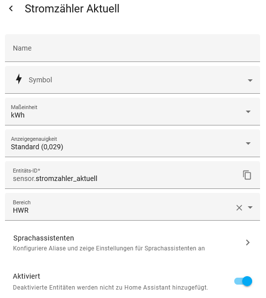

Hab ja jetzt den State in measurement geändert aber das bringt den nächsten Error:
Logger: homeassistant.components.sensor
Source: components/sensor/__init__.py:528
Integration: Sensor (documentation, issues)
First occurred: 08:37:17 (1 occurrences)
Last logged: 08:37:17
Entity sensor.stromzahler_aktuell (<class 'homeassistant.components.template.sensor.SensorTemplate'>) is using state class 'measurement' which is impossible considering device class ('energy') it is using; expected None or one of 'total_increasing', 'total'; Please update your configuration if your entity is manually configured

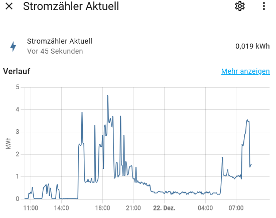

Aber der aktuelle Verbrauch wird mir korrekt angezeigt …?
