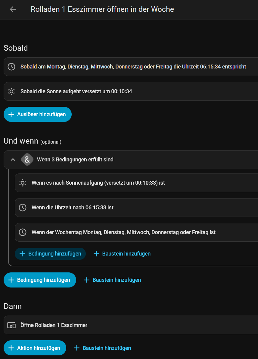

alias: Rolladen 1 Esszimmer öffnen in der Woche
  - trigger: time
    at: "06:15:34"
    weekday:
      - mon
      - tue
      - wed
      - thu
      - fri
  - trigger: sun
    event: sunrise
    offset: "00:10:34"
conditions:
  - condition: and
    conditions:
      - condition: sun
        after: sunrise
        after_offset: "00:10:33"
      - condition: time
        after: "06:15:33"
      - condition: time
        weekday:
          - mon
          - tue
          - wed
          - thu
          - fri
  - device_id: 8787167d0a5cd824efbcc6fbbf82145a
    domain: cover
    entity_id: 6fbae16d2e6463b116f31bb4a94f50fd
    type: open

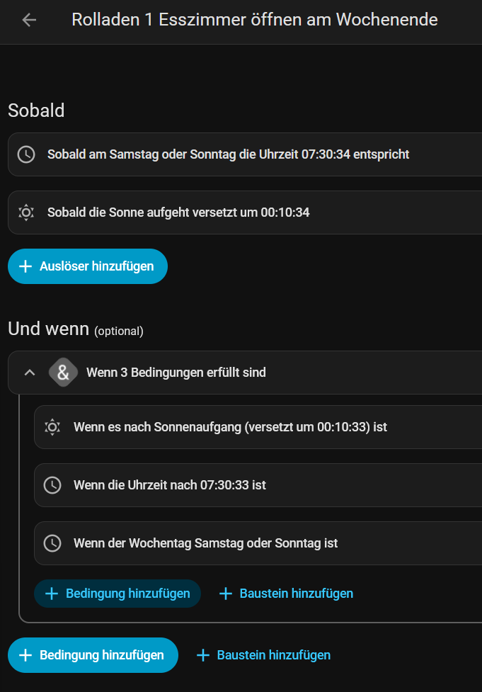

alias: Rolladen 1 Esszimmer öffnen am Wochenende
  - trigger: time
    at: "07:30:34"
    weekday:
      - sat
      - sun
  - trigger: sun
    event: sunrise
    offset: "00:10:34"
conditions:
  - condition: and
    conditions:
      - condition: sun
        after: sunrise
      - condition: time
        after: "07:30:33"
      - condition: time
        weekday:
          - sat
          - sun
    domain: cover
    type: open

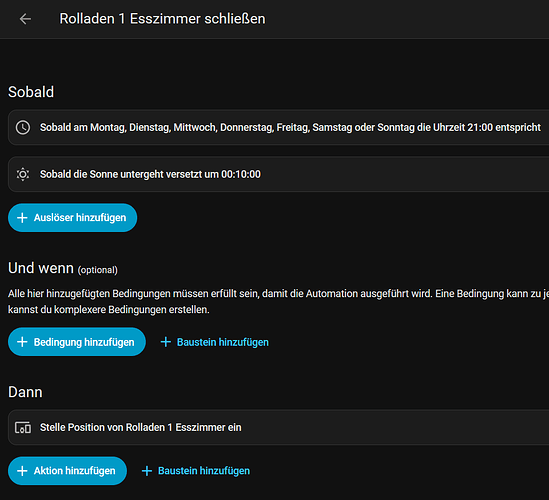

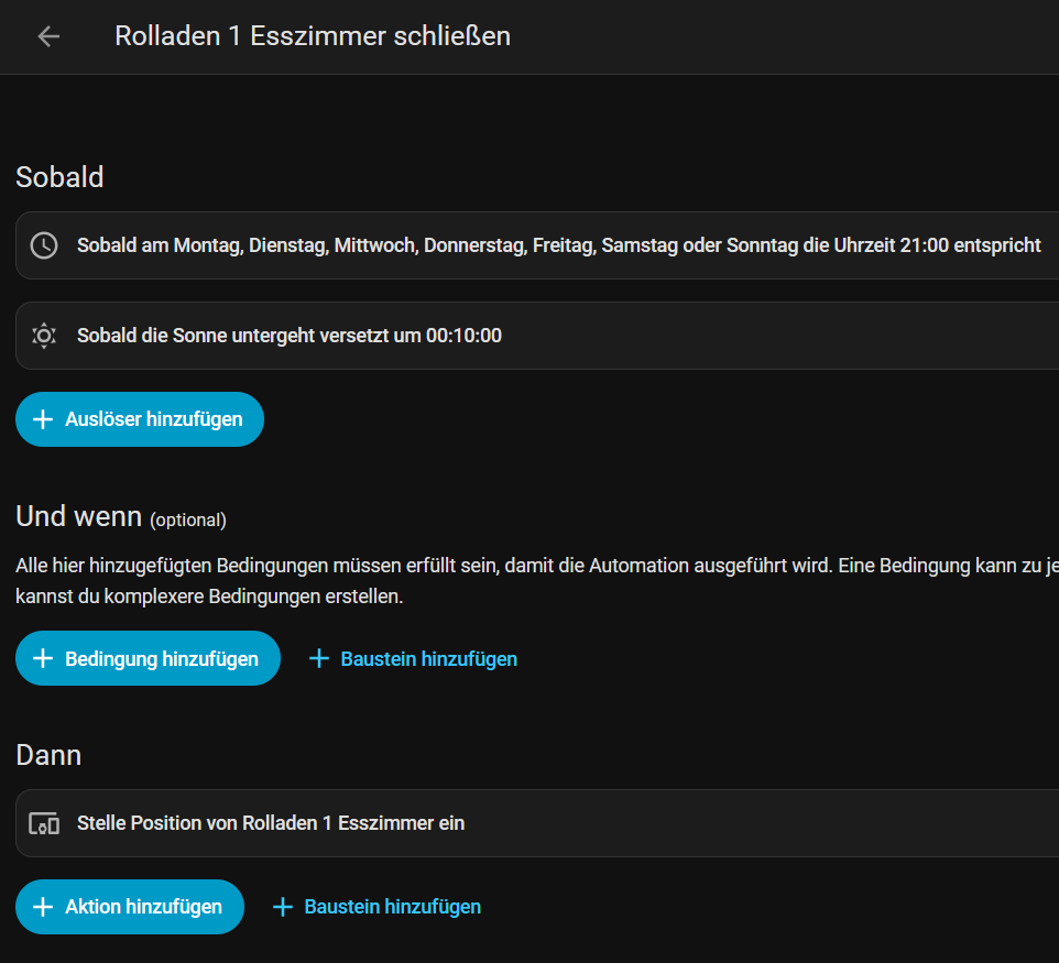

alias: "Rolladen 1 Esszimmer schließen "
  - trigger: time
    at: "21:00:00"
    weekday:
      - mon
      - tue
      - wed
      - thu
      - fri
      - sat
      - sun
  - trigger: sun
    event: sunset
    offset: "00:10:00"
conditions: []
    domain: cover
    type: set_position
    position: 31
