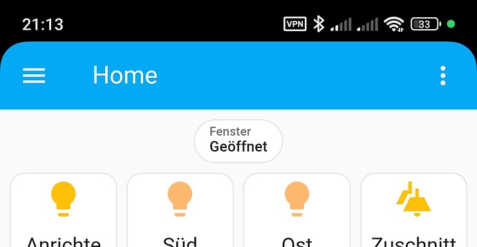

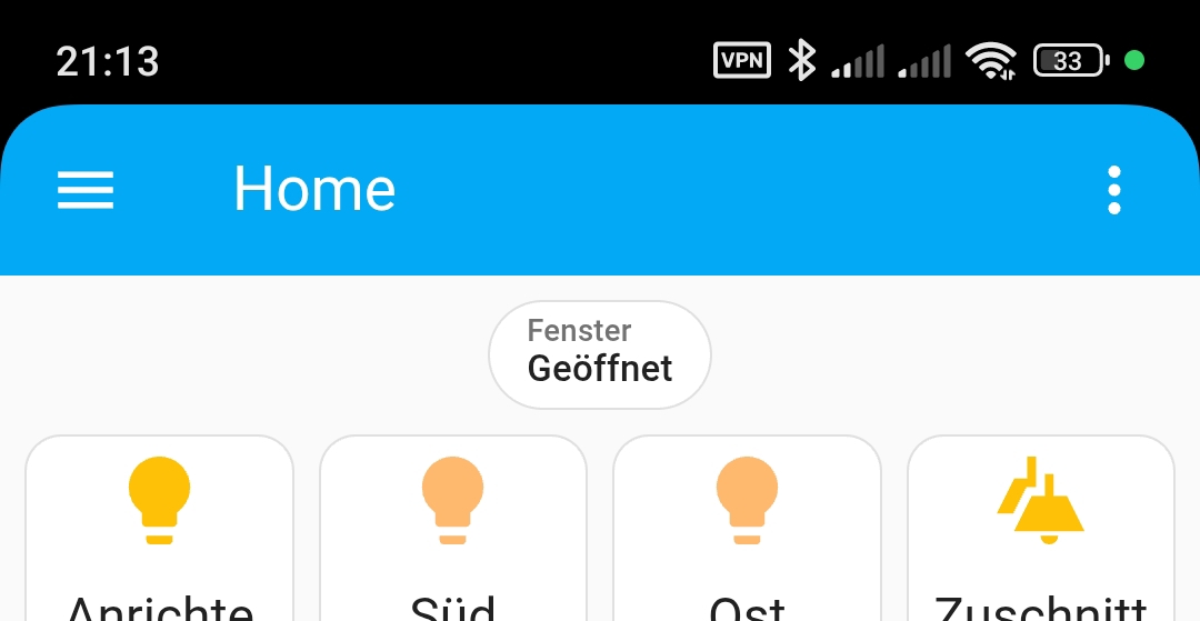

Hier mal der Code von meinem Badgev
type: entity
show_name: true
show_state: true
show_icon: false
entity: binary_sensor.alle_fenster
state_content: state
visibility:
  - condition: state
    state: "on"
tap_action:
  action: navigate
  navigation_path: /dashboard-fenster

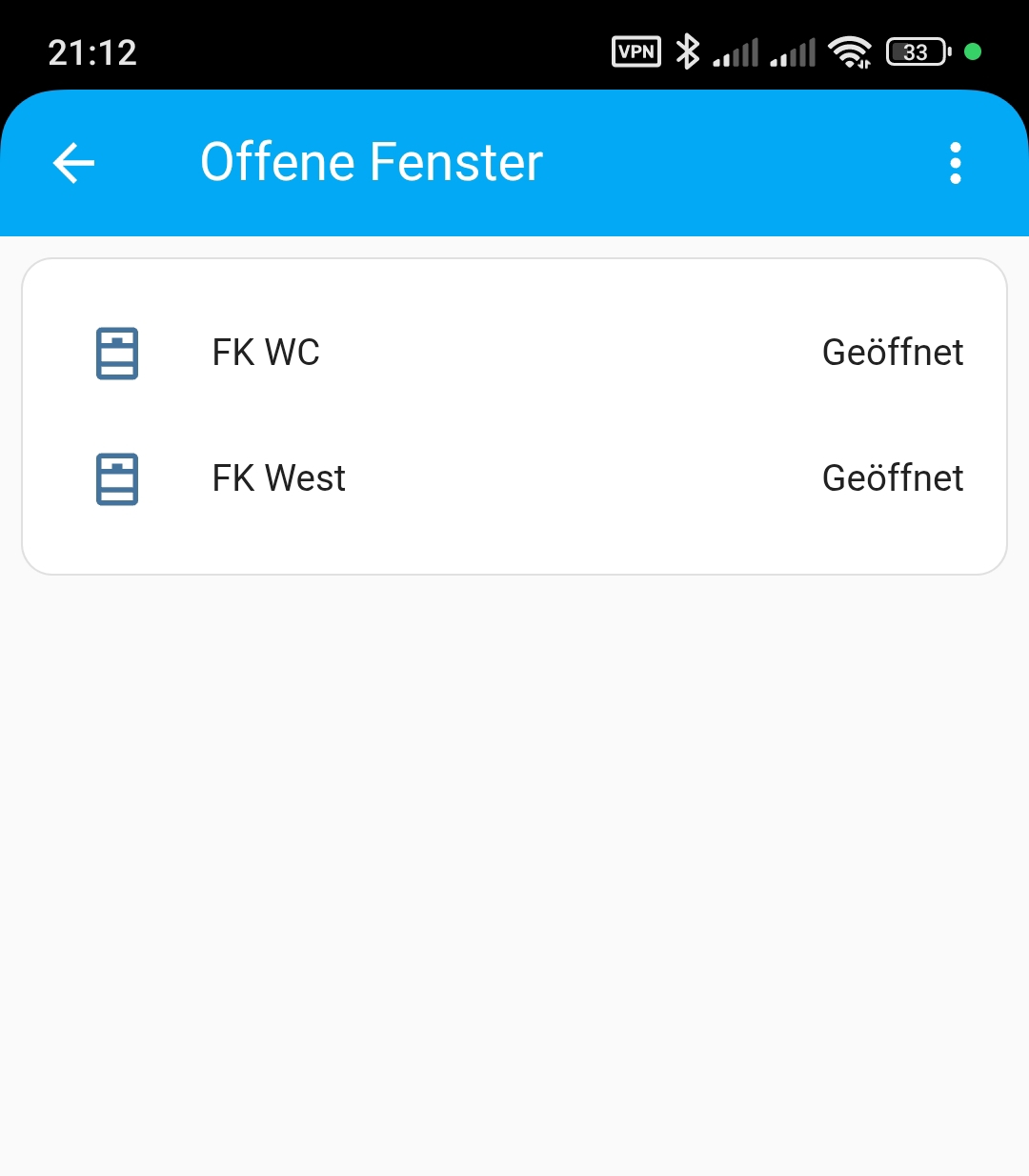

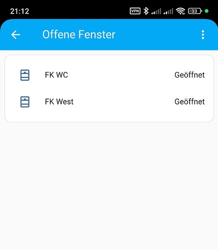

Das Dashboard “Fenster” hat diesen Code:
views:
  - title: 'Offene Fenster '
    sections:
      - type: grid
        cards:
          - type: custom:auto-entities
            card:
              type: entities
              show_header_toggle: false
              state_color: false
            filter:
              include:
                - entity_id: binary_sensor.fen*
              exclude:
                - state: 'off'
            sort:
              method: name
            grid_options:
              columns: full
            show_empty: false
    type: sections
    max_columns: 4
    subview: true
    cards: []

Ich habe es jetzt mit einem Unterfenster gelöst.
Geht auch gut.
