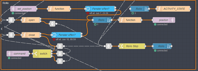

Ich hatte ein ähnliches Problem für mein Homematic Rollo in Schlafzimmer.
Das Rollo habe ich mir über NodeRed “intigriert” und die Runterfahr Funktion geht nur wenn der Fensterkontakt geschlossen ist. In Home Assistant ist es dann per MQTT eingebunden.
Hier mein Flow von NodeRED:
[{"id":"6a552bdda2cc68b3","type":"group","z":"996176cf5e2a2c26","name":"Rollo","style":{"label":true},"nodes":["fdd0bb572a1e6325","1a2c798c6cc79700","35ab65cb333f59e8","7d4ba5e5ca1810db","66825c9fc63e62c1","d72fd546a594d48b","a279bd0166cbdf34","adc638ec9125ae02","5341be0ec2ac5f2f","837183b9e0a572cc","17a85e31905f2be8","494b5aab018d917d","d8437bca5e6c435d","756a13cd7d574e10","0d21ac87ece75bfc","394d8d747762bde8","484c9a1efc4bf900","614802917b3660ac","5aa01449dee6df64","83e8eca4f1e1b20d","61ec039b8d21afbe","b84c038478dd931d"],"x":14,"y":619,"w":1032,"h":362},{"id":"fdd0bb572a1e6325","type":"ccu-value","z":"996176cf5e2a2c26","g":"6a552bdda2cc68b3","name":"Rollo","iface":"HmIP-RF","channel":"00004482CC01E7:1","datapoint":"LEVEL","mode":"","start":true,"change":true,"cache":false,"queue":false,"on":0,"onType":"undefined","ramp":0,"rampType":"undefined","working":false,"ccuConfig":"f4cc9fc040fe979f","topic":"${CCU}/${Interface}/${channel}/${datapoint}","x":550,"y":720,"wires":[["a279bd0166cbdf34"]]},{"id":"1a2c798c6cc79700","type":"link in","z":"996176cf5e2a2c26","g":"6a552bdda2cc68b3","name":"Rollo 1.00","links":["0af54c11fad28441","4f9455e8ab961fed","61ec039b8d21afbe"],"x":65,"y":720,"wires":[["756a13cd7d574e10"]]},{"id":"35ab65cb333f59e8","type":"link in","z":"996176cf5e2a2c26","g":"6a552bdda2cc68b3","name":"Rollo 0.00","links":["ec55956d508a001e","83e8eca4f1e1b20d"],"x":65,"y":800,"wires":[["0d21ac87ece75bfc"]]},{"id":"7d4ba5e5ca1810db","type":"api-current-state","z":"996176cf5e2a2c26","g":"6a552bdda2cc68b3","name":"Fenster offen?","server":"8c9e1e3a.62e6e","version":3,"outputs":2,"halt_if":"on","halt_if_type":"str","halt_if_compare":"is","entity_id":"binary_sensor.fenster_schlafzimmer","state_type":"str","blockInputOverrides":false,"outputProperties":[],"for":"0","forType":"num","forUnits":"minutes","override_topic":false,"state_location":"payload","override_payload":"msg","entity_location":"data","override_data":"msg","x":360,"y":800,"wires":[[],["fdd0bb572a1e6325"]]},{"id":"66825c9fc63e62c1","type":"mqtt out","z":"996176cf5e2a2c26","g":"6a552bdda2cc68b3","name":"position","topic":"rollo/schlafzimmer/position_topic","qos":"2","retain":"true","respTopic":"","contentType":"","userProps":"","correl":"","expiry":"","broker":"55acca0bdba98b86","x":880,"y":720,"wires":[]},{"id":"d72fd546a594d48b","type":"ccu-value","z":"996176cf5e2a2c26","g":"6a552bdda2cc68b3","name":"Rollo","iface":"HmIP-RF","channel":"00004482CC01E7:1","datapoint":"ACTIVITY_STATE","mode":"","start":true,"change":true,"cache":false,"queue":false,"on":0,"onType":"undefined","ramp":0,"rampType":"undefined","working":false,"ccuConfig":"f4cc9fc040fe979f","topic":"${CCU}/${Interface}/${channel}/${datapoint}","x":750,"y":660,"wires":[["d8437bca5e6c435d"]]},{"id":"a279bd0166cbdf34","type":"function","z":"996176cf5e2a2c26","g":"6a552bdda2cc68b3","name":"","func":"var position = msg.payload * 1000\nflow.set(\"position\", position);\nmsg.payload = position\nreturn msg;","outputs":1,"noerr":0,"initialize":"","finalize":"","libs":[],"x":700,"y":720,"wires":[["66825c9fc63e62c1"]]},{"id":"adc638ec9125ae02","type":"mqtt in","z":"996176cf5e2a2c26","g":"6a552bdda2cc68b3","name":"set_position","topic":"rollo/schlafzimmer/set_position","qos":"2","datatype":"auto","broker":"55acca0bdba98b86","nl":false,"rap":true,"rh":0,"inputs":0,"x":130,"y":660,"wires":[["5341be0ec2ac5f2f"]]},{"id":"5341be0ec2ac5f2f","type":"function","z":"996176cf5e2a2c26","g":"6a552bdda2cc68b3","name":"","func":"var position = msg.payload / 1000\nmsg.payload = position\nreturn msg;","outputs":1,"noerr":0,"initialize":"","finalize":"","libs":[],"x":320,"y":660,"wires":[["484c9a1efc4bf900"]]},{"id":"837183b9e0a572cc","type":"ccu-value","z":"996176cf5e2a2c26","g":"6a552bdda2cc68b3","name":"Rollo","iface":"HmIP-RF","channel":"00004482CC01E7:1","datapoint":"STOP","mode":"","start":true,"change":true,"cache":false,"queue":false,"on":0,"onType":"undefined","ramp":0,"rampType":"undefined","working":false,"ccuConfig":"f4cc9fc040fe979f","topic":"${CCU}/${Interface}/${channel}/${datapoint}","x":870,"y":860,"wires":[[]]},{"id":"17a85e31905f2be8","type":"link in","z":"996176cf5e2a2c26","g":"6a552bdda2cc68b3","name":"Rollo Stop","links":["0c1f8fa7872f798b","0210f0637d3e51f2","394d8d747762bde8","b84c038478dd931d"],"x":585,"y":860,"wires":[["494b5aab018d917d"]]},{"id":"494b5aab018d917d","type":"change","z":"996176cf5e2a2c26","g":"6a552bdda2cc68b3","name":"Rollo Stop","rules":[{"t":"set","p":"payload","pt":"msg","to":"1","tot":"num"}],"action":"","property":"","from":"","to":"","reg":false,"x":710,"y":860,"wires":[["837183b9e0a572cc"]]},{"id":"d8437bca5e6c435d","type":"function","z":"996176cf5e2a2c26","g":"6a552bdda2cc68b3","name":"ACTIVITY_STATE","func":"flow.set(\"ACTIVITY_STATE\", msg.payload);\nreturn msg;","outputs":1,"noerr":0,"initialize":"","finalize":"","libs":[],"x":930,"y":660,"wires":[[]]},{"id":"756a13cd7d574e10","type":"function","z":"996176cf5e2a2c26","g":"6a552bdda2cc68b3","name":"open","func":"var state = flow.get(\"ACTIVITY_STATE\");\nmsg.payload = 1.00;\nmsg.topic = \"192.168.133.7/HmIP-RF/00004482CC01E7:1/LEVEL\";\nif (state === 3) {\n   return [ msg, null ];\n} else if (state === 2) {\n    return [ msg, null ];\n} else if (state === 1) {\n   return [ null, msg ];\n}","outputs":2,"noerr":0,"initialize":"","finalize":"","libs":[],"x":170,"y":720,"wires":[["fdd0bb572a1e6325"],["394d8d747762bde8"]]},{"id":"0d21ac87ece75bfc","type":"function","z":"996176cf5e2a2c26","g":"6a552bdda2cc68b3","name":"close","func":"var state = flow.get(\"ACTIVITY_STATE\");\nmsg.payload = 0.015;\nmsg.topic = \"192.168.133.7/HmIP-RF/00004482CC01E7:1/LEVEL\";\nif (state === 3) {\n   return [ msg, null ];\n} else if (state === 1) {\n    return [ msg, null ];\n} else if (state === 2) {\n   return [ null, msg ];\n}","outputs":2,"noerr":0,"initialize":"","finalize":"","libs":[],"x":170,"y":800,"wires":[["7d4ba5e5ca1810db"],["b84c038478dd931d"]]},{"id":"394d8d747762bde8","type":"link out","z":"996176cf5e2a2c26","g":"6a552bdda2cc68b3","name":"Stop","mode":"link","links":["17a85e31905f2be8"],"x":285,"y":740,"wires":[]},{"id":"484c9a1efc4bf900","type":"api-current-state","z":"996176cf5e2a2c26","g":"6a552bdda2cc68b3","name":"Fenster offen?","server":"8c9e1e3a.62e6e","version":3,"outputs":2,"halt_if":"on","halt_if_type":"str","halt_if_compare":"is","entity_id":"binary_sensor.fenster_schlafzimmer","state_type":"str","blockInputOverrides":false,"outputProperties":[],"for":"0","forType":"num","forUnits":"minutes","override_topic":false,"state_location":"payload","override_payload":"msg","entity_location":"data","override_data":"msg","x":540,"y":660,"wires":[[],["fdd0bb572a1e6325"]]},{"id":"614802917b3660ac","type":"mqtt in","z":"996176cf5e2a2c26","g":"6a552bdda2cc68b3","name":"command","topic":"rollo/schlafzimmer/command_topic","qos":"2","datatype":"auto","broker":"55acca0bdba98b86","nl":false,"rap":true,"rh":0,"inputs":0,"x":100,"y":900,"wires":[["5aa01449dee6df64"]]},{"id":"5aa01449dee6df64","type":"switch","z":"996176cf5e2a2c26","g":"6a552bdda2cc68b3","name":"","property":"payload","propertyType":"msg","rules":[{"t":"eq","v":"STOP","vt":"str"},{"t":"eq","v":"CLOSE","vt":"str"},{"t":"eq","v":"OPEN","vt":"str"}],"checkall":"true","repair":false,"outputs":3,"x":230,"y":900,"wires":[["b84c038478dd931d"],["83e8eca4f1e1b20d"],["61ec039b8d21afbe"]]},{"id":"83e8eca4f1e1b20d","type":"link out","z":"996176cf5e2a2c26","g":"6a552bdda2cc68b3","name":"comand close","mode":"link","links":["35ab65cb333f59e8"],"x":325,"y":900,"wires":[]},{"id":"61ec039b8d21afbe","type":"link out","z":"996176cf5e2a2c26","g":"6a552bdda2cc68b3","name":"command open","mode":"link","links":["1a2c798c6cc79700"],"x":325,"y":940,"wires":[]},{"id":"b84c038478dd931d","type":"link out","z":"996176cf5e2a2c26","g":"6a552bdda2cc68b3","name":"Stop","mode":"link","links":["17a85e31905f2be8"],"x":325,"y":860,"wires":[]},{"id":"f4cc9fc040fe979f","type":"ccu-connection","name":"RaspberryMatic","host":"192.168.133.7","regaEnabled":true,"bcrfEnabled":true,"iprfEnabled":true,"virtEnabled":true,"bcwiEnabled":false,"cuxdEnabled":false,"regaPoll":true,"regaInterval":"30","rpcPingTimeout":"60","rpcInitAddress":"192.168.133.6","rpcServerHost":"192.168.133.6","rpcBinPort":"2047","rpcXmlPort":"2048","tls":false,"inSecure":false,"authentication":false,"username":"","password":"","queueTimeout":"5000","queuePause":"250","contextStore":""},{"id":"8c9e1e3a.62e6e","type":"server","name":"Home Assistant","version":5,"addon":true,"rejectUnauthorizedCerts":true,"ha_boolean":"y|yes|true|on|home|open","connectionDelay":true,"cacheJson":true,"heartbeat":false,"heartbeatInterval":"30","areaSelector":"friendlyName","deviceSelector":"friendlyName","entitySelector":"friendlyName","statusSeparator":"at: ","statusYear":"hidden","statusMonth":"short","statusDay":"numeric","statusHourCycle":"h23","statusTimeFormat":"h:m","enableGlobalContextStore":true},{"id":"55acca0bdba98b86","type":"mqtt-broker","name":"MQTT","broker":"192.168.133.6","port":"1883","clientid":"","autoConnect":true,"usetls":false,"protocolVersion":"4","keepalive":"60","cleansession":true,"birthTopic":"","birthQos":"0","birthPayload":"","birthMsg":{},"closeTopic":"","closeQos":"0","closePayload":"","closeMsg":{},"willTopic":"","willQos":"0","willPayload":"","willMsg":{},"sessionExpiry":""}]

Das dann erstellte Rollo kann nur runter fahren wenn der Fensterkontakt geschlossen ist, keine versehentliches runterfahren.
Bekommt man bestimmt auch mit einem template cover hin aber zu der Zeit als ich das gemacht habe, habe ich noch so ziemlich alles in NodeRED gemacht.
Vielleicht hilft es dir ja.

ich nutze auch NodeRED… darüber nmache ich meine Beschattung “Rolladensteuerung”.
Darüber kann ich die Steuerung des Rollos blockieren.
Aber verhindern das ich das Rollo direkt über die Entität im HA fahren kann, das habe ich nicht geschafft.
Ist das bei deiner Lösung abgefangen? Unten links über den “Command”?
