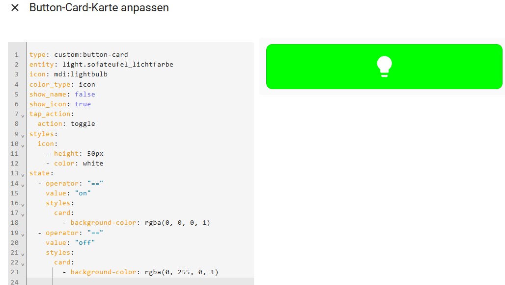

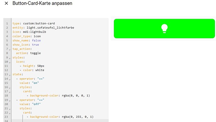

Mit der GitHub - custom-cards/button-card: ❇️ Lovelace button-card for home assistant kannst Du Icon, State, Background für alle Stati anpassen, also auch für on/off. Beispiele hatte ich mal hier und hier gepostet. Lies Dich ein und probiere.

              - show_name: false
                show_icon: true
                type: custom:mushroom-light-card
                entity: light.deckenventilator_lampe_rgb
                card_mod:
                  style:
                    mushroom-shape-icon$: |
                      .shape {
                        --shape-color: rgb(44, 44, 44) !important;
                icon_color: green
                tap_action:
                  action: perform-action
                  perform_action: light.turn_on
                    device_id: 50aed11bd3273c3da403094480bb15ff
                    rgb_color:
                      - 0
                      - 255
                      - 0
                secondary_info: none
                primary_info: none
                icon_type: icon
                icon: mdi:radiobox-marked
                use_light_color: false
                show_color_control: false
                icon_height: 50px
              - show_name: false
                show_icon: true
                icon_color: cyan
                tap_action:
                    rgb_color:
                      - 0
                      - 255
                      - 255
                primary_info: none
                icon_type: icon
                icon_height: 50px
              - show_name: false
                show_icon: true
                icon_color: blue
                tap_action:
                    rgb_color:
                      - 0
                      - 0
                      - 255
                primary_info: none
                icon_type: icon
                icon_height: 50px
              - show_name: false
                show_icon: true
                icon_color: purple
                tap_action:
                    rgb_color:
                      - 255
                      - 0
                      - 255
                primary_info: none
                icon_type: icon
                icon_height: 50px
              - type: custom:mushroom-light-card
                entity: light.deckenventilator_buro
                icon: mdi:weather-night
