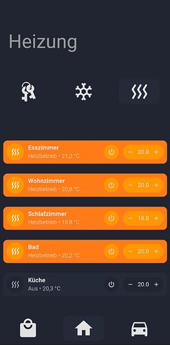

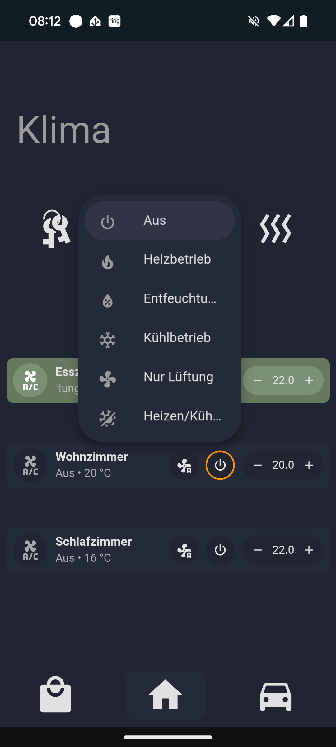

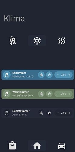

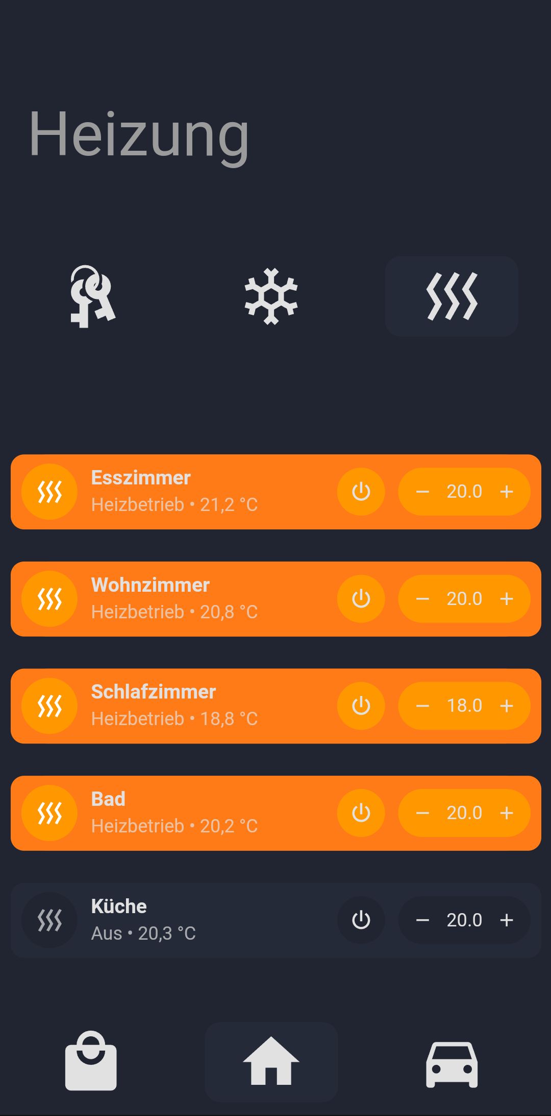

Bei mir ist auch das dropdown Menü angepasst
Falls du einen code willst schicke ich den noch
Bin gerade mobil unterwegs da ist Code kopieren echt ne Herausforderung :smiley:

Hier der Code (für eine Klimaanlage)
type: custom:bubble-card
card_type: climate
entity: climate.esszimmer
sub_button:
  - entity: climate.esszimmer
    select_attribute: fan_modes
    show_arrow: false
  - name: HVAC modes menu
    state_background: false
    show_arrow: false
    tap_action:
      action: toggle
    icon: mdi:power
    select_attribute: hvac_modes
    show_background: true
    show_icon: true
icon: mdi:air-conditioner
show_state: true
show_attribute: true
force_icon: false
state_color: true
card_layout: large
attribute: current_temperature
styles: |-
  .bubble-icon {
      color: ${state === 'on' ?  '#FFAF45' : '#ffffff'} !important;
  .bubble-icon-container {
      background: ${hass.states['climate.esszimmer'].state === 'heat' ? '#FF9E53' :
                  hass.states['climate.esszimmer'].state === 'cool' ? '#5293B4' :
                  hass.states['climate.esszimmer'].state === 'fan_only' ? '#7B9175' :
                  hass.states['climate.esszimmer'].state === 'off' ? '#212531' :
                  '#91AC8F'} !important;
  .bubble-climate {
      border-radius: 10px !important;
      background-color: ${hass.states['climate.esszimmer'].state === 'heat' ? '#ff7b18' :
                        hass.states['climate.esszimmer'].state === 'cool' ? '#3A6D8C' :
                        hass.states['climate.esszimmer'].state === 'fan_only' ? '#66785F' :
                        '#252a38'} !important;
  .bubble-sub-button-1 {
                  '#212531'} !important;
  .bubble-sub-button-2 {
  .bubble-temperature-container {
  ha-card {
    --bubble-select-list-background-color: #252a38 !important;
    --bubble-list-item-accent-color: #212538 !important;
tap_action:
  action: none
double_tap_action:
  action: none
hold_action:
  action: none
columns: 4
