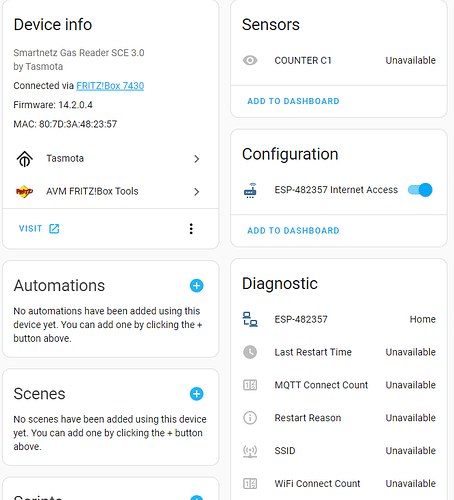

I’ve bought a Tasmota device to import our gas meter readings into HA, and I’m having troubles setting it up.
It gets autodiscovered in HA, but its sensor and all other attributes show up as unavailable immediately:
The contents of my configuration.yaml file:

The Tasmota device itself does read the gas meter correctly:
Can anyone help? Thanks in advance!
Found out I did not have the proper MQTT configuration in the Tasmota device. After I changed it to the following, I’m now receiving data in HA.
However, the counter sensor in HA does not show the right value. The displayed value should be divided by 100:
It displays as “171 m3” where it should be “1.71 m3”.
The template helper solves that for usage on the Energy dashboard, but it looks weird in the Tasmota integration.
Is there a way to fix that?

Never mind, I found it.
Since this is only a counter, I should’nt define it as a m3 gas sensor, Thus the issue was resolved when I removed the following from my customize.yaml:
