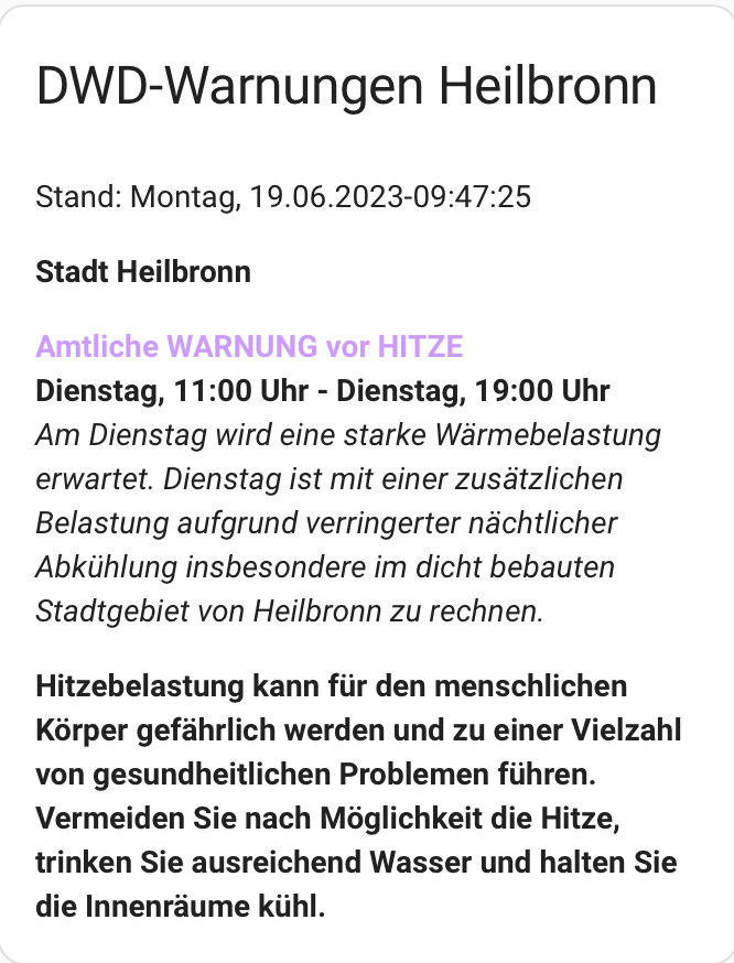

ich habe gerade die neue “Deutscher Wetterdienst (DWD) Weather Warnings” eingebaut. Leider sind die interessanten Info nicht als Sensor sondern nur Attribut vorhanden. Kennt jemand ggf. ein Markdown mit dem man die Infos ausgeben kann?
  - type: markdown
    title: WarnWetter (DWD)
    content: >
      {# Beginn: Letzte Aktualisierung #}
      {% set sensor_region_name ="dwd_weather_warnings_809276117" %}
      {% set current_last_update = state_attr("sensor." ~ sensor_region_name ~
      "_current_warning_level", "last_update") %} {% set weekday_last_update =
      as_timestamp(current_last_update) | timestamp_custom("%w", True) | int %}
      Stand: {{
      ['Montag','Dienstag','Mittwoch','Donnerstag','Freitag','Samstag','Sonntag'][weekday_last_update-1]
      ~ ", " ~ as_timestamp(current_last_update) |
      timestamp_custom('%d.%m.%Y-%H:%M:%S') }}
      {# Ende: Letzte Aktualisierung #}
      {# Beginn: 1. Region #}
      {% set current_region_name = state_attr("sensor." ~ sensor_region_name ~
      "_current_warning_level", "region_name") %} {% set current_count =
      state_attr("sensor." ~ sensor_region_name ~ "_current_warning_level",
      "warning_count") %} {% set advance_count = state_attr("sensor." ~
      sensor_region_name ~ "_advance_warning_level", "warning_count") %}
      ****{{ current_region_name }}****
      {% if ((current_count == 0 or current_count == None) and (advance_count ==
      0 or advance_count == None)) %} **<font color=#c5e566>Keine
      Warnungen</font>**{% else %}
        {% for i in range(current_count) %}
          {% set headline = state_attr("sensor." ~ sensor_region_name ~ "_current_warning_level", "warning_" ~ loop.index ~ "_headline") %}
          {% set description = state_attr("sensor." ~ sensor_region_name ~ "_current_warning_level", "warning_" ~ loop.index ~ "_description") %}
          {% set instruction = state_attr("sensor." ~ sensor_region_name ~ "_current_warning_level", "warning_" ~ loop.index ~ "_instruction") %}
          {% set level = state_attr("sensor." ~ sensor_region_name ~ "_current_warning_level", "warning_" ~ loop.index ~ "_level") %}
          {% set time_start = state_attr("sensor." ~ sensor_region_name ~ "_current_warning_level", "warning_" ~ loop.index ~ "_start") %}
          {% set weekday_start = as_timestamp(time_start) | timestamp_custom("%w", True) | int %}
          {% set time_end = state_attr("sensor." ~ sensor_region_name ~ "_current_warning_level", "warning_" ~ loop.index ~ "_end") %}
          {% set weekday_end = as_timestamp(time_end) | timestamp_custom("%w", True) | int %}
          {% set color = state_attr("sensor." ~ sensor_region_name ~ "_current_warning_level", "warning_" ~ loop.index ~ "_color") %}
        **<font color={{ color }}>{{ headline }}</font>**
        **{{ ['Montag','Dienstag','Mittwoch','Donnerstag','Freitag','Samstag','Sonntag'][weekday_start-1] ~ ", " ~ as_timestamp(time_start) | timestamp_custom('%H:%M') ~ " Uhr - " ~ ['Montag','Dienstag','Mittwoch','Donnerstag','Freitag','Samstag','Sonntag'][weekday_end-1] ~ ", " ~ as_timestamp(time_end) | timestamp_custom('%H:%M') ~ " Uhr" }}**
        *{{ description|trim }}*
        {% if (instruction|trim != "None") %}
        ****{{ instruction|trim }}****
        {% endif %}
        {% if not loop.last %}***{% endif %}
        {% endfor %}
        {% if ((current_count != 0) and (advance_count != 0)) %}***{% endif %}
        {% for i in range(advance_count) %}
          {% set headline = state_attr("sensor." ~ sensor_region_name ~ "_advance_warning_level", "warning_" ~ loop.index ~ "_headline") %}
          {% set description = state_attr("sensor." ~ sensor_region_name ~ "_advance_warning_level", "warning_" ~ loop.index ~ "_description") %}
          {% set instruction = state_attr("sensor." ~ sensor_region_name ~ "_advance_warning_level", "warning_" ~ loop.index ~ "_instruction") %}
          {% set level = state_attr("sensor.sensor." ~ sensor_region_name ~ "_advance_warning_level", "warning_" ~ loop.index ~ "_level") %}
          {% set time_start = state_attr("sensor." ~ sensor_region_name ~ "_advance_warning_level", "warning_" ~ loop.index ~ "_start") %}
          {% set time_end = state_attr("sensor." ~ sensor_region_name ~ "_advance_warning_level", "warning_" ~ loop.index ~ "_end") %}
          {% set color = state_attr("sensor." ~ sensor_region_name ~ "_advance_warning_level", "warning_" ~ loop.index ~ "_color") %}
        {% endif %}
        {% endfor %}
      {% endif %}
das Markdown verwende ich seit einiger Zeit dafür.
Gruss

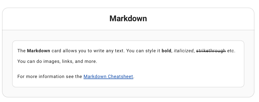

da ich völlig neu auf HA bin habe ich eine Frage .
Wenn ich DWD Warnwetter Dienst auf HA installieren will, wo kommt den da “Markdown”
hin?
das kann doch so nicht in config/yaml kopiert werden , oder wie geht das?
danke im voraus
Das ist eine Karte für Dein Dashboard.

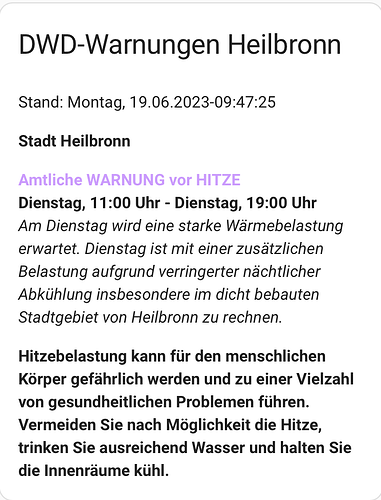

und mein Ergebnis sieht leide so aus
content: >
  Stand: Montag, 19.06.2023-21:58:54
  ****Kreis Lörrach****
    **<font color=#cc99ff>Amtliche WARNUNG vor HITZE</font>**
    **Montag, 11:00 Uhr - Dienstag, 19:00 Uhr**
    *Am Montag wird bis zu einer Höhe von 600m eine starke Wärmebelastung erwartet. Am Dienstag wird eine starke Wärmebelastung erwartet.*
    ****Hitzebelastung kann für den menschlichen Körper gefährlich werden und zu einer Vielzahl von gesundheitlichen Problemen führen. Vermeiden Sie nach Möglichkeit die Hitze, trinken Sie ausreichend Wasser und halten Sie die Innenräume kühl.****
Was habe ich falsch gemacht?
  {% endif %}
  {% endfor %}
  {% endif %}
  {% endfor %}
{% endif %}
