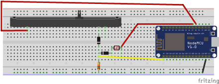

Mit esp8266 2 analoge Sensoren Messen
Hallo, ich würde gern sowas mit esphome machen. I dachte es mit einem script und mqtt tipo so was zu machen:
mqtt:
broker: !secret mqtt_broker
username: !secret mqtt_user
password: !secret mqtt_password
on_message:
- topic: ota_mode
payload: ‘ON’
then:
- logger.log: ‘Deep Sleep Disabled’
- script.execute: analogsensormessungen
- topic: ota_mode
payload: ‘OFF’
then:
- delay: 20s
- deep_sleep.enter: deep_sleep_enabled
captive_portal:
switch:
  • platform: gpio
    pin: D1
    name: “Power Plant sensor”
    restore_mode: ALWAYS_OFF
    internal: true
    setup_priority: 1000
  • platform: gpio
    pin: D2
    name: “Power Water sensor”
    restore_mode: ALWAYS_ON
    internal: true
sensor:
#***** DH22 sensor **********
  • platform: dht
    model: dht22
    pin: D4
    temperature:
    name: “ciof Temperature”
    humidity:
    name: “ciof Humidity”
    update_interval: 8s
#***** Wasserstand sensor ************
  • platform: adc
    pin: A0
    name: “wasserstand in volt”
update_interval: 3s
unit_of_measurement: 'V'
accuracy_decimals: 1
discovery: disable
  • platform: template
    unit_of_measurement: “%”
    discovery: disable
    filters:
    • calibrate_linear:
      0.1v = 0%
      1v = 100%
      • 0.42 → 10
      • 0.47 → 50
      • 0.50 → 90
      • 0.53 → 100
        icon: “mdi:water-percent”
        update_interval: 1s
        lambda: |-
        return id(wasserstandinvolt).state;
#PLANTSENSOR***
  • platform: adc
    pin: A0
update_interval: 8s
unit_of_measurement: '%'
filters:
  - multiply: 300
discovery: disable
script:
  • id: analogsensormessungen
    mode: queued
    then:
    • delay: 10s
    • switch.turn_on: spower2
    • delay: 2s
    • mqtt.publish:
      topic: thermoplant/waterlevel/state
      payload: “analogmessung1”
      #payload: !lambda |-
      return to_string(id(waterlevel).state);
    • mqtt.publish:
      topic: thermoplant/wasserstandinvolt/state
      payload: “analogmessung2”
      return to_string(id(wasserstandinvolt).state);
    • switch.turn_off: spower2
    • delay: 1s
    • switch.turn_on: spower1
    • delay: 2s
    • mqtt.publish:
      topic: thermoplant/plant/state
      payload: “analogmessung3”
      return to_string(id(plant).state);
    • switch.turn_off: spower1
deep_sleep:
sleep_duration: 1h
funktioniert aber nicht…
Eine Idee wie ich es eventuell anders lösen könnte?
Danke
lg
Christian
