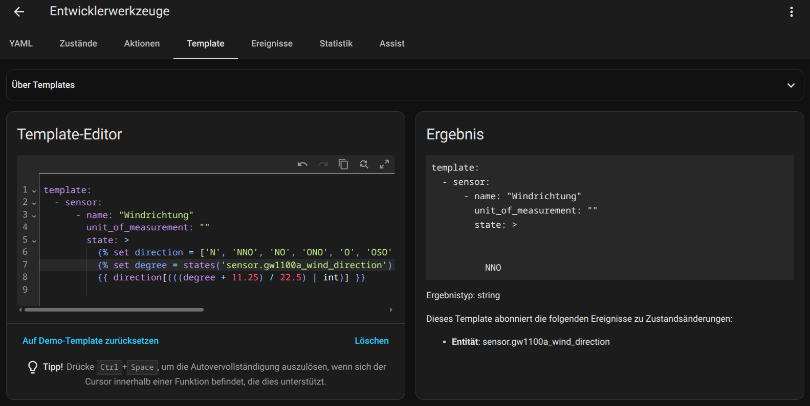

Ich habe auch mal getestet, funktioniert :smiley:
template:
  - sensor:
      - name: "Windrichtung"
        unit_of_measurement: ""
        state: >
          {% set direction = ['N', 'NNO', 'NO', 'ONO', 'O', 'OSO', 'SO', 'SSO', 'S', 'SSW', 'SW', 'WSW', 'W', 'WNW', 'NW', 'NNW', 'N'] %}
          {% set degree = states('sensor.gw1100a_wind_direction') | float(default=0) %}
          {{ direction[(((degree + 11.25) / 22.5) | int)] }}
