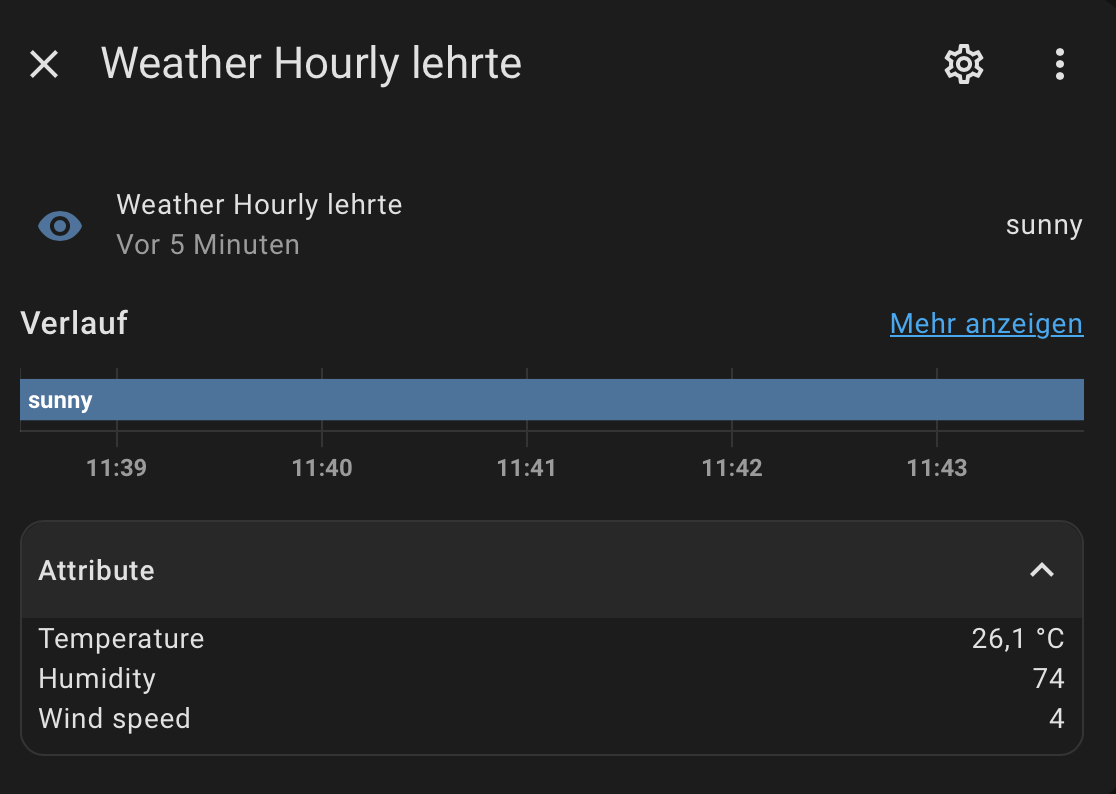

    sensor:
        - name: Weather Hourly lehrte
          state: "{{ hourly['weather.lehrte_sievershausen'].forecast[0].condition }}"
          unique_id: bb2d62c8-158c-4357-a52d-b4a9446ee50d
          attributes:
            temperature: "{{ hourly['weather.lehrte_sievershausen'].forecast[0].temperature }}"
            humidity: "{{ hourly['weather.lehrte_sievershausen'].forecast[0].humidity }}"
            wind_speed: "{{ hourly['weather.lehrte_sievershausen'].forecast[0].wind_speed }}"
