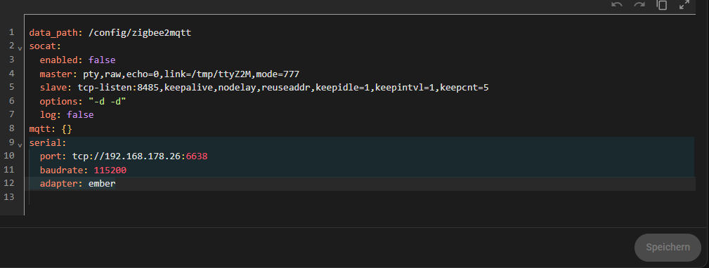

Ich habe den YAML code vom Stick verwendet, wie empfohlen.
serial:
port: tcp://192.168.178.26:6638
baudrate: 115200
adapter: ember
ZHA habe ich deaktiviert und HA neu gestartet.
Kann mir da jemand helfen?

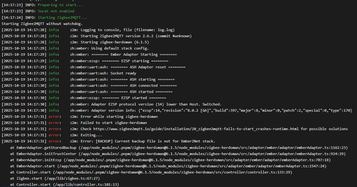

[2025-10-19 14:02:11] info: 	z2m: Logging to console, file (filename: log.log)
[2025-10-19 14:02:11] info: 	z2m: Starting Zigbee2MQTT version 2.6.2 (commit #unknown)
[2025-10-19 14:02:11] info: 	z2m: Starting zigbee-herdsman (6.1.5)
[2025-10-19 14:02:12] info: 	zh:ember: Using default stack config.
[2025-10-19 14:02:12] info: 	zh:ember: ======== Ember Adapter Starting ========
[2025-10-19 14:02:12] info: 	zh:ember:ezsp: ======== EZSP starting ========
[2025-10-19 14:02:12] info: 	zh:ember:uart:ash: ======== ASH Adapter reset ========
[2025-10-19 14:02:12] info: 	zh:ember:uart:ash: Socket ready
[2025-10-19 14:02:12] info: 	zh:ember:uart:ash: ======== ASH starting ========
[2025-10-19 14:02:14] info: 	zh:ember:uart:ash: ======== ASH connected ========
[2025-10-19 14:02:14] info: 	zh:ember:uart:ash: ======== ASH started ========
[2025-10-19 14:02:14] info: 	zh:ember:ezsp: ======== EZSP started ========
[2025-10-19 14:02:14] info: 	zh:ember: Adapter EZSP protocol version (14) lower than Host. Switched.
[2025-10-19 14:02:14] info: 	zh:ember: Adapter version info: {"ezsp":14,"revision":"8.0.2 [GA]","build":397,"major":8,"minor":0,"patch":2,"special":0,"type":170}
[2025-10-19 14:02:14] error: 	z2m: Error while starting zigbee-herdsman
[2025-10-19 14:02:14] error: 	z2m: Failed to start zigbee-herdsman
[2025-10-19 14:02:14] error: 	z2m: Check  for possible solutions
[2025-10-19 14:02:14] error: 	z2m: Exiting...
[2025-10-19 14:02:14] error: 	z2m: Error: [BACKUP] Current backup file is not for EmberZNet stack.
at EmberAdapter.getStoredBackup (/app/node_modules/.pnpm/zigbee-herdsman@6.1.5/node_modules/zigbee-herdsman/src/adapter/ember/adapter/emberAdapter.ts:1162:23)
at EmberAdapter.initTrustCenter (/app/node_modules/.pnpm/zigbee-herdsman@6.1.5/node_modules/zigbee-herdsman/src/adapter/ember/adapter/emberAdapter.ts:924:29)
at EmberAdapter.initEzsp (/app/node_modules/.pnpm/zigbee-herdsman@6.1.5/node_modules/zigbee-herdsman/src/adapter/ember/adapter/emberAdapter.ts:707:18)
at EmberAdapter.start (/app/node_modules/.pnpm/zigbee-herdsman@6.1.5/node_modules/zigbee-herdsman/src/adapter/ember/adapter/emberAdapter.ts:1547:24)
at Controller.start (/app/node_modules/.pnpm/zigbee-herdsman@6.1.5/node_modules/zigbee-herdsman/src/controller/controller.ts:133:29)
at Zigbee.start (/app/lib/zigbee.ts:67:27)
at Controller.start (/app/lib/controller.ts:101:13)
at start (/app/index.js:149:5)
Und muss noch dazu sagen das ich vorher einen Sonoff ZBDongle P verwendet habe, das ganze hat 2 Wochen Funktioniert.

Diese Konfi habe ich aus dem Gerät geholt
serial:
baudrate: 115200
adapter: ember
disable_led: false
advanced:
transmit_power: 20

Du solltest hier erst angeben um welchen SLZB-06 Modell es sich jetzt bei Dir genau handelt, denn wie Du ja jetzt weißt hängt davon auch die Konfiguration von Z2M ab. Wenn bei Dir im WebGUI des SLZB-06 unter Z2M and ZHA als Konfigurationsanleitung als adapter das steht
sprich ember, dann kannst Du keine SLZB-06 haben, sondern es muss ein anders Modell als der Serie sein. Vermutlich dann ja ein SLZB-06M. Wenn es das M-Modell sein sollte dann deutet diese Meldung
ggf. darauf hin das sich auf dem SLZB-06M noch eine ältere Firmware befindet, die Du ggf. erst updaten musst. D.h. Du solltest hier auch mal angeben welche Firmware-Versionen (Radio und Core) aktuell auf dem Dongel installiert sind.
Dann sieht man ggf. weiter. :slightly_smiling_face:
