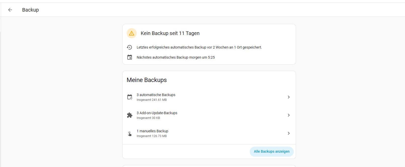

Backup nicht mehr vorhanden?

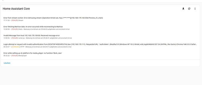

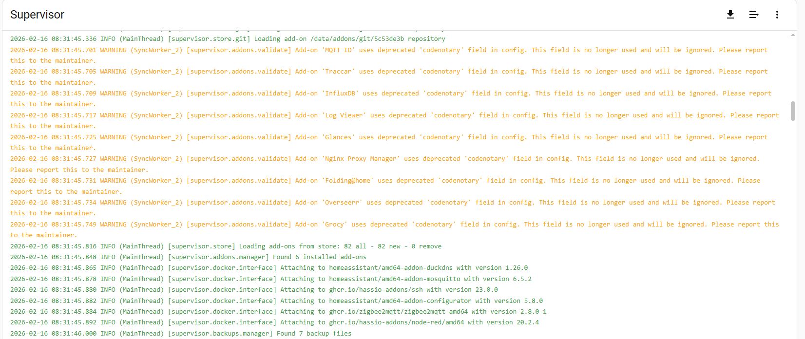

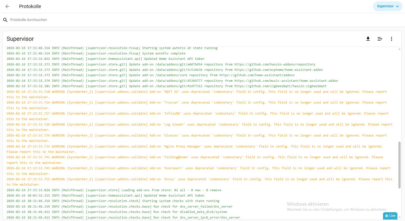

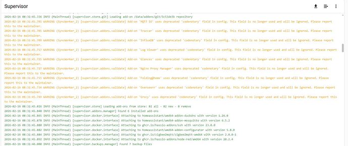

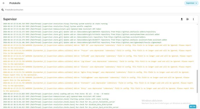

was bedeutet das hier?
2026-02-17 06:44:23.291 WARNING (SyncWorker_5) [supervisor.addons.validate] Add-on 'MQTT IO' uses deprecated 'codenotary' field in config. This field is no longer used and will be ignored. Please report this to the maintainer.
2026-02-17 06:44:23.296 WARNING (SyncWorker_5) [supervisor.addons.validate] Add-on 'Traccar' uses deprecated 'codenotary' field in config. This field is no longer used and will be ignored. Please report this to the maintainer.
2026-02-17 06:44:23.299 WARNING (SyncWorker_5) [supervisor.addons.validate] Add-on 'InfluxDB' uses deprecated 'codenotary' field in config. This field is no longer used and will be ignored. Please report this to the maintainer.
2026-02-17 06:44:23.310 WARNING (SyncWorker_5) [supervisor.addons.validate] Add-on 'Log Viewer' uses deprecated 'codenotary' field in config. This field is no longer used and will be ignored. Please report this to the maintainer.
2026-02-17 06:44:23.320 WARNING (SyncWorker_5) [supervisor.addons.validate] Add-on 'Glances' uses deprecated 'codenotary' field in config. This field is no longer used and will be ignored. Please report this to the maintainer.
2026-02-17 06:44:23.322 WARNING (SyncWorker_5) [supervisor.addons.validate] Add-on 'Nginx Proxy Manager' uses deprecated 'codenotary' field in config. This field is no longer used and will be ignored. Please report this to the maintainer.
2026-02-17 06:44:23.326 WARNING (SyncWorker_5) [supervisor.addons.validate] Add-on 'Folding@home' uses deprecated 'codenotary' field in config. This field is no longer used and will be ignored. Please report this to the maintainer.
2026-02-17 06:44:23.329 WARNING (SyncWorker_5) [supervisor.addons.validate] Add-on 'Overseerr' uses deprecated 'codenotary' field in config. This field is no longer used and will be ignored. Please report this to the maintainer.
2026-02-17 06:44:23.343 WARNING (SyncWorker_5) [supervisor.addons.validate] Add-on 'Grocy' uses deprecated 'codenotary' field in config. This field is no longer used and will be ignored. Please report this to the maintainer.

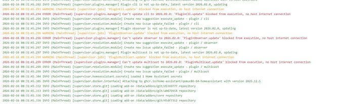

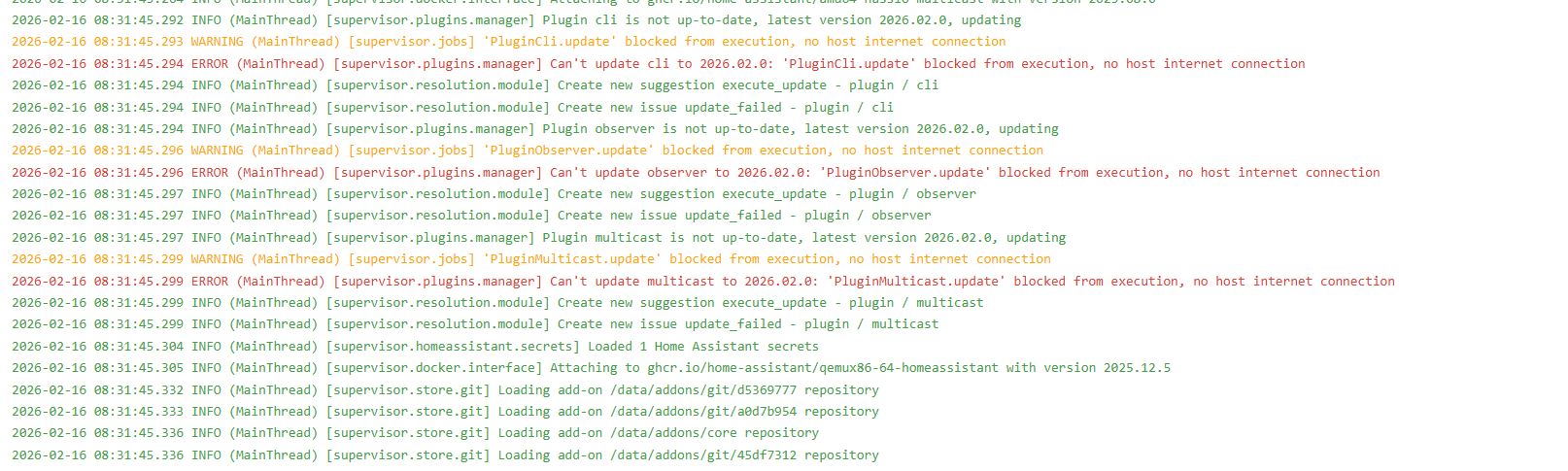

Also ich komm leider immer noch nicht weiter…
2026-02-19 12:30:58.981 ERROR (MainThread) [supervisor.docker.interface] Can't install ghcr.io/home-assistant/qemux86-64-homeassistant:2026.2.2: [500] Get "https://ghcr.io/v2/": dial tcp 140.82.121.33:443: connect: network is unreachable
Der Core 2026.2.2 lässt sich einfach nicht installieren. Der Supervisor u die anderen Sachen sind auf dem neusten Stand. Wenn ich im Terminal einen nslookup auf google mache geht das auch und auch ha resolution info ergab nichts Negatives. Hab die Maschine (VM) jetzt schon ein paar Mal neu gestartet.
Kann ich das Core Update manuell installieren?
Ich hatte mich hier ja mehr oder weniger schon ausgeklinkt, :slightly_smiling_face: aber zumindest das
kann ich Dir noch beantworten: Um es kurz zu machen: Das bedeutet für Dich nichts und das kannst Du kompl. ignorieren.
Zu Deiner aktuellen und ja bereits alten Frage kann ich Dir nichts Neues sagen, weil Du ja leider jetzt
wieder da bist wo Du vorher schon mal warst. Sprich wieder bei dem connect: network is unreachable Problem.

Übers Synology Forum bin ich aufmerksam gemacht worden, dass es im HA ja auch Netzwerk Einstellungen gibt. Da hab ich mal rein geschaut, und da ist als DNS die .10 hinterlegt, was mich sehr gewundert hat, weil normal ist ja in der FB die .1 und die ist auch bei mir in der FB hinterlegt.
Jetzt hab ich mal die .1 mit eingetragen bei IPv4 und habe auch noch mal die FB u die VM neu gestartet.
Hat nicht funktioniert, also hab ich geschaut, was ist denn bitte überhaupt die .10 bei mir, mein Netz is eig so klein dass ich die wichtigen IPs kenn und die .10 war mir nicht geläufig. Siehe da, das ist ein vor einigen Wochen im Außenbereich installierter TP-Link WLAN Router der als Hotspot dient.
Also ich raus, Stecker am TP-Link gezogen, noch mal alles neu gestartet und was sehen meine blutunterlaufenen Augen, das Update von HA läuft durch!!!
Ich fasse es nicht, da kann doch kein Mensch drauf kommen. Ich hatte aber auch die Installation des TP-Link nicht in kausalen Zusammenhang mit dem Updates gebracht, wie auch?! Wenn ich im Synology Forum nicht den Hinweis im HA mit Netzwerkeinstellungen bekommen hätte, wäre ich da jetzt immer noch nicht weiter.
