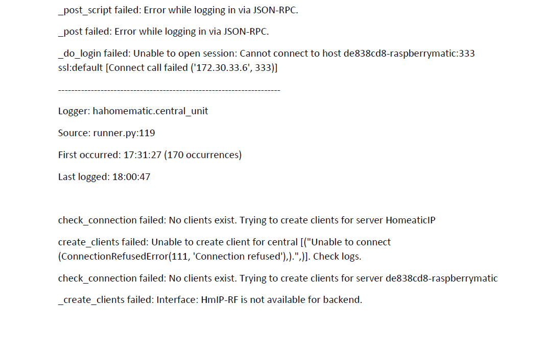

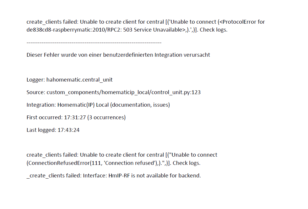

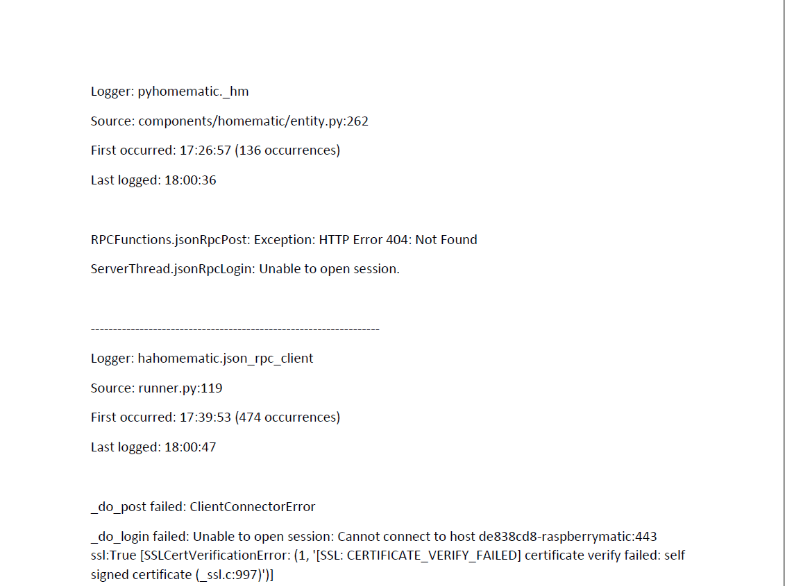

Es hat bis vorhin funktioniert. Nun bekomme ich, nach dem Update auf Operating System 9.4, die gleichen Fehlermeldungen wie früher😑.
Logger: hahomematic.central_unit Source: runner.py:120 First occurred: 11:11:00 (3874 occurrences) Last logged: 19:17:50
check_connection failed: No clients exist. Trying to create clients for server Raspberrymatic _create_clients failed: Interface: HmIP-RF is not available for backend. create_clients failed: Unable to create client for central [("Unable to connect (ConnectionRefusedError(111, 'Connection refused'),).",)]. Check logs. create_clients failed: Unable to create client for central [('Unable to connect (<ProtocolError for de838cd8-raspberrymatic:2010/RPC2: 503 Service Unavailable>,).',)]. Check logs.
Logger: hahomematic.json_rpc_client Source: runner.py:120 First occurred: 11:11:02 (11604 occurrences) Last logged: 19:17:50
_do_post failed: ClientConnectorError _do_login failed: Unable to open session: Cannot connect to host de838cd8-raspberrymatic:443 ssl:True [SSLCertVerificationError: (1, '[SSL: CERTIFICATE_VERIFY_FAILED] certificate verify failed: self signed certificate (_ssl.c:997)')] _post_script failed: Error while logging in via JSON-RPC. _post failed: Error while logging in via JSON-RPC.
